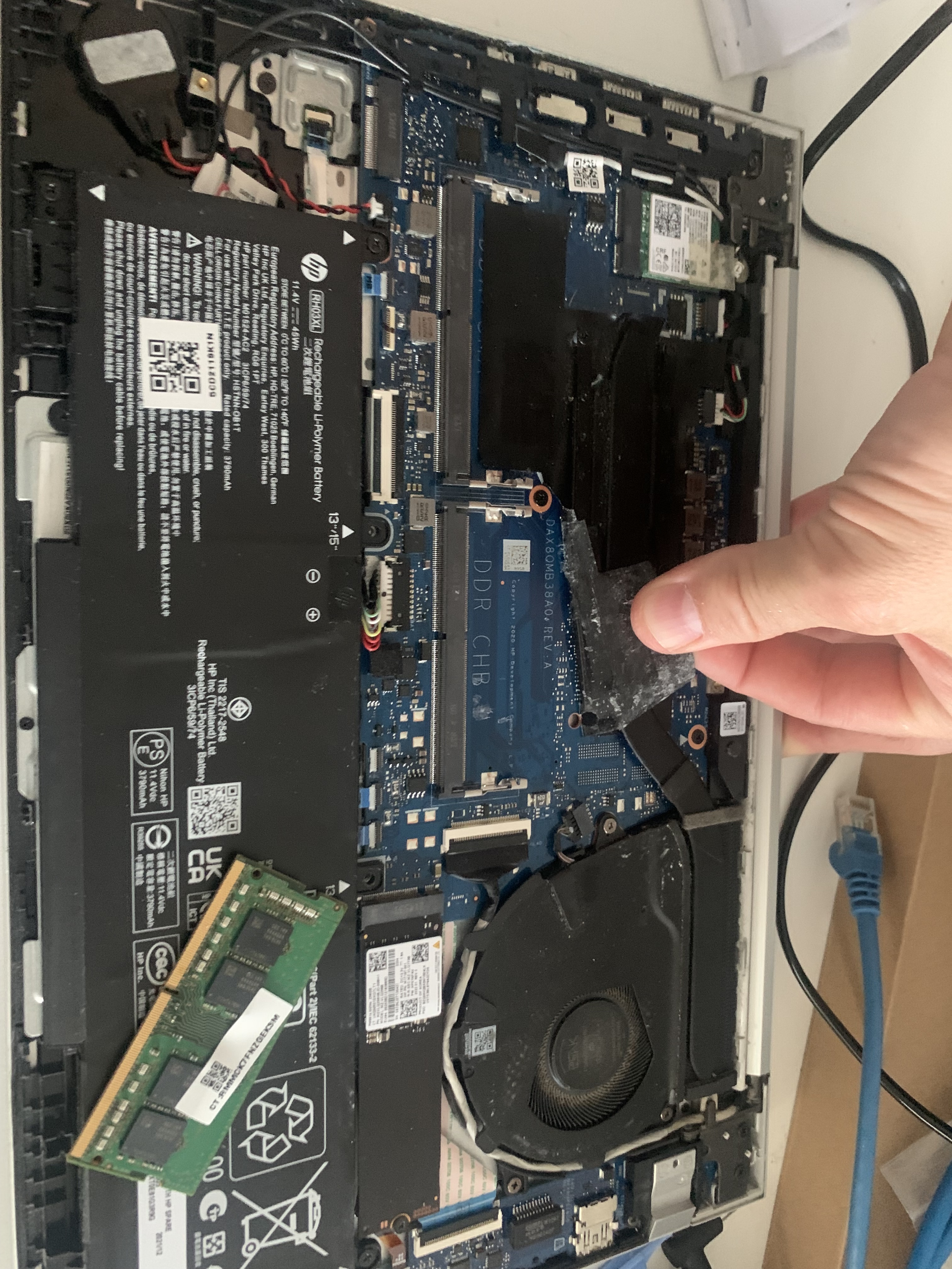

    Hi folks.
    I have a 640 which doesn’t charge using the barrel connector, only via USB. Internal voltage rails only go up to 12V, they rise to 19.5 with the USB C.
    Can Anyone who has the schematic lend a hand? I can read them fine so just a link would be great, but also any insight if you’ve seen this before.
    Also, is there a list connecting the HP series model
    numbers to the COMPAL model numbers?
    thanks
    dan

      Post the motherboard model number.

      1.1.3 Motherboard model number

        Before now, Never did I ever know there was a model number that wasn’t 640 G8!
        I think 43A58EA#ABU looks like the number?

          Not the laptop model number, the motherboard model number. Should be DA0X8QMB8E0 or something similar

            #embarrassing
            DAX8QMB38A0 RevA
            (photo attached for other noobs who find this thread.)

                  Thank you very much. Sorry about the delayed response in doing so. Seeing as it’s a power supply issue, I’m pretty convinced that the schematics will be pretty identical at that stage in the circuit. I’ve had a little read through and it seems that my problem with the barrel connector only spitting out 12 V could be well down to some of the P type fets or a zener gone wrong. Either way, the circuit gives me a great hint as to how the USB and barrel connectors work together.
                  Really appreciate it, thanks mate
