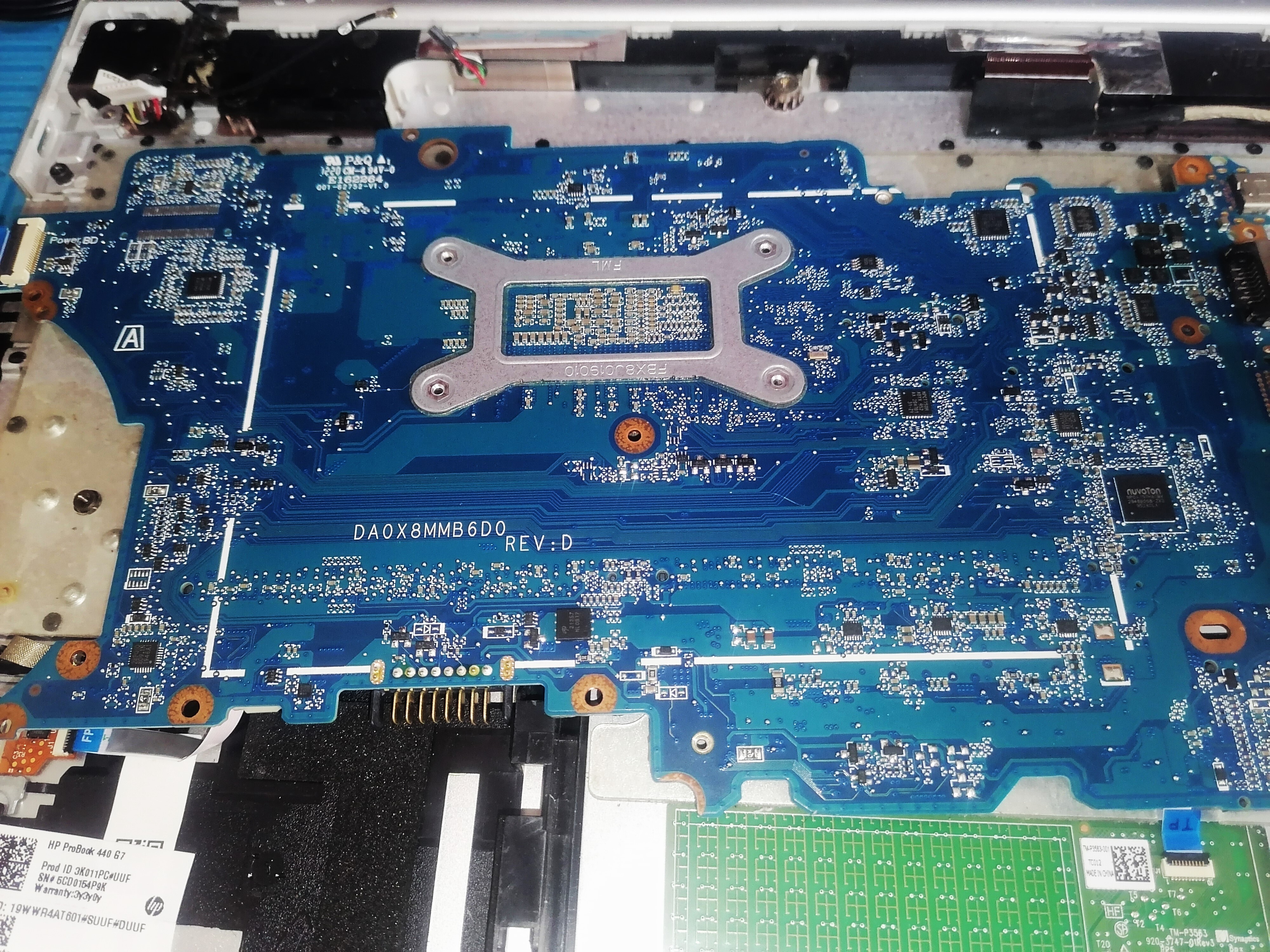

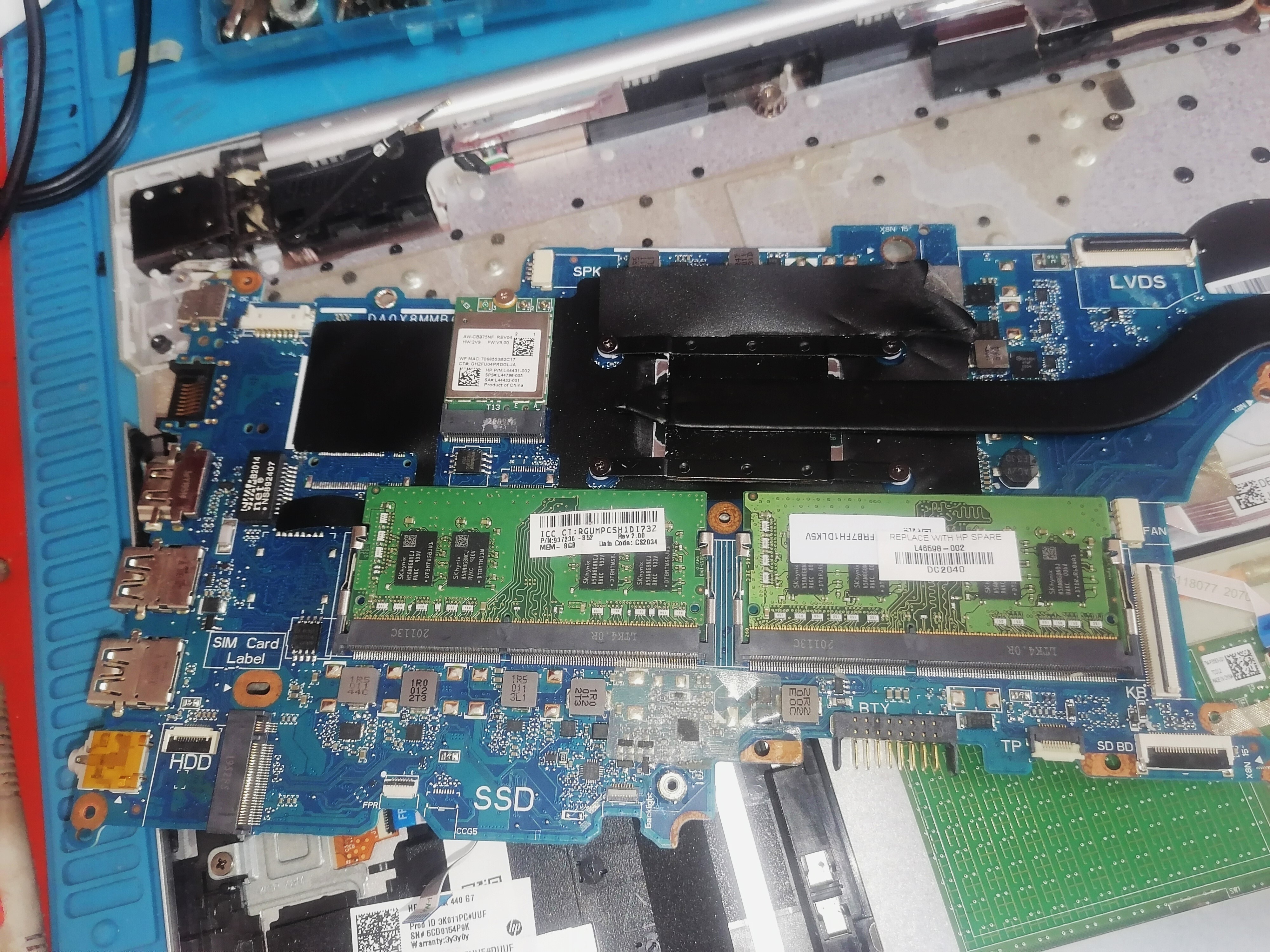

    Hi everyone:
    I desperately need the schematic for the DA0X8MM6D0 REV. D MoBo.
    It is an HP 450 G7 laptop. In the MoBo you can also read MODEL: X8M-6L.
    Thanks in advance!.

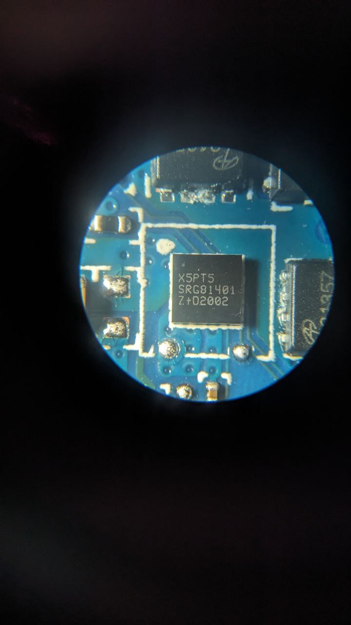

                pu9600, pu9601 what kind of microcircuit is it?
                Thank you...

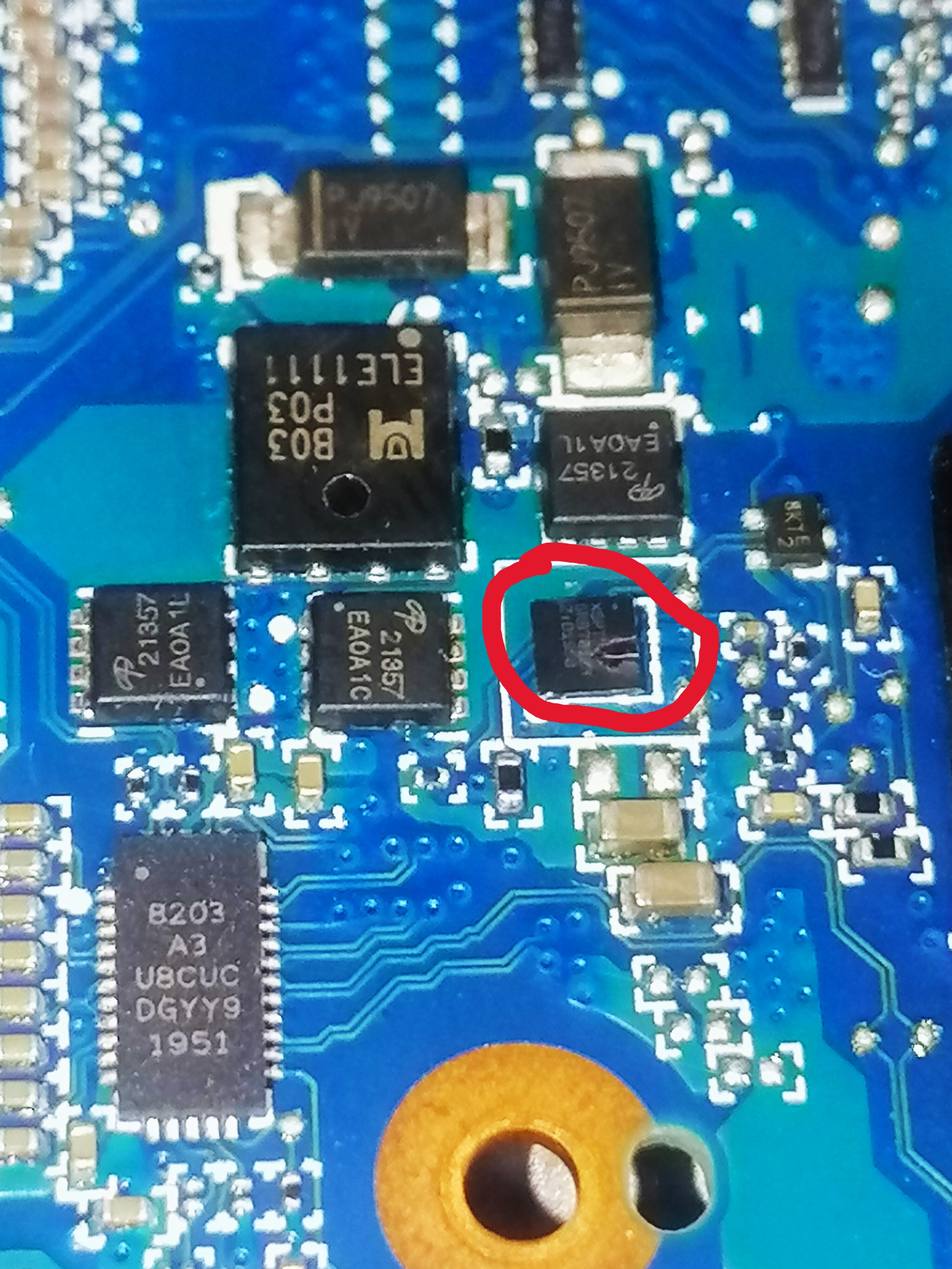

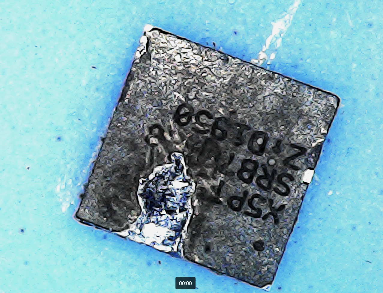

                  Originally posted by alas3376
                  Re: DA0X8MM6D0 REV. D schematic needed
                  here is boardview
                  schematic please or at least help me identify this TYPEC IC controller it doesn't have part number coz its burnt shorted. its also doesn't have details in boardview.
                  after i removed the IC short is gone but it doesn't boot 3.3V,5V and 1.2v are present standby after i removed the IC shorted.
                  or maybe someone here know how to bypass this IC without replacing this coz i use the 19v adapter instead of type c.
                  just to work with normal adapter i wont use the typec.

                  • Jamescameron696969
                    • Nov 2023
                    • 27
                    • indonesia
                    i also found this datasheet it looks simmilar is this okay to replace?

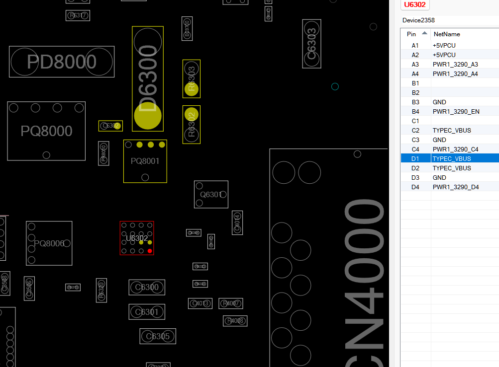

                                  here is boardview
                                  what is U6302?
