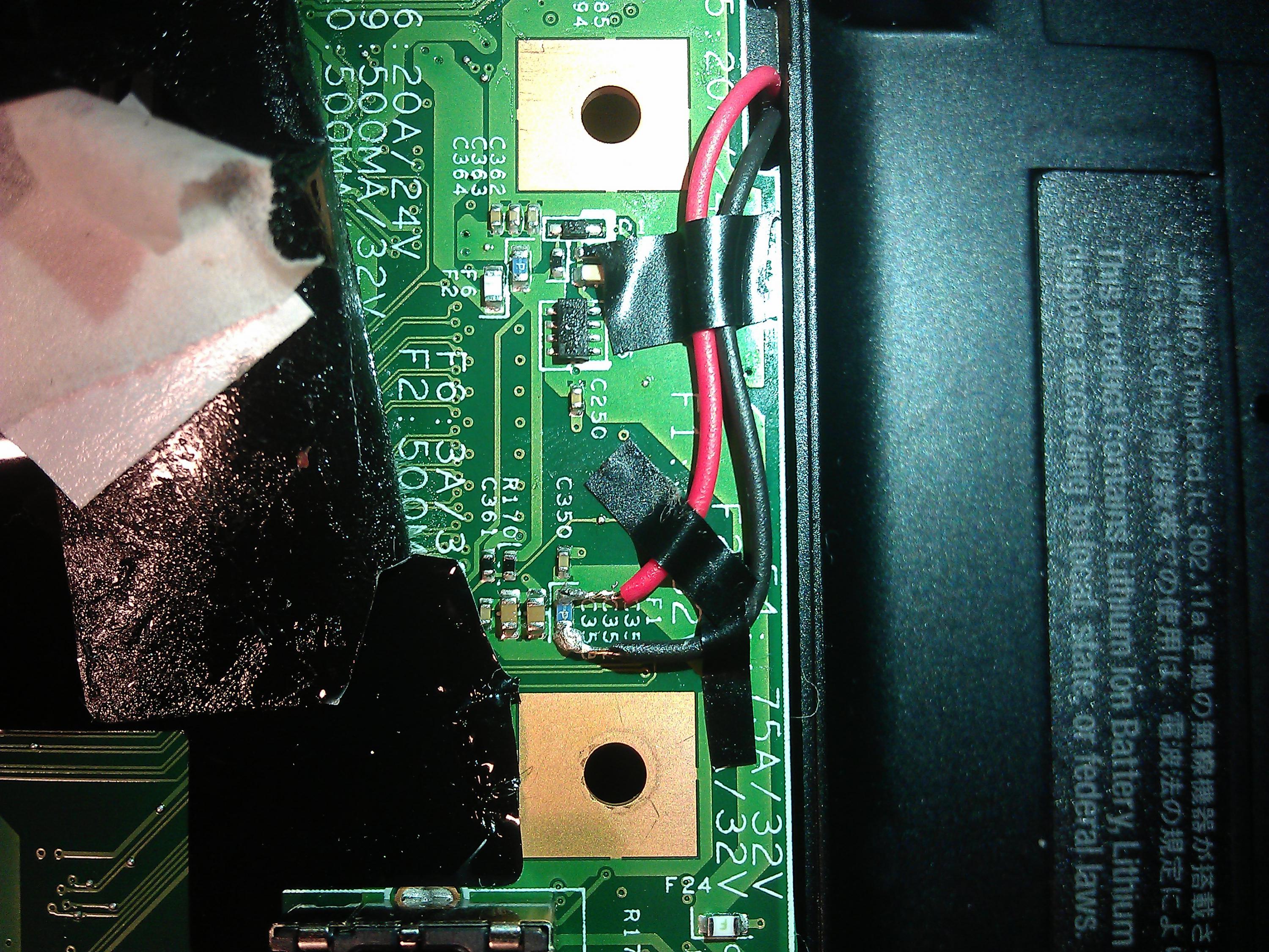

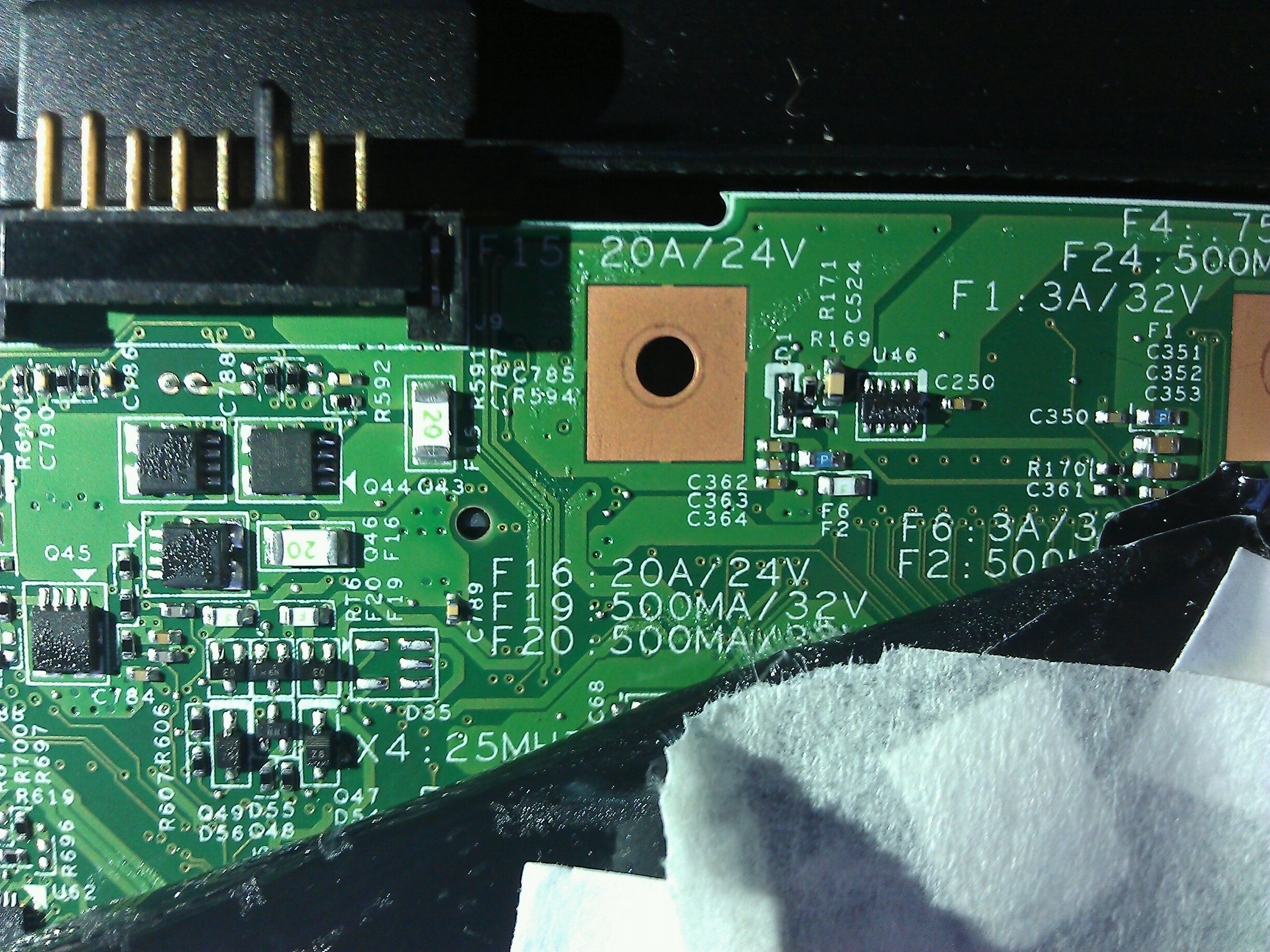

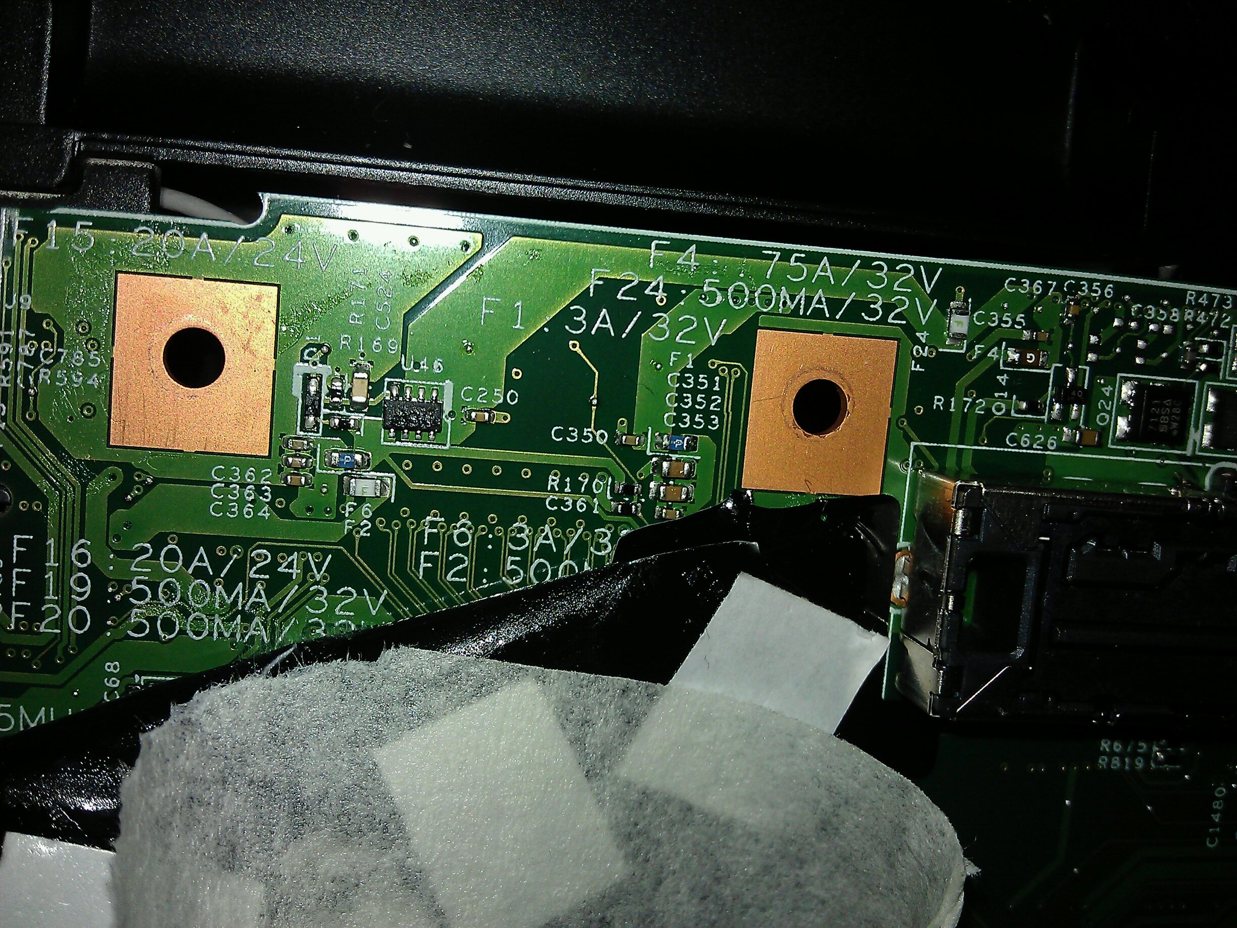

    Attached to my post is the pdf schematic , on page 30 there is the motherboard 40 pin lcd connector and its components. What I understand is the fuse F6 carries a 3vcc power and is the one in charge of switching backlight on or off, F2 is for the lcd itself and the one marked as F1 carries the main 20vcc power for the backlight led. After testing continuity with a multimeter F1 is open, and it also seems to have a slightly different voltage when tested between its sides and sides with motherboard ground, also I may be doing something wrong because I cant read its ohms, it just marks 1 on all scales. F6 and F2 have continuity and zero volts across them. That means F1 is bad right? I read voltage should be zero across them.
    Now, Ive been looking for someone that sells smd components and fuses, and failed because I cant find someone who provides these without importing and consequently waiting up to a month and I have no credit card anyway, I havent had luck with local repairshops either because they want to charge me what a new computer would cost and the so called motherboard component level repairshops would just put a solder blob over it, something that may work but in that case why pay if I can do that too

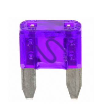

    My questions are: am I correct in assuming its simply the fuse whats wrong? Do you guys think I should test further to for example see if the 20V are actually provided right before the fuse? Or maybe check the whole lvds cable and make sure it has continuity and no shorts. Im a little afraid of breaking something else if I have to do tests with power on and battery. And, considering I cant find an exact smd replacement, can I use instead one of those little car fuses? I'd solder two little wires to it and then solder it on top of the old fuse, I can find them with the same specification of 3A 32V, is this a good idea? Are glass fuses acceptable too? And does anyone know if those are fast or slow acting and if that matters? I know this sounds like a really cheap and dirty fix, but money's short and thats better than simply bridging. Unless I can trick Lenovo into fixing it for free because the computer still has almost 2 years left of warranty.

    When you are saying voltage across fuse - that is not a test.
    Tests are 1. power off, meter on ohms200.- probe to each side of fuse should be the same as touching the probes together.
    2. power on test each side of fuse to a nearby chassis ground.

      Ok so I tested the ohms again and it keeps showing 1 from 200ohms to 20M, multimeter manual says it'll show 1 when the measurement is above the rank, I guess this is whats happening and the fuse ohms are greater than 20M ohms. When testing other fuses the reading is the same as when touching the probes together (0.04). On the second test what should I be trying to measure? ohms or volts and am I grounding to the motherboard ground or the laptop chasis?

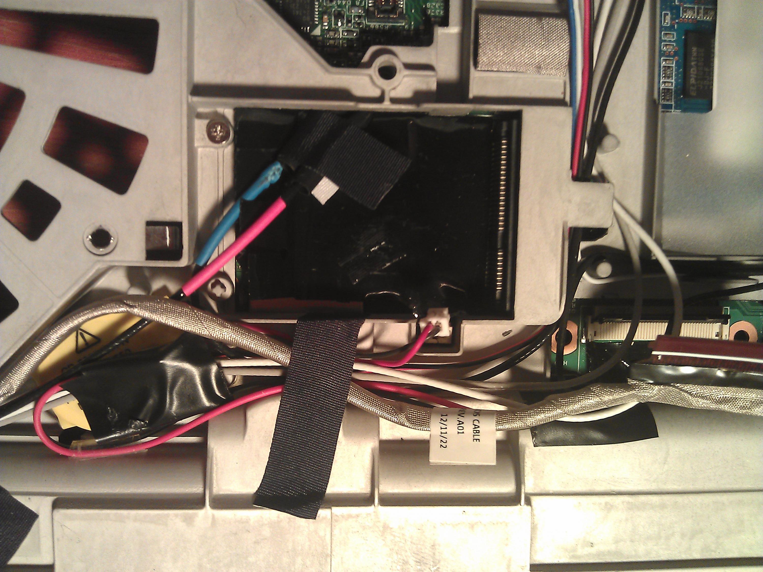

          Ok so I got it back and running. Just one question I hope someone can clear out, when I first turned it on (on battery) after complete dissasembly including the backup battery I saw it "try" to turn on 3 consecutive times (power button lighted and died 3 times), then it showed the bad cmos checksum. After setting time and all that it boots normally at first try like before.
          Is it normal that it tried to boot up and failed or was it doing some kind of general checking? I had it dissasembled for 3 days without cmos battery and pressed the on button many times before without power to make sure it drained all circuits. Also if it matters the fuse is now wired up on the other side and is sitting on top of the cmos battery. My guess is the caps didnt have enough power and thus it didnt boot straight tue first time but I want to know your opinion guys.
