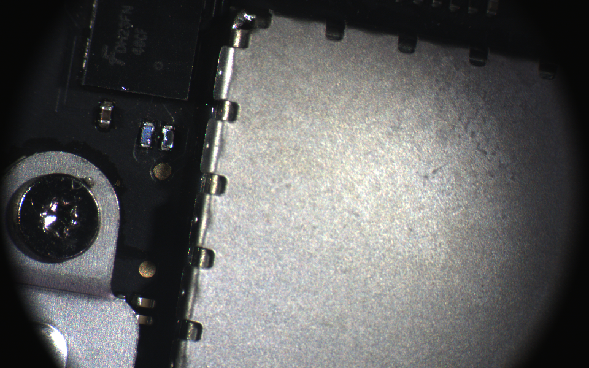

    A1707 820-00928 A Boardview error should be corrected modified.
    I came across a board view claiming to be the 820-00928 board, I haven't scoured through it to compare everything to the 820-00281 board view but I'm assuming they are identical and the prior is just renamed?
    Either a came across a very rare version of an A1707 with the 820-00928 A board or there is an error/ erroneous assumption on the board view.
    Specifically DZ3301 and 3302 are not in the same location shown on either board views, arranged differently in a position above the board view layout as shown in the attached photo.
    Since these diodes are incredibly hard to see clearly with the naked eye, and require proper illumination to see the blue metallic hue it would be great to update the 820-00928 boardviews floating around or make a note that one will not find those diodes between the two test points like illustrated in the existing board views.
    Hopefully that'll save other people more time and aggravation.
    Cheers!
  • piernov
    • Jan 2016
    • 4435
    • France
    https://logi.wiki/index.php/Schemati...in_Logic_Board
    Boardview file is not publicly available for 820-00928, some differences in USB-C area compared to 820-00281 at least, scammers rename other files as usual.
