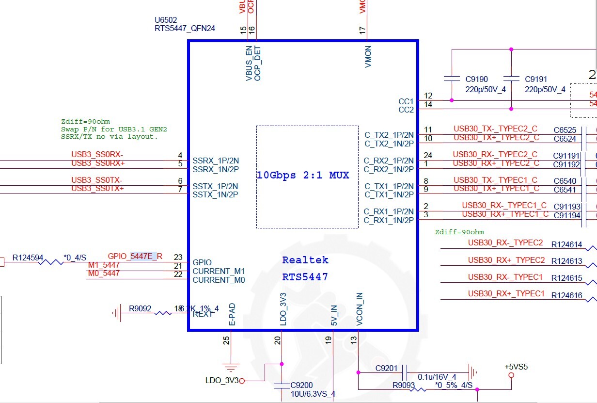

    I'm working with two logic cards from similar computers "01-DG7BFM8D0 rev: D" and 02-DG7BJMB8C0 rev: C" the first one comes with a RTS5447 IC and the second one has the REALTEK 5447E IC, apparently similar, but not quite. On the first card I made several repairs because the computer wouldn't turn on at all, The AON 6936 mosfets were short, replaced and missing resistors and a few capacitors, of which the second one helped me a lot. The details are that now the first equipment already turns on with very low consumption of 0.10A ampere when the RTS5447 is installed, this is short, when I change this IC for the REALTEK 5447E the equipment turns on with a consumption of 0.04A, I do not have the data sheet of the REALTEK 5447E, I only have the diagram of a similar computer the data sheet of the RTS5447 can someone provide me the data sheet of this REALTEK 5447E?
