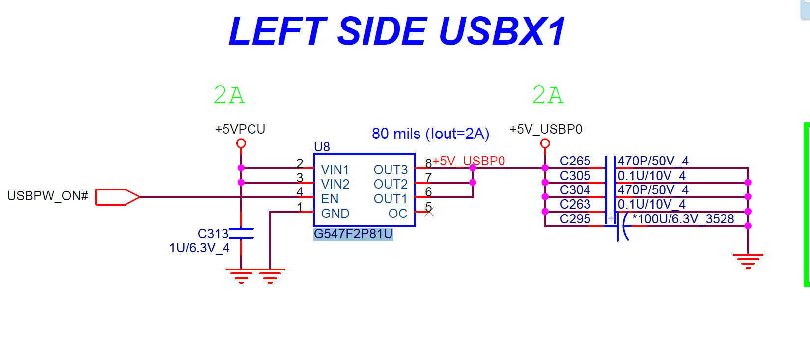

              Originally posted by The_Boss
              Would be nice to find one.
              Theres a 8 pin SMD IC marked M113 near USB ports that I need to replace. The problem is - I have no idea what exactly is it so I can´t search it.
              PD14, is at the very beginning of the DC input, so if there is a short, and pd14 is not the problem, then check PC142, PC151 and +VAD line.
              I can´t find M113, can you say the number of the IC?

                Re: daax3mb16a1 rev:a DDR2 version schematic needed.
                Thanks bu they all seem fine, there is no ic marked m113 there only 8 pin is U8 which is G547F2P81U.
                • RethoricalCheese
                  • Mar 2013
                  • 1517
                  • Estonia
                  Yes, my IC was so burnt, I did not see G547F2 written there. But I fixed my problem some days ago.
