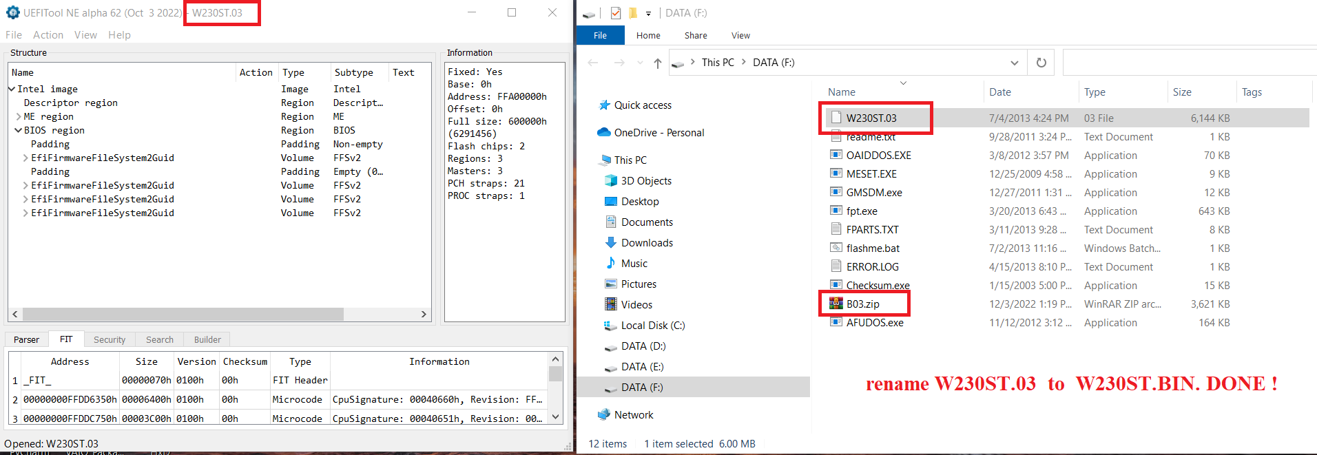

    Hi, I need please bios BIN file
    The Main Board is: 6-71-W2300-D03
    Thanks!

      thank you peste
      I downloaded the bios zip file but not a BIN file
      how to convert to bin file?

        See the pictures !

          thank you sir for the response
          the file is 6mb and the bios chip is 4mb and 2mb

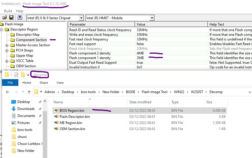

                  Re: 6-71-W2300-D03 bios file (clevo w230st)
                  We cann find out how the file should be split with Intel Flash Image Tool . Find the ME firmware version first using ME Analyzer,then we know which version of FIT to use to open the 6MB bios with. This has version 9 ME firmware so we use FIT from "ME System Tools v9.1 " .Open the bios with FIT,look in the Decomp folder and open "BIOS Region.bin" with a hex editor. Comparing it with your backups you should see that the bios region is the 4MB.The bios region (2nd part) is always after the 1st part.The file wants splitting into 2MB and 4MB .Close FIT ,open with a hex editor and split - https://www.badcaps.net/forum/showpo...60&postcount=4
                  Another way you can split the file is to clean the already cleaned ME firmware,after building the image it will be automatically split into 2 and 4MB.
                  HxD hex editor https://mh-nexus.de/en/downloads.php?product=HxD20
                  ME System tools https://www.badcaps.net/forum/showthread.php?t=88533
