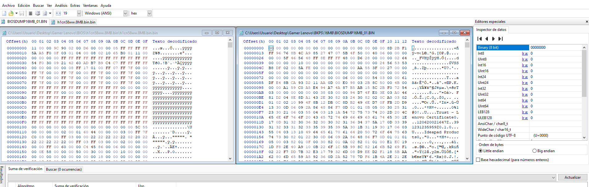

                          the bios from post #6 is virgin, use the HxD program (it's free on the internet), enter both bios into the program (your laptop and the virgin one),
                          select that interval mentioned in both bios, copy the interval in your bios and pass it to the virgin bios (copy - paste)....and that's it...

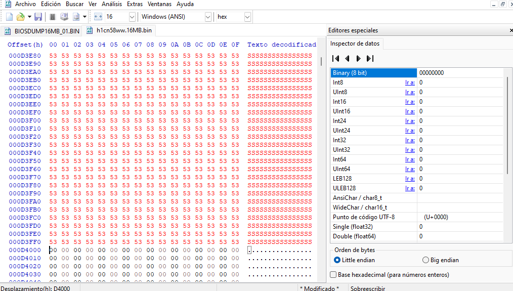

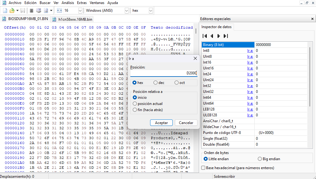

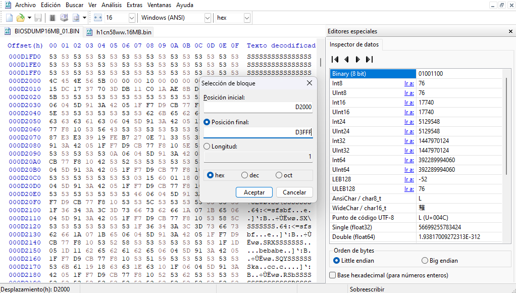

                                This is for the 16MB file
                                On HxD, Find -> Go to... (Ctrl-G), enter D2000
                                Edit -> Select block (Ctrl-E), initial position D2000, end position D3FFF
                                Copy (Ctrl-C), and switch to the "virgin" BIOS

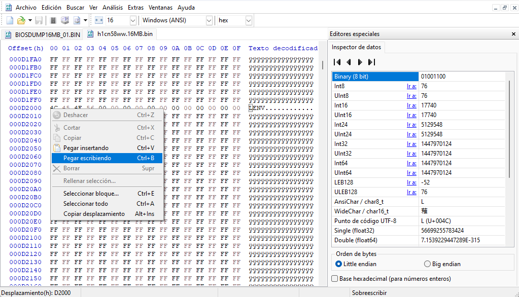

                                Go to (Ctrl-G) D2000
                                Right click on the starting position at D2000 (column 0), paste overwrite (Ctrl-B)
                                Save as a new file

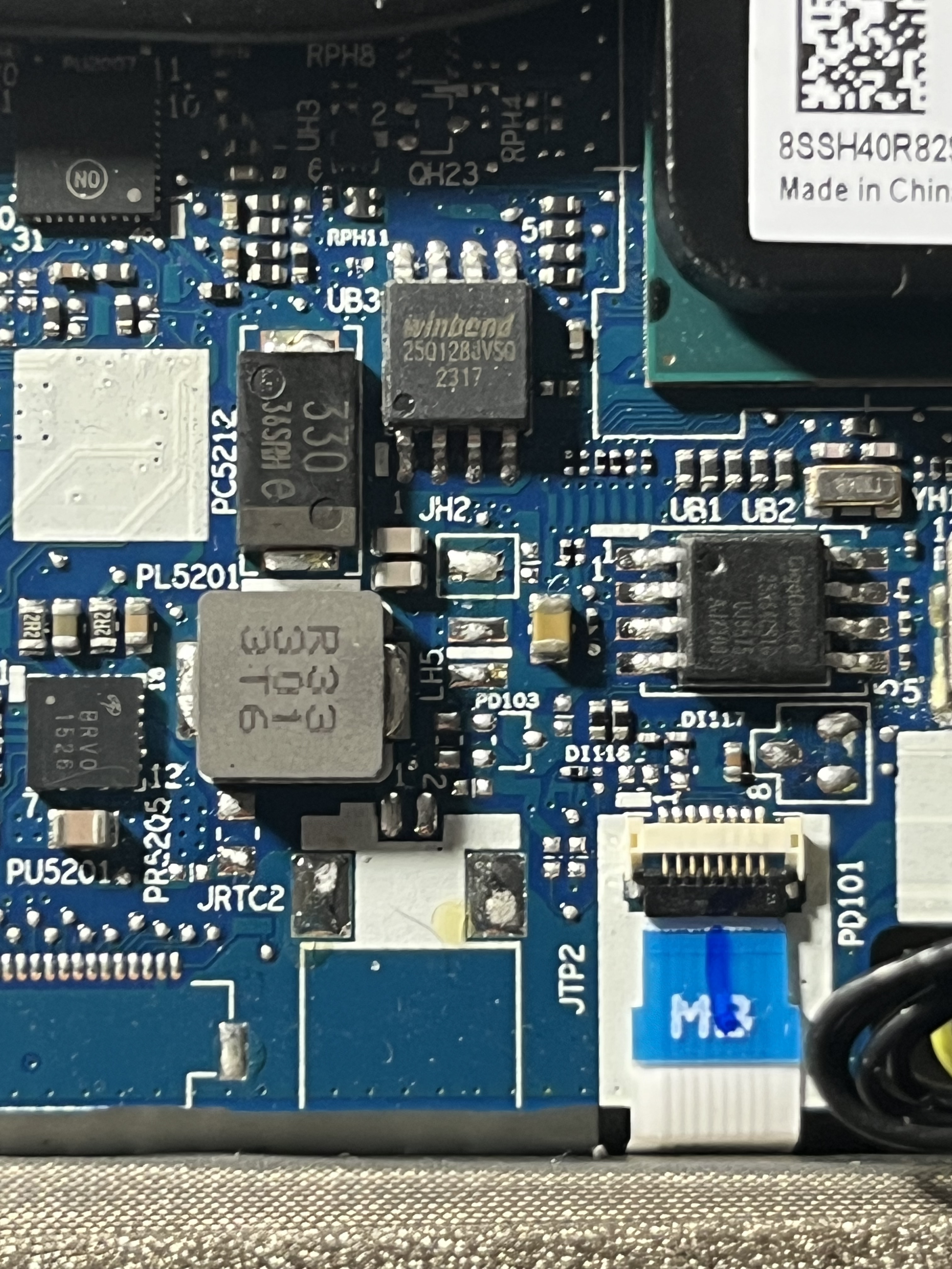

                                    Today take a picture, one is 16 and other 8, please can you mark if is possible?
                                    • m1ch43lzm
                                      • Mar 2019
                                      • 976
                                      • Peru
                                      Originally posted by monsedisq
                                      Thanks so much, i write from my cell, is late in Chile, but tomorrow early test the files. Thanks brother!
                                      UB3 is the 16MB (Winbond 25Q128JVSQ), the backup you uploaded is this one
                                      The 8MB is UB1 UB2 (GigaDevice 25R64CSIG), also make a backup from this one before flashing
                                      8MB contains the Intel ME region, use the file from post 6
