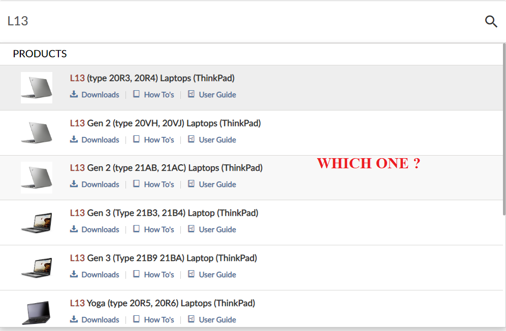

            Gen 2 Type : 20VH

                Gen 2 Type : 20VH
                L13 Gen 2 (type 20VH, 20VJ) Laptops (ThinkPad)
                  same problem
                  SN : R9-10RLGY
