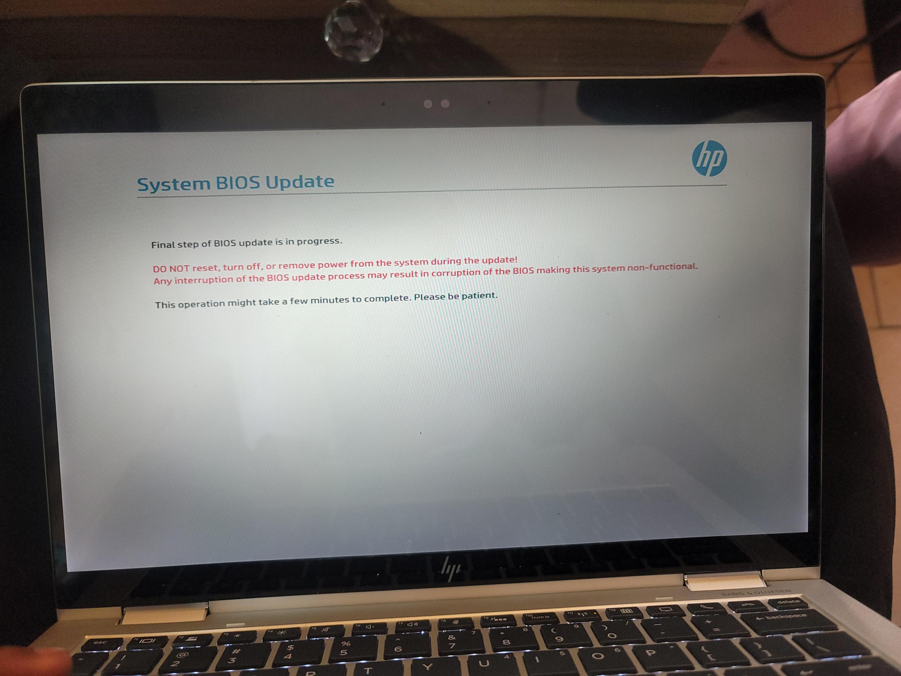

    Long story short - BIOS update from Windows Update went sideways
    Notebook is turning on, but it has a "bios update loop". I`ve tried bios crisis/recovery/repair magic tricks (Win+B, Win+V, USB recovery disk etc) nothing helped.
    So, i need clean dump, without passwords to reprogram my eeprom again. Can somebody help me?

    Post your corrupt bios file here.

      Here you go

        Here's your new file, try it and give me the results.

          Thank you, but it didn't help. Actually quite opposite, because now i have no video signal, batttery LED blinks very fast and Caps Lock LED is on

            HP EliteBook x360 1030 G3 Notebook PC latest bios

              Unfortunately still no luck - Caps Lock blinks 7 times. AFAIK, this means that Sure Start is unable to find valid BIOS Boot Block image.

                      What is your programming hardware and software?
                      In my case, fault was on Asprogrammer.
                      After writing bin file, delivered by hoaca388 with Neoprogrammer, my notebook started to work and everything is fine.
                      Thank you hoaca388 for your help. I owe you a big cup of coffe or glass of beer.
