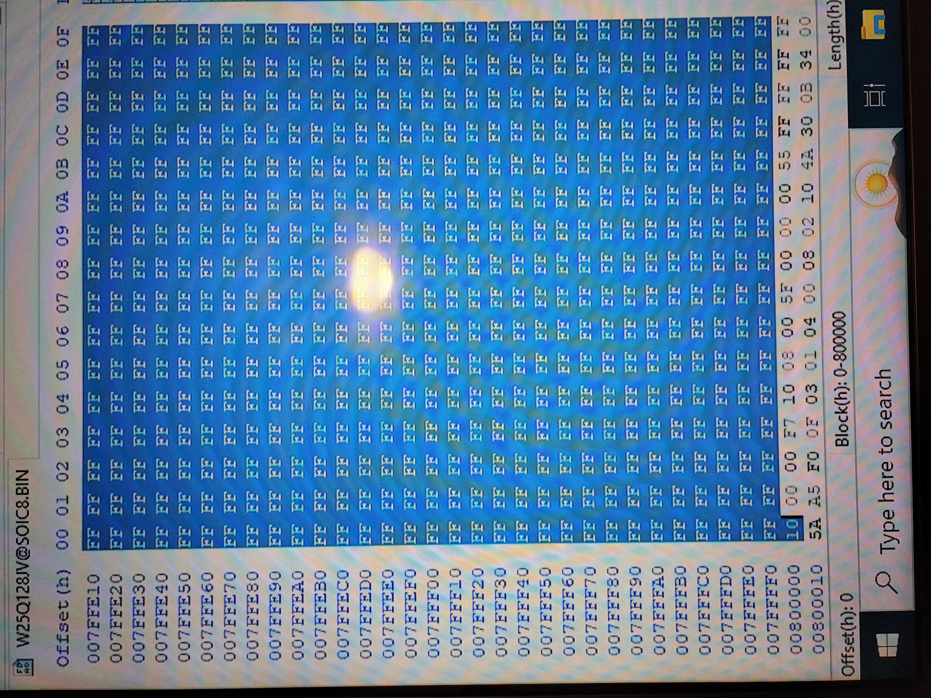

              Re: Need to shrink a 128 MB BIN to 64mb
              Originally posted by TheWizard
              Sure thing. My buddy attempted to flash his BIOS on his Dell Inspiron 3593. The problem is he didnt have a power adapter connected at the time and his battery went dead in the middle of flash. He backed up the chips but used 128MB selection for the XMC chip. The other BIOS chip is all set. I was able to buy a new chip and flash that chip with the original BIN. Can you think of a way to shrink the BIN i uploaded to fit on a 64MB chip while at the same time keeping the data intact? I am not great with Hex Editors. Only familiar with HxD.
              You can open the file with HxD and select block from 0h to 800000h, that will be the half (8MB). If you select from 800000h to the end, it will be the same.

                Re: Need to shrink a 128 MB BIN to 64mb.Inspiron 3593
                Like this? Then you just delete the F's? I will flash the chip with the BIN you modified for me and provide an update. Thank you hardware1. Much appreciated!

                  • 22279
                  If you`re starting from 0 No, the length in hex should be 800000 , 0 - 7FFFFF .Why is that ? ,because the counting starts from 0 and not 1
                  If you were selecting the bottom 8MB of the 16MB it would start at 800000 and end at FFFFFF

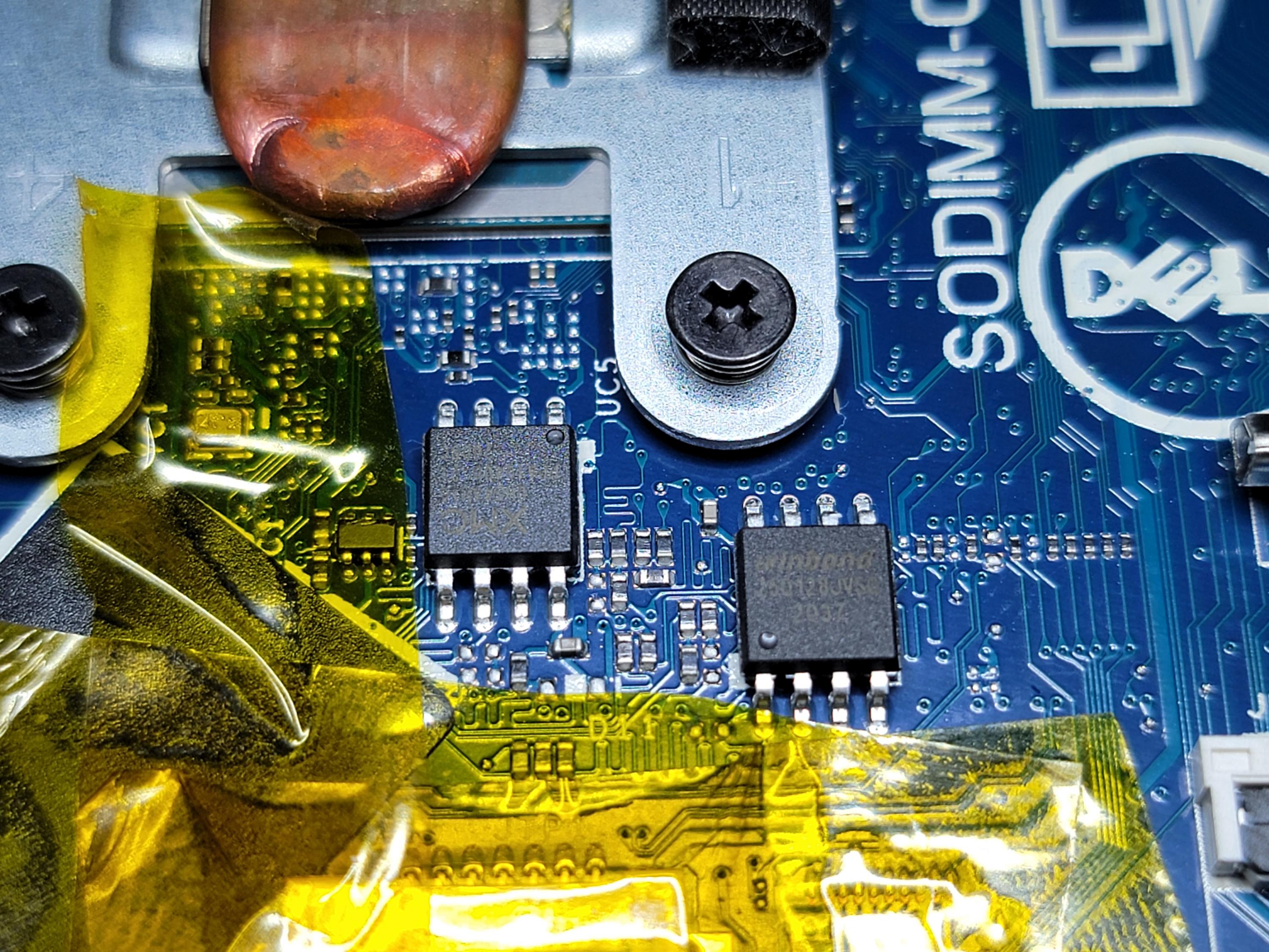

                      Okay i surface mount soldered the chip back, reassembled and now i have no power, no lights, no fan. Before the change, I had power and could boot to BIOS and Windows. Now nothing. The reason for flashing the XMC chip is to correct the Serial number. Could the deletion and downsizing messed with the prompt to boot? I have 19 volts coming in from the charger to the dc in. And 3.3 v going to the chip replaced. But after taking readings on the XMC chip, i switch to the Winbond and get 0v. Has to be the chips not talking to one another. Here is a pic of the solder work. Anything else we can try?

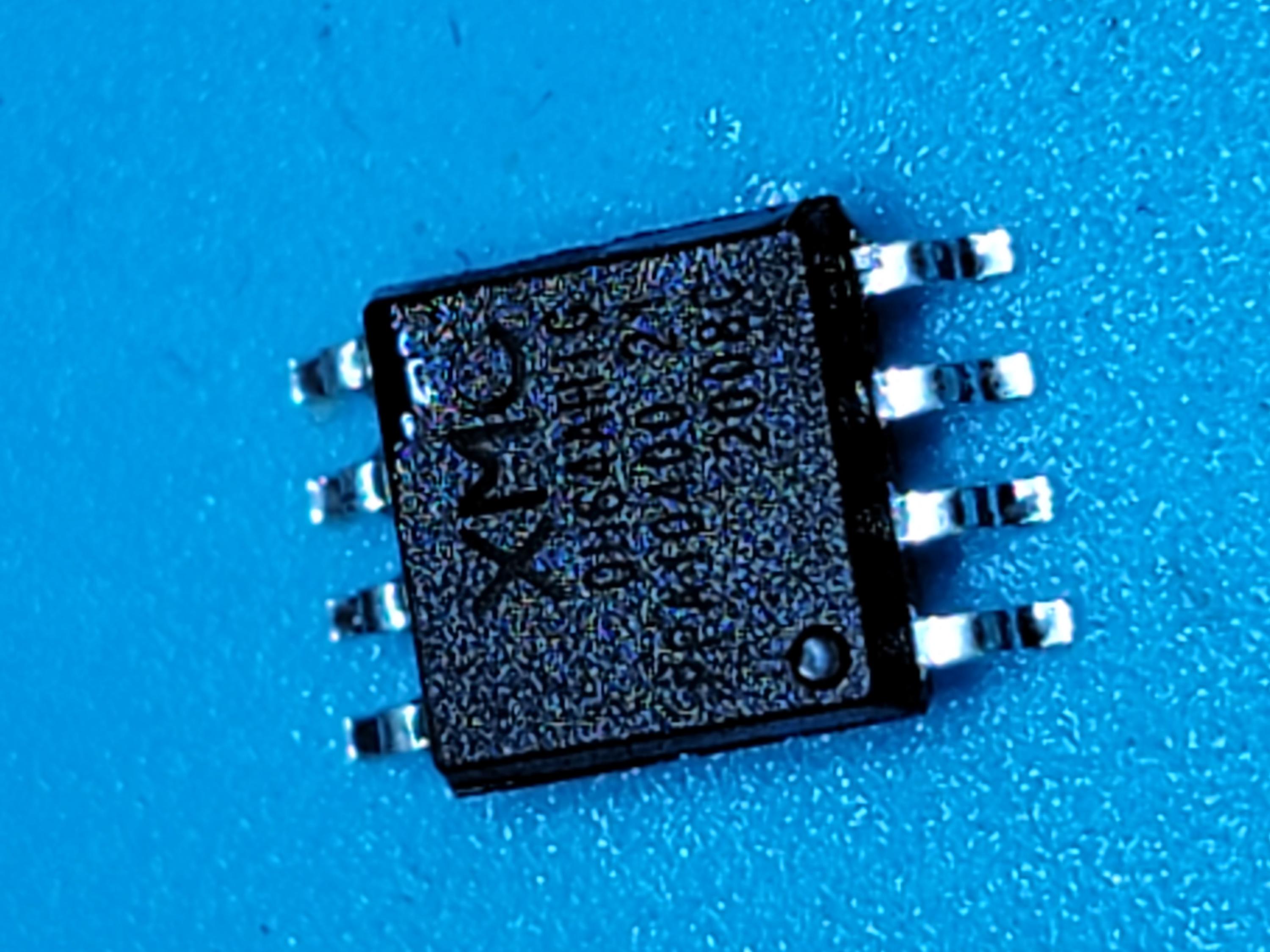

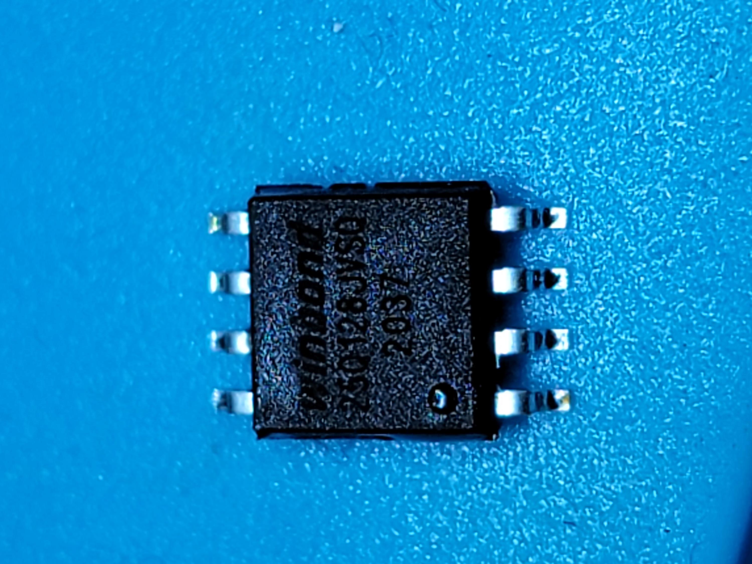

                            Here are both original backups of the chips. I did notice that my buddy not only selected the wrong size to do the XMC chip backup. He also selected the wrong chip in the programmer. Both chips were backed up with the Windbond chip selection. the XMC chip should have been backed up by the programmer using "XM25Qh64A" but W25Q128JV was used in place. The Winbond chip is W25Q128JV. I will upload a follow up pic of both chips with their full descriptions. Thank you.

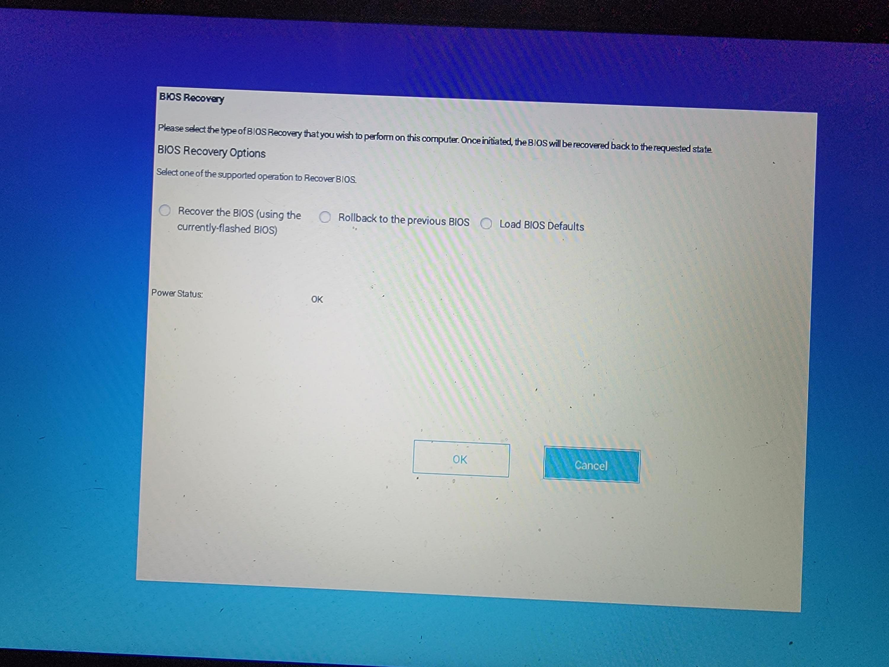

                                      Hardware1,
                                      I flashed, mounted and reassembled. Machine boots to BIOS recovery screen but I am not able to recover the BIOS (using currently flashed BIOS). The other options are Rollback to previous BIOS or Load BIOS defaults. Should I just pick Load BIOS defaults?
                                        Hardware1,
                                        I'm really don't know, but you can upload a picture and maybe someone can help you.
