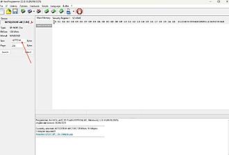

            yep, read it again and choose right chipset in your software programmer. your dump should be 16.777.216 bytes. if it's 128JW it's 1.8V chipset.
            • lucian6464
              • Feb 2021
              • 16
              That was the backup, done it 2 times, and it was the same. I have used a 1.8V adapter to read it. After I tried to write this bios (attached), but it didn't work unfortunately.

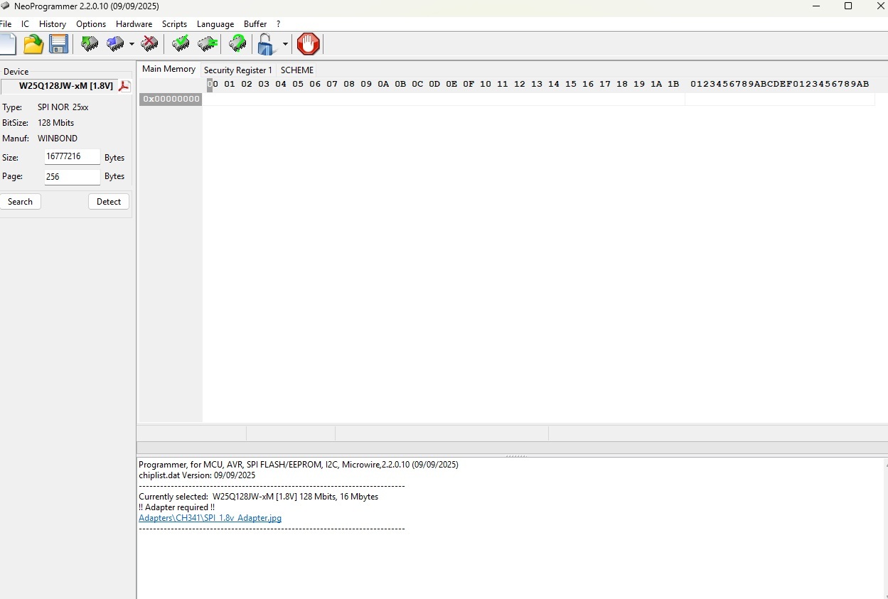

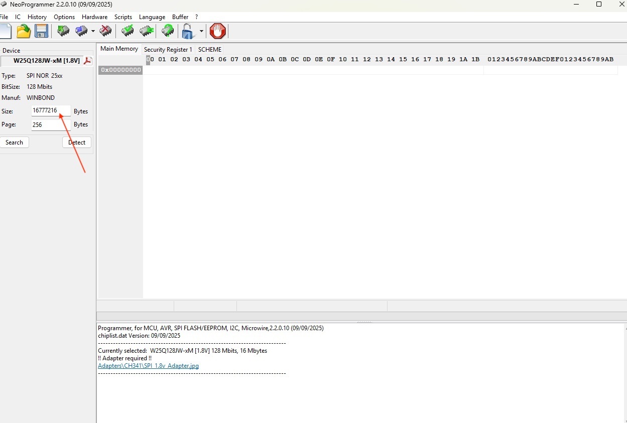

                because you don't choose correct chipset in your software. post a pic with your software if you don't understand what I mean.
Name:	Screen Shot 2025-09-11 at 12.58.35.png
                • lucian6464
                  • Feb 2021
                  • 16
                  This is what I used (picture). I have attached the original BIOS from the manufacturer's website, but when I extracted the bin file, it is larger than the chip.

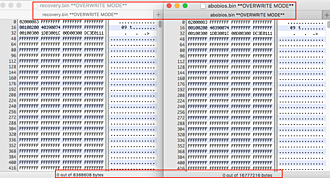

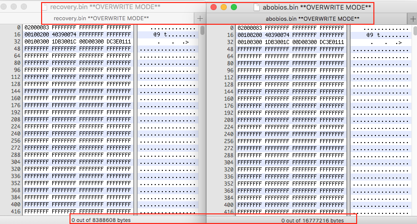

                    #29
                    and how do explain your dump is just 8.388.608 bytes? Something is not right. And your DMI is on the missing part.
                    This is bios extracted from update but you'll not have DMI.
                    • lucian6464
                      • Feb 2021
                      • 16
                      #30
                      Don't know why. Will try to reprogram with this (AN515_111.bin.zip) and see what will happen.
