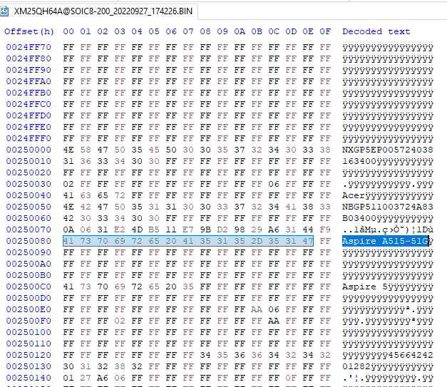

    Hi everyone need acer bios 2018-09-14 C5V01 LA-E891P REV 3.0 model NX.H9KEM.002

    Post your corrupt bios file.

      its 8mb only bios bro

        Re: need bios acer a315-53-hq
        Your file shows that model number (Aspire A515-51G), so try this one.

          Re: need bios acer a315-53-33hq
          Acer A315-53-33HQ its 7th gen Core i3 product of Taiwan
          your bios not working bro but thanks
            You're welcome. as you can see, this is the model in your dump file, not A315.

              May be bro someone flash this model so i got this dump file that why uploaded any way bro i downloaded from acer original site but s its size 9.2mb can you make it bro 8mb?
                        i try it not working i also remove enteral ram but same issue no display i think IO problem do u have bro ENE ec file this model if u have kindly upload
                          here
                            thanks dear Ec problem now working well
