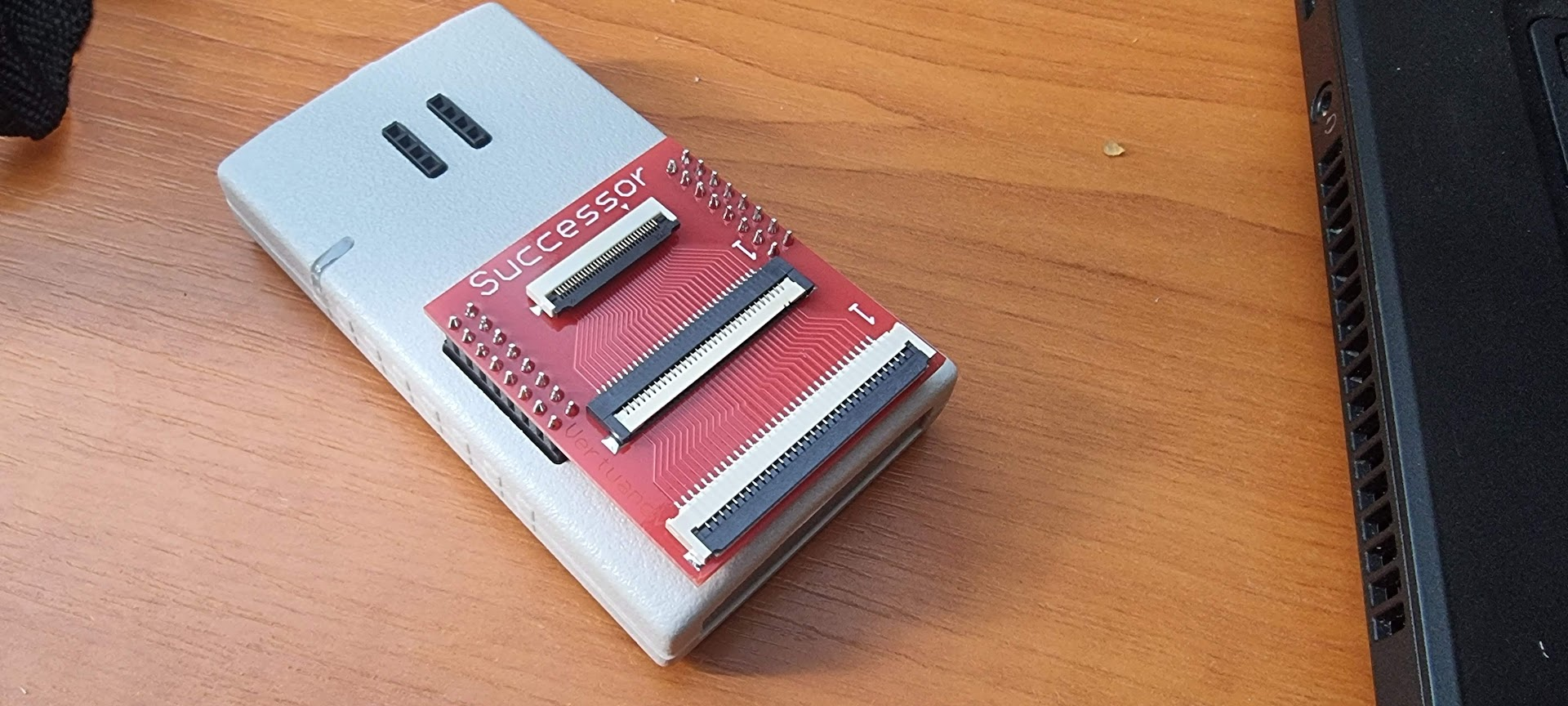

          • garfild
            • Aug 2020
            • 26
            • CZ
            Re: Thinkpad E14 black screen
            Behold! The Successor!
            IT8227E dump attached, can somebody remove the password pls?
            • garfild
              • Aug 2020
              • 26
              • CZ
              fixed! thank you all for your helps and tutorials on forum
