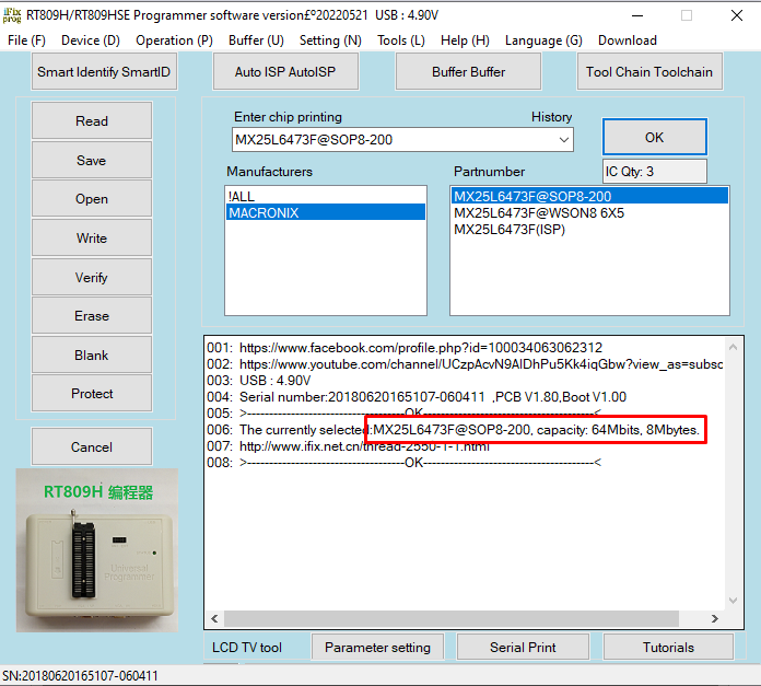

    I am looking for the bios of the HP 17-y054nf thank you
    I attach the old bios recovered on the computer if necessary

    Re: Bios HP 17-yo54nf
    I believe that you posted EC file, the main bios should be 8MB (I think), look for another bios chip on the board.
    I don't provide help for people using CH341A and a clip.
      Yes I also find it very surprising that's why I joined it. It's a MX25L6473F chip next to the super IO chip, it's not the bios? I thought he was just corrupt...
        Perhaps there is something funky with your programmer, see pic of RT809H with the selected chip.
          I am using EZP2019+ programmer. Indeed, this morning I did a reading and I got the right size?! I think I hadn't "tested" the chip before reading. If anyone has this stock bios to test on the motherboard, that would be great. And if someone could explain to me how to extract the MAC address and the serial number to inject it into the new bios, that would be even better
            bios extracted from the HP website update, the laptop has three bios variants, yours is 08224
            DMI +KEYWIN 30000 - 3203F
                It works ! my diagnosis was good... And your bios file is perfect. Thank you so much, you saved my day
