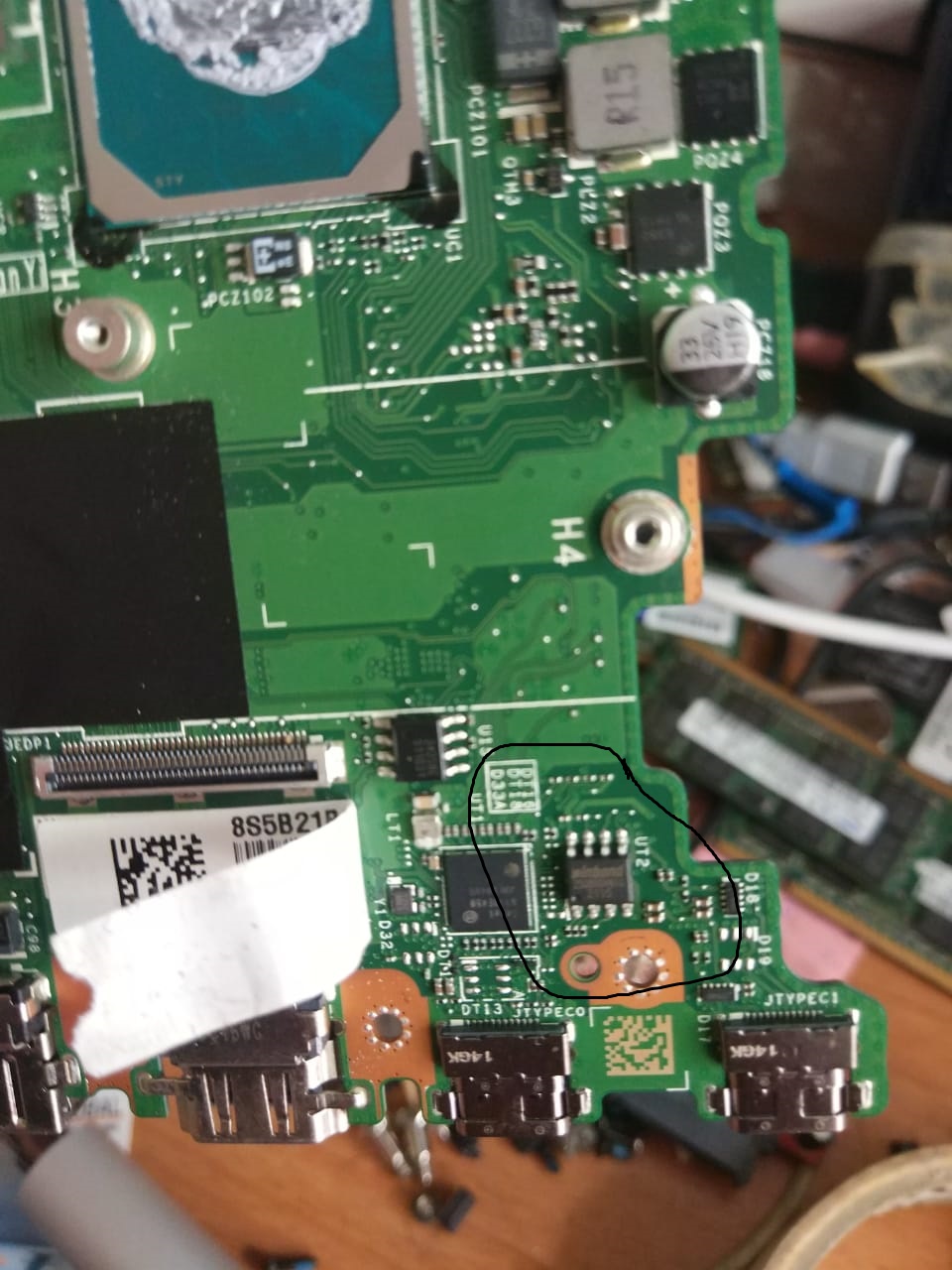

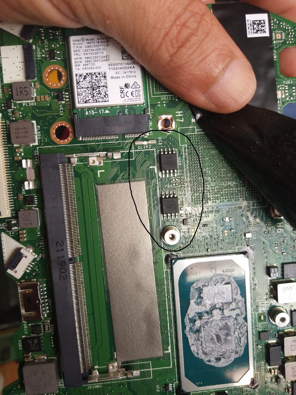

need bios thinkbook 16 G2 ITL FLV35 LA-K052P REV 1.0 plz
  • nafienew
    • Aug 2014
    • 116
    • up
    need bios dump for thinkbook 16 G2 ITL FLV35 LA-K052P REV 1.0
    My device is working but the screen is not showing

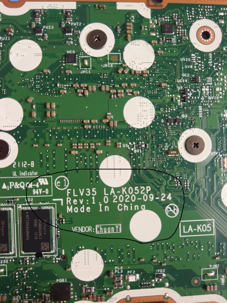

      Re: need bios thinkbook 16 G2 ITL FLV35 LA-K052P REV 1.0 plz
      Originally posted by SMDFlea
      Post the laptop serial number and your bios backup
      serial number FLV35 LA-K052P REV 1.0 2020-09-24
      This motherboard has three bios files, can I upload all of them?
          This is a picture of the motherboard

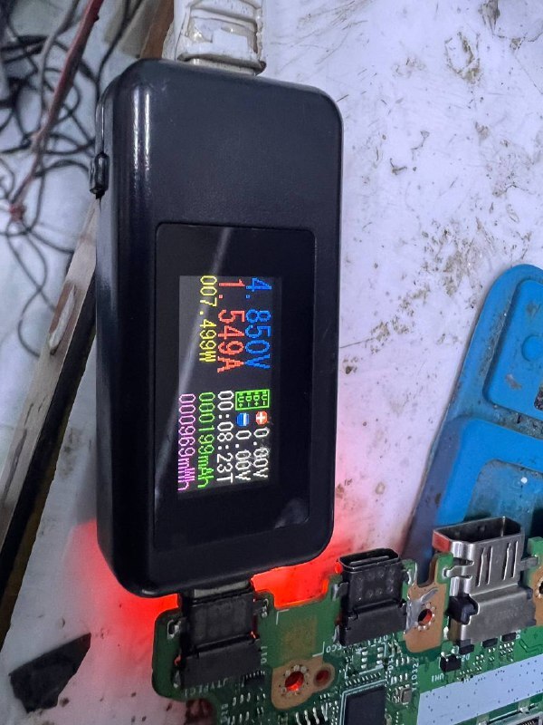

                            I have a lenovo thinkbook 15 g2 ITL
                            Board partnumber was LA-K052P REV 1.0
                            Serial no:-MP227A4D
                            the problem was type c port not working
                            i replace the type c ic..my old ic was SN2001024YBGR..i replace with TPS65994AD
                            now the system was producing 5 V output when i connect the battery charging also ok..but only get 5 v on ampere meter instead 20 v..then i
                            google it and find ..its related something firmware mismatch..i will update my old dumb 32 kb file..plz provide a working bios for this TPS65994AD CHIP
                            • Nikhil1997
                              • Jun 2018
                              • 4
                              • India
                              this is the ampere when i connect the battery...before the type c ic was short..thats y i replace it...i try 2 more ic also didnt solve
