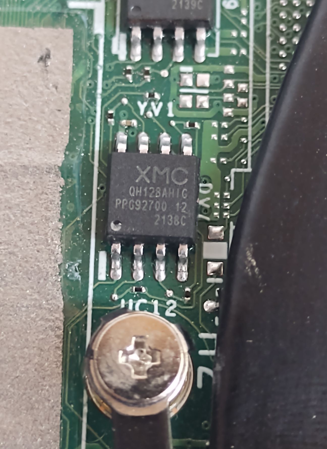

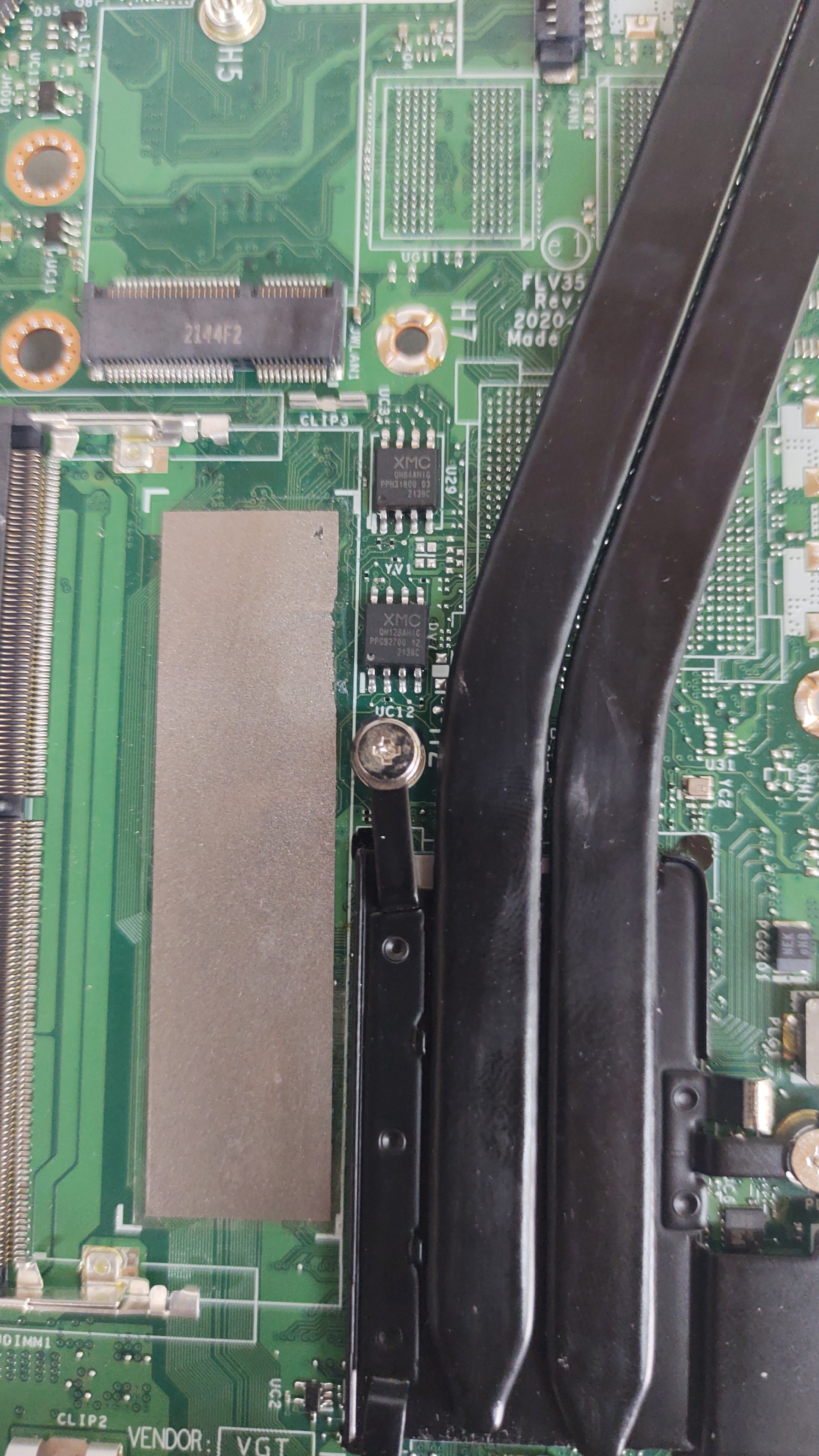

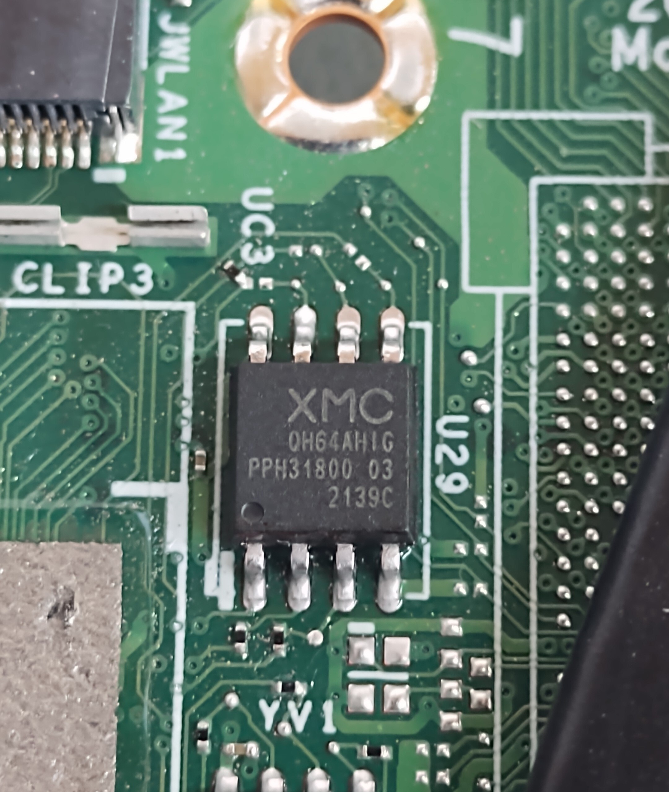

            Hi everybody.
            I need the BIOS for a Lenovo ThinkBook 15 G2 ITL with this motherboard:
            FLV35 LA-K052P
            Rev: 1.0
            2020-09-24
            Serial # MP25F6FV
            I think I screwed up big time. The laptop was powering on but had no image, and I tried to dump these two chips in circuit. Now the laptop keeps bootlooping with no image and no HDMI output.
            I desoldered both ICs and dumped them.
            Is there something else that I need to dump?
            Thanks!

              On your middle picture it looks like a resistor has moved. It`s the one next to the UC3 writing

            Looks like besides what SMDFlea commented about the misaligned resistor, there's also 2 missing resistors near it
            Check this picture, it shows 3 resistors there https://www.badcaps.net/filedata/fetch?id=2096307
            RC349, RC350, RC351, all 3 resistors are 33 ohms 0201 according to LA-K051P schematics/boardview https://www.badcaps.net/forum/troubl...view-schematic
            (boardview is mirrored)
            Here's BIOS in case you need it
            ThinkBook 15 G2 ITL Laptop - Type 20VE
            S/N MP25F6FV
            MTM 20VE00L4AR
            BIOS ver. F8cN47WW​
            DMI 20000-207FF on 16MB BIOS
            Flash both 8MB and 16MB chips

              Thank you so much for your explanation. Yes, as SMDFlea said, I managed to knock off two resistors and misalign a third one. I'm going to replace the missing ones, after that, I'm going to use the BIOS you provided 😊.
              Again, thank you for your answer and for your time!!!
              P.S.: Sorry if I came across as rude, English is not my first language

                Have you managed to resolve this? I have the same issue, and yes, I also read the chip on the motherboard. I managed to repair three resistors that I knocked off and flash the chips thanks to SMDFlea and m1ch43lzm.
