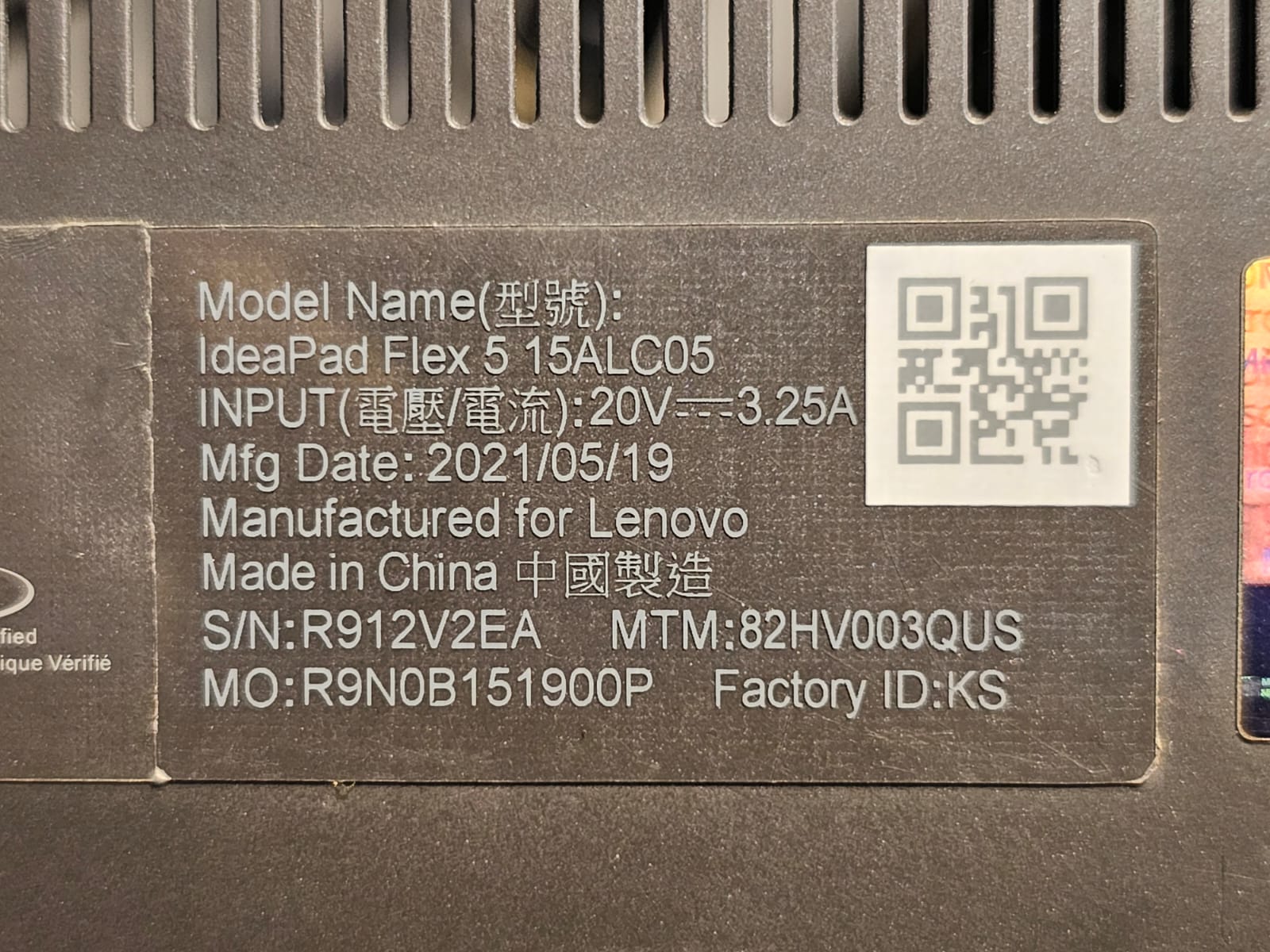

                                      Re: Lenovo flex5 14alc05
                                      Hello, thank you very much, my English is very bad. I hope you can understand me.
                                      this IdeaPad presents.
                                      The screen black and Capslock LEDs are lighting up
                                      s/n: R912V2EA
                                      m/b: LC56-14A SVT
                                      203021-1
                                      448.0MD08.011
                                      original bin attached to this lenovo.
                                      grateful for your help
                                      Premium supporters get full download access and other benefits.

                                        #39
                                        s/n: R912V2EA
                                        m/b: LC56-14A SVT
                                        203021-1
                                        448.0MD08.011
                                        try post #2
