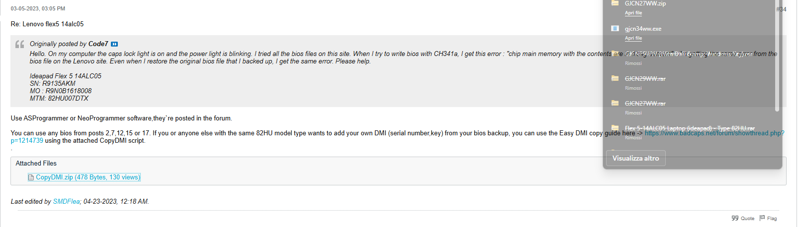

                                  I'm trying to fix my Lenovo IdeaPad Flex 5 14ALC05, the screen simply stays black and the Esc and Capslock LEDs are lighting up, fan is on.
                                  S/N: PW00C377
                                  MTM: 82HU00JWUS
                                  MO:: PWN0B1B30008
                                  I dumped the bios with my CH341A and I've been trying to figure out what's corrupted, but I couldn't so far..
                                  Might someone be able to help me with this?
                                  Thanks and regards!

                                    try this bro and update me
                                    • Wang Tingting
                                      • May 2025
                                      • 5
                                      #280
                                      AHSAN TARIQ It works, thanks.
