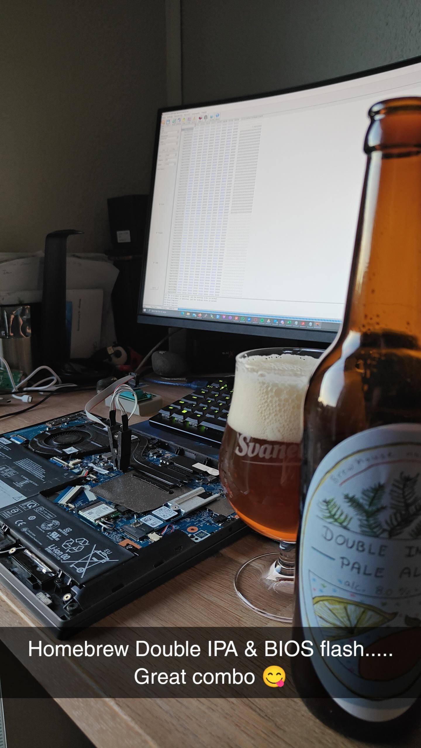

                      hoaca388, thanks a bunch. That worked like a charm 🙌
                      Let me elaborate on my way to success with EZP2019 programmer acquired from Amazon with 1.8V adapter (note: there's a newer version EZP2023. The software recognized the 2019 version however the chip database did not contain Flex 5 14ALC05 Winbond W74M12JW bios chip either).
                      1) saw a bunch of YouTubes irt. CH341A and EZP2019 how-to-program and do's/don'ts. I really considered afterwards if I should have bought en CH341A or maybe even the newer version CH347T / F (able 1.8 volt)
                      2) read a bunch of posts to include this awesome collaborate website 😀
                      3) how to place the in situ chip reader irt. pin 1 - 8
                      4) read up on Winbond.w74m12jw rev b data sheet to verify voltage usage (ie. do use 1.8 volt adapter)
                      4) troubleshot how to use the 1.8 volt adapter with the EZP2019 including how to place both adapter and in situ chip reader - ie. how to orient pin 1 right from the motherboard/bios chip to the EZP2019
                      5) use of software including setting variables to reduce interference, double verification of reading bios and Erase bios before writing then verifying bios data (Lesson Identified: if you only write - verify it's gonna produce an error)
