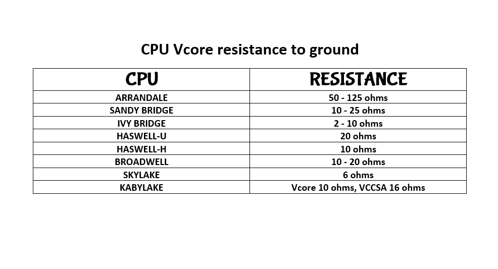

    hi all, the motherboard does not turn on, it had a short to a mosfet that powered the cpu, replaced the mosfet the pc turns on with a black screen, the cpu resistance is about 1.8ohm, it heats a lot, I wanted to make sure a bios working before a diagnosis with damaged cpu I am attaching the bios

    Extracted from official update, if it doesn't work, then you have other problems. Here is a picture for resistance reference, it may help you.

      thanks, but still black screen, I guess a dead CPU
