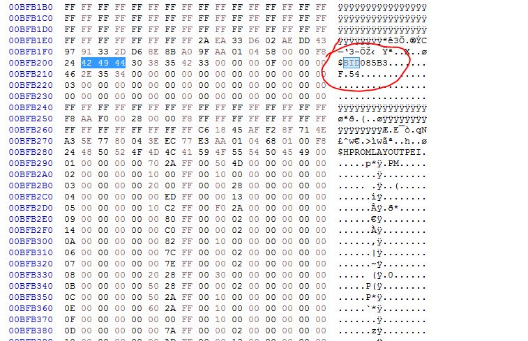

    hello please i need the bios dump of this motherboard

    post the full name and model of the laptop.

      Open your bios with a hex editor and search for the word BID , you should be able to this by now after 600 posts. Go to the HP support site,enter the serial number,download the bios update. Run the exe and choose to save to a location. You should now have the extracted virgin bios matching the same BID. All thats left to do is copy your DMI (serial etc) from your backup to the new bios using a hex editor, a 1 minute job.

          HP 17-ca1026nf

            HxD hex editor https://mh-nexus.de/en/downloads.php?product=HxD20

                Greetings to all. Please help me extract the bois file. Tried on different systems, nothing happened. I also attach the read dump. BID 085B3. Thanks in advance. It was not possible to add an archive with a file downloaded from the official site, so I am attaching a link to the cloud storage.
