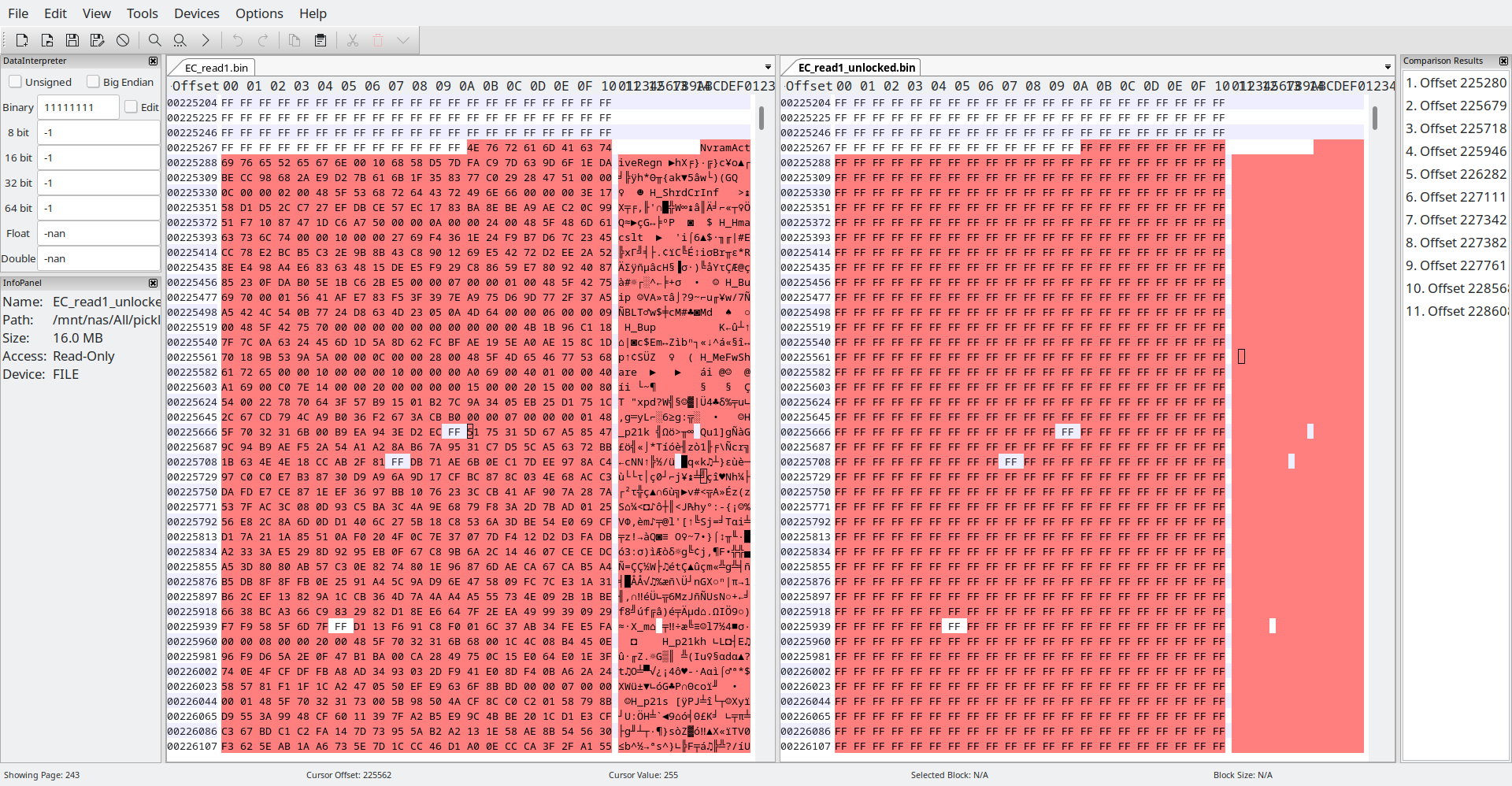

    A customer dropped off a HP ELITEBOOK X360 1040 G7 with a "power-on authentication" problem.
    Customer says he didn't set this up. Neither password or fingerprint works.
    I have tried flashing:
    1) JBIOS1UH2
    with:
    a) RCUnlocker (by RethoricalCheese). Didn't do anything, beacause the chip is 32MB in size.

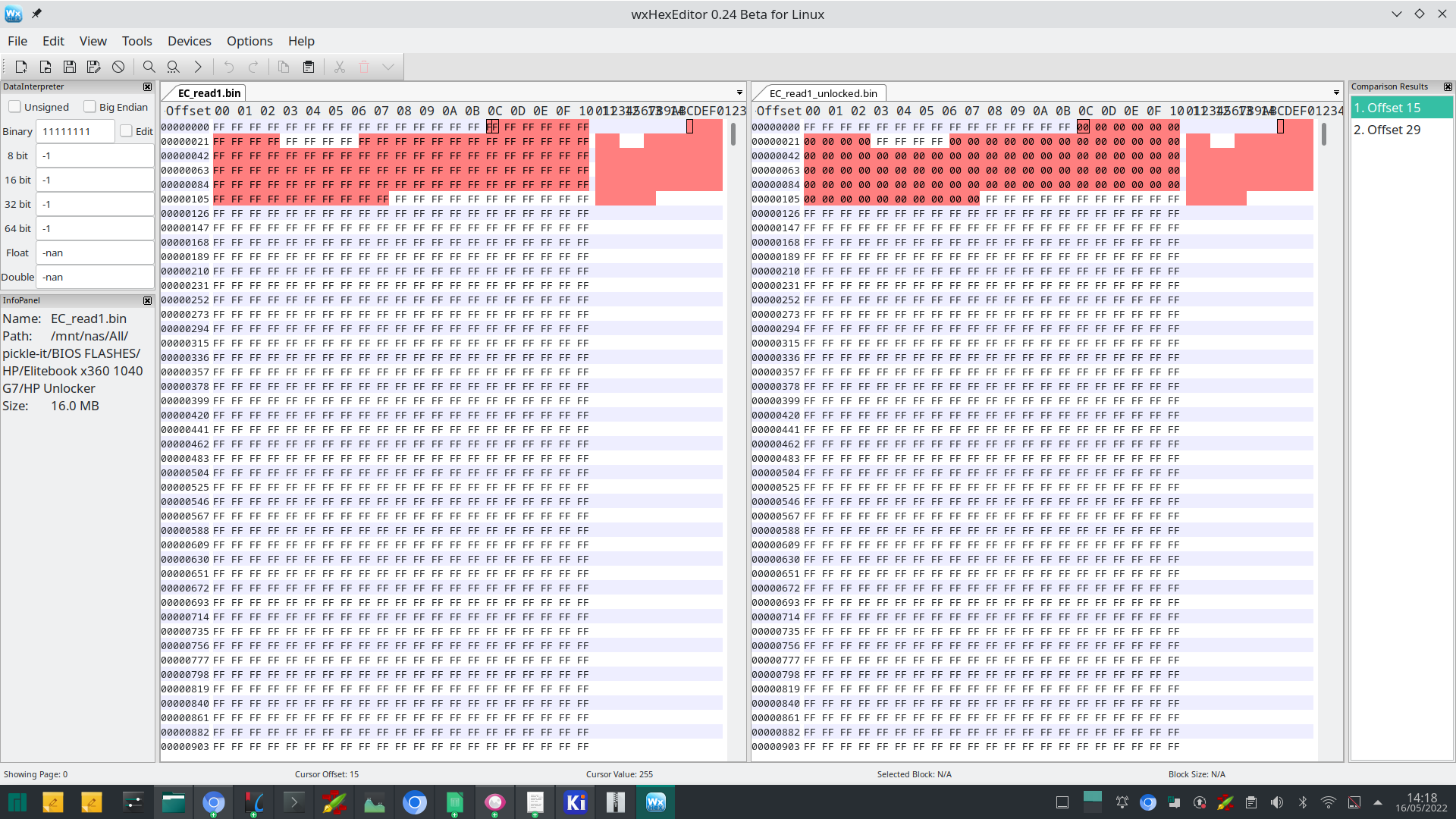

    b) HPUnlocker (by mazzif). Made a small change (changed: "00 00 00 00" to "FF FF FF FF".
    result: "power-on authentication" is still present.
    2) UEC3
    with:
    a) RCUnlocker (by RethoricalCheese). Makes a big change (see the attached screenshot).
    b) HPUnlocker (by mazzif). Made a small change. The change is similar to the change made to JBIOS1UH2. It changed 71x "FF"s to "00". Don't think I wrote thhis one back to the chip.

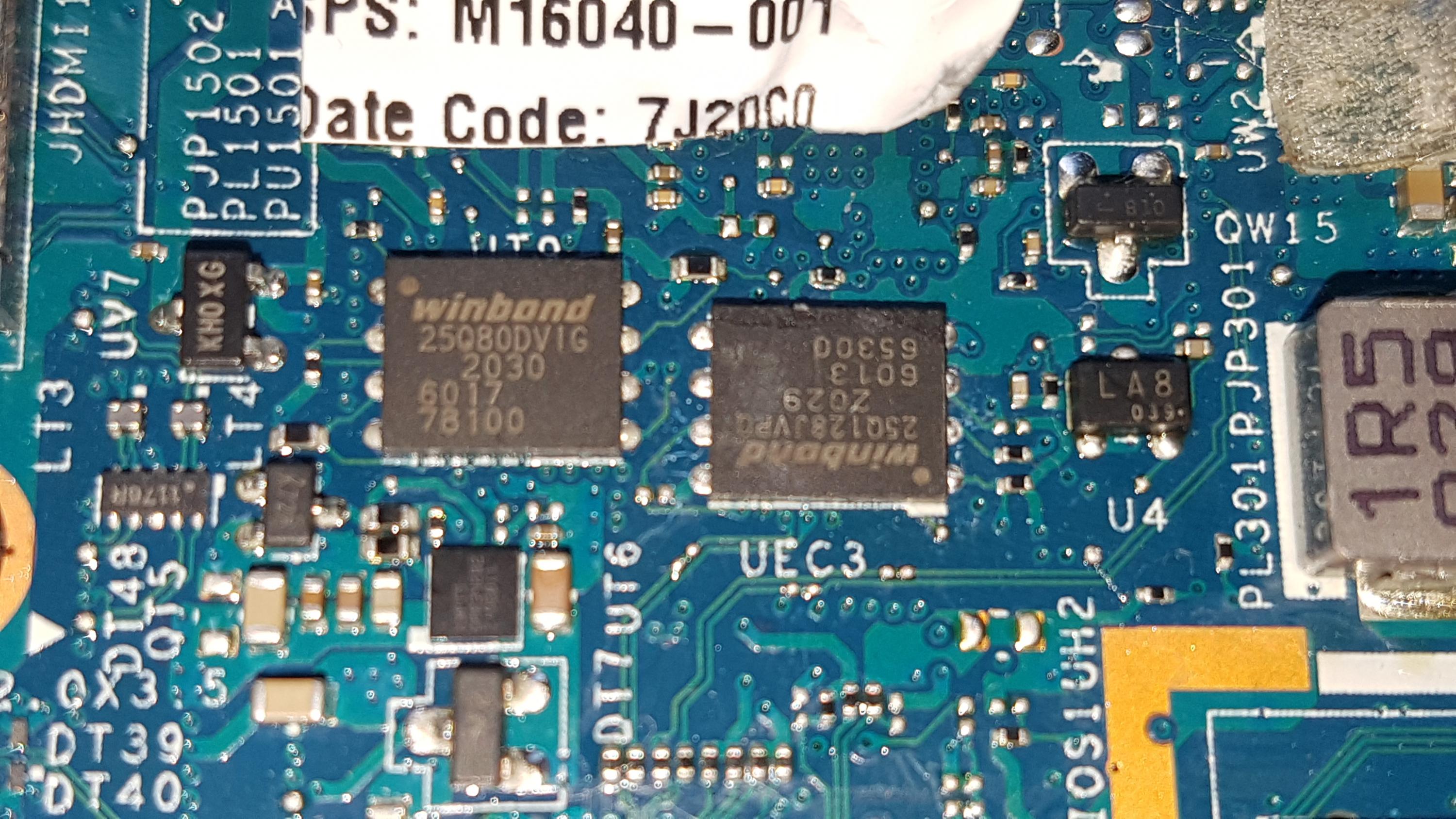

    There is another Winbond chip next to UEC3 designated UT9. The chip is a Winbond 25Q80DVIG. The 25Q80DVIG is a "3V 8M-BIT SERIAL FLASH MEMORY" chip. That means the chip is 1MB in size. Does anyone know what this chip is for? Is it worth it to dump it and run it through RCUnlocker/HPUnlocker?
    Does anyone have any other suggestions on how to remove "power-on authentication"?

    Upload both bios dumps here.

            Both two files must be written to the corresponding chips simultaneously.
