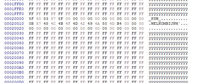

    I'm trying to find a way to extract the bios password for an Acer E1-731. I've extracted the bios + EC but i have a lack of knowledge on how to find the bios password in the HEX editor.
    This laptop is unused since 3 years and I did forget to remove the password at that time (i have another one where I removed the password when i decided to store them)
    Find enclosed BIOS + EC.
    Board number :69N099M13A01 - 12667677 - NBRYR11001346029B47200
    Any hint or help will be much appreciated! :-)

            • 21029
            Re: Acer E1-731 Bios Unlock
            Originally posted by Kashi1712
            Hey,
            Thanks for the answer, I did forget to tell, i've seen this but i'm not getting any 10-digit, just that the system will halt and that's it.
            This might be it
                Thanks mate ! That was it :-)
                  Interesting, it is a clear text
