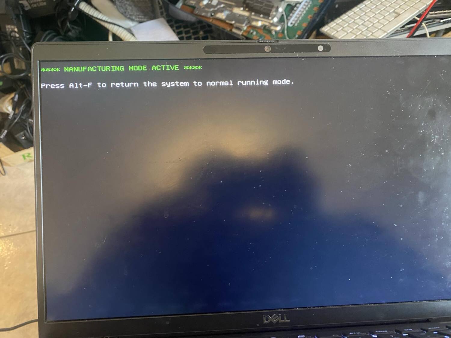

                        #53
                        HELLO everyone
                        Dell 7410
                        service tag:- J01QQ73
                        MOTHERBOARD CODE :- FDX40- LA-J261P REV : 1.0 (A00)
                        PASSWORD AND LATE DISPLAY
                        • rex98
                          • Feb 2023
                          • 1292
                          • Mandaue CEBU, Philippines
                          #54
                          Originally posted by Rameez Ahmed
                          HELLO everyone
                          Dell 7410
                          here clearme+unlocked
                          1st boot, press F2, write service tag, disable Absolute, save (Apply changes), restart. 2nd boot press Alt+F to exit manufacturing mode
                          • Rameez Ahmed
                            • Apr 2023
                            • 21
                            • Dubai
                            #55
                            BIG RESPECT THANKS SIR
                            rex98

                                  #58
                                  Please, remove bios password for Dell 7410 2 in 1.
                                  FDX40 LA-J261P Rev: 1.0 (A00)
                                  S/T: 4GMC573
                                  Thanks,​
                                  • rex98
                                    • Feb 2023
                                    • 1292
                                    #59
                                    S/T: 4GMC573
                                    Thanks,​
                                    • vuquanghoanh
                                      • Feb 2023
                                      • 45
                                      • US
                                      #60
                                      It worked well. Thank you so much.
