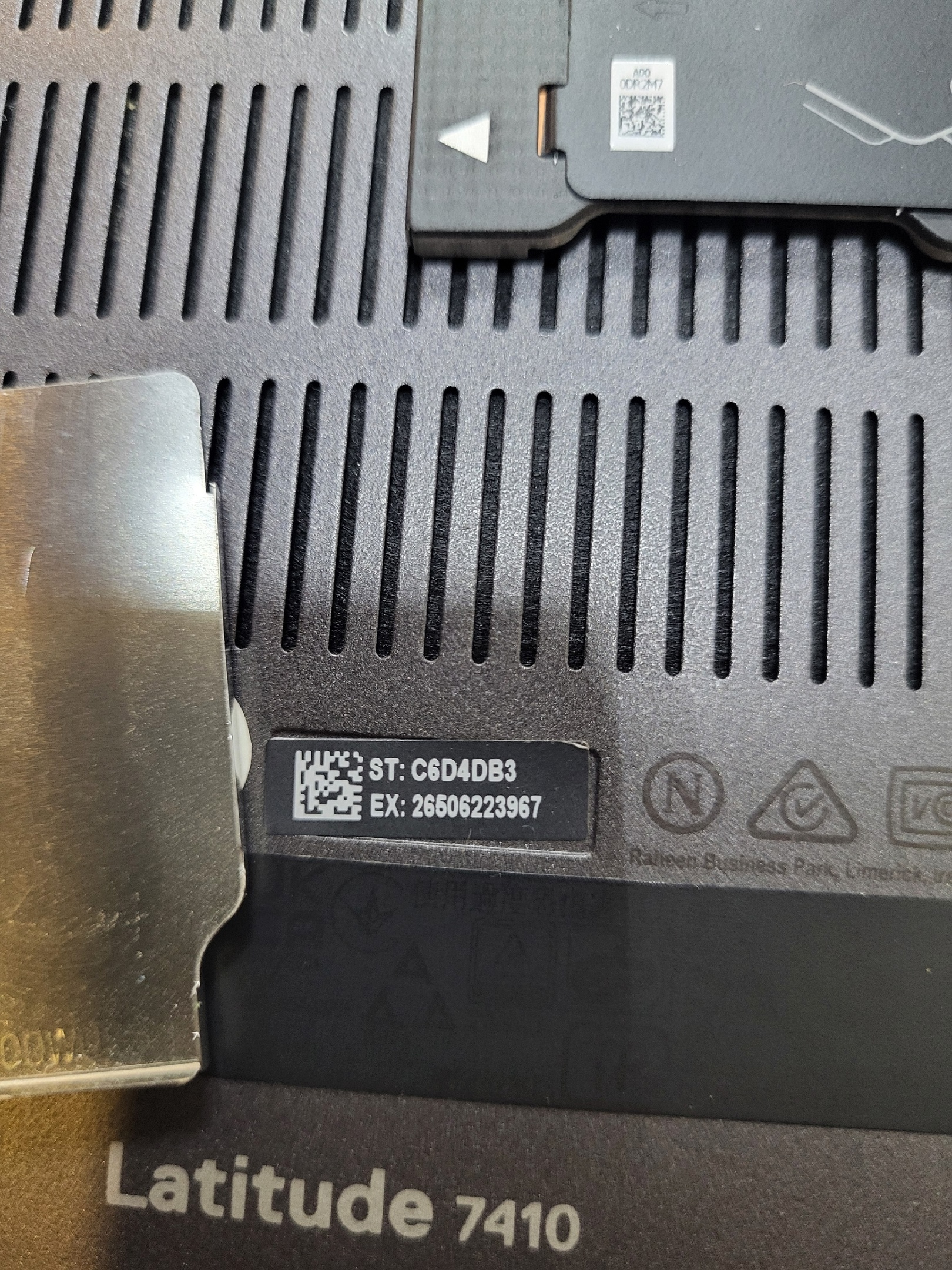

          Dell latitude 7410
          S/T: JX7HX33
          LA-J261P
          Rev: 1.0(A00)
          I lost origin bios dump. I found another bios dump, machine runs normally but late display.
          Help me clear me bios, please
          Thank you so much,

            Latitude 7410
            Service Tag: JX7HX33
            • Young Man
              • Aug 2024
              • 20
              • US
              #106
              Originally posted by hoaca388
              Latitude 7410
              Working perfectly. Thank you so much

                Hello, I have a Dell Latitude 7410 device and the eprom is faulty. Can you help me with the BIOS? la- j261p ST: GZXHDB2 EX: 37001071263

                      • zaferkaya38
                        • Sep 2018
                        • 7
                        • türkiye
                        #111
                        It does not read xmc qh256bxiq, it is defective, I installed winbond 25q256jweq instead

                                  There was a password on the device. I gave too much heat while removing the EPROM. XMC did not read it. I tried some of the 25q256j form. When I press the power button, the yellow light is flashing. Please help.
