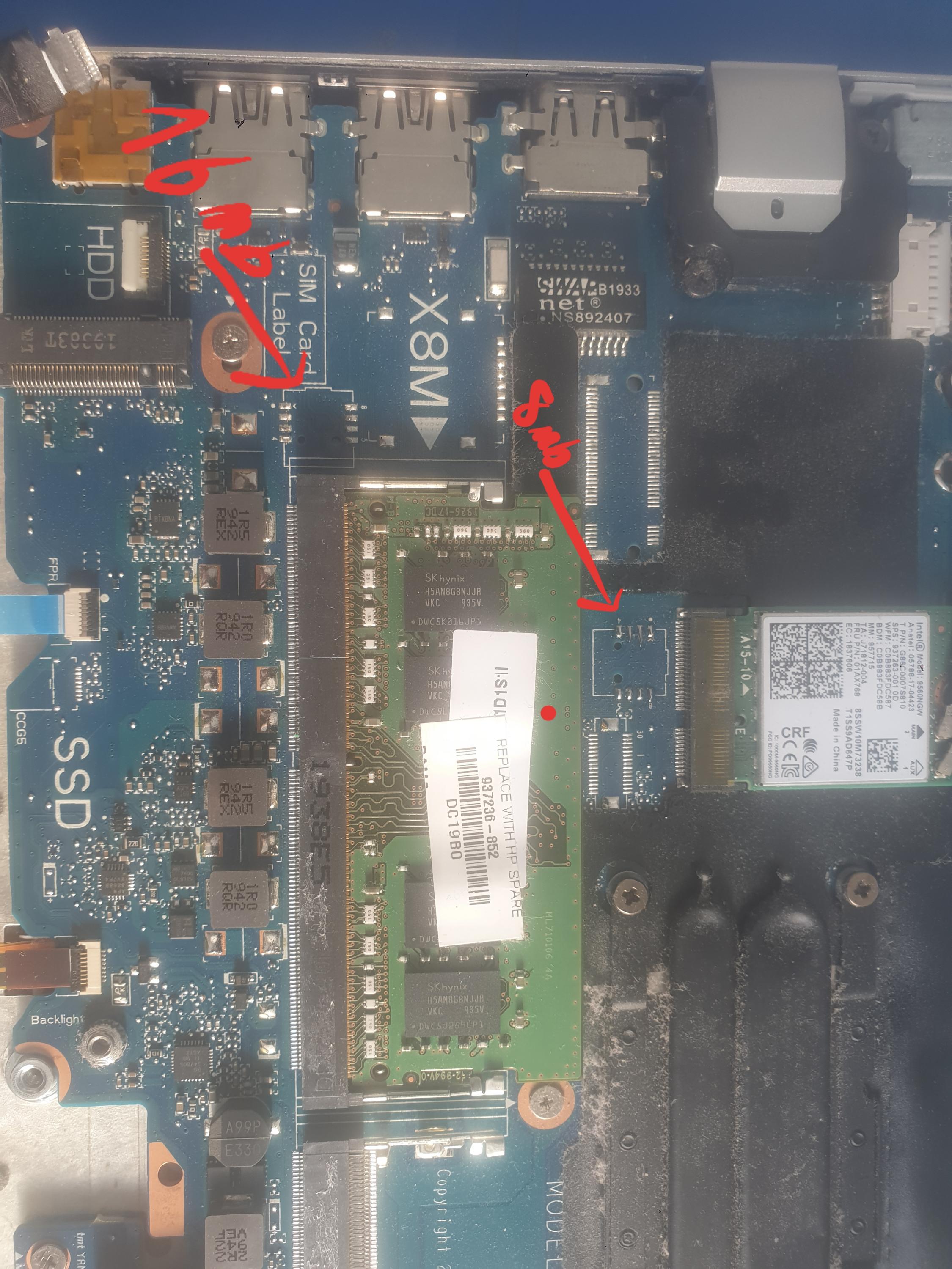

    hi there, laptop not working after bios update, is it possible to fix the dump file?

    Looks like your laptop has 2 bios chips. Find and upload its file.

      yes it has you are right, seems i uploaded onle one , this is the second one

        Excuse me, how many MB is your first bios chip? Name of that chip ? ( I think it is 16MB chip. )

          its 25l12872f, gave me 8 mb after saving the file

            the second chip is 25b127dsig 16mb

              here where are they on board

                25l12872f , 16MB bios file. Check your programmer.
                This file for first bios chip.

                  worked thank you so much, i dont know if it was my programmer or the chip is corrupted , i just flashed your file and the laptop is alive again , thanks
