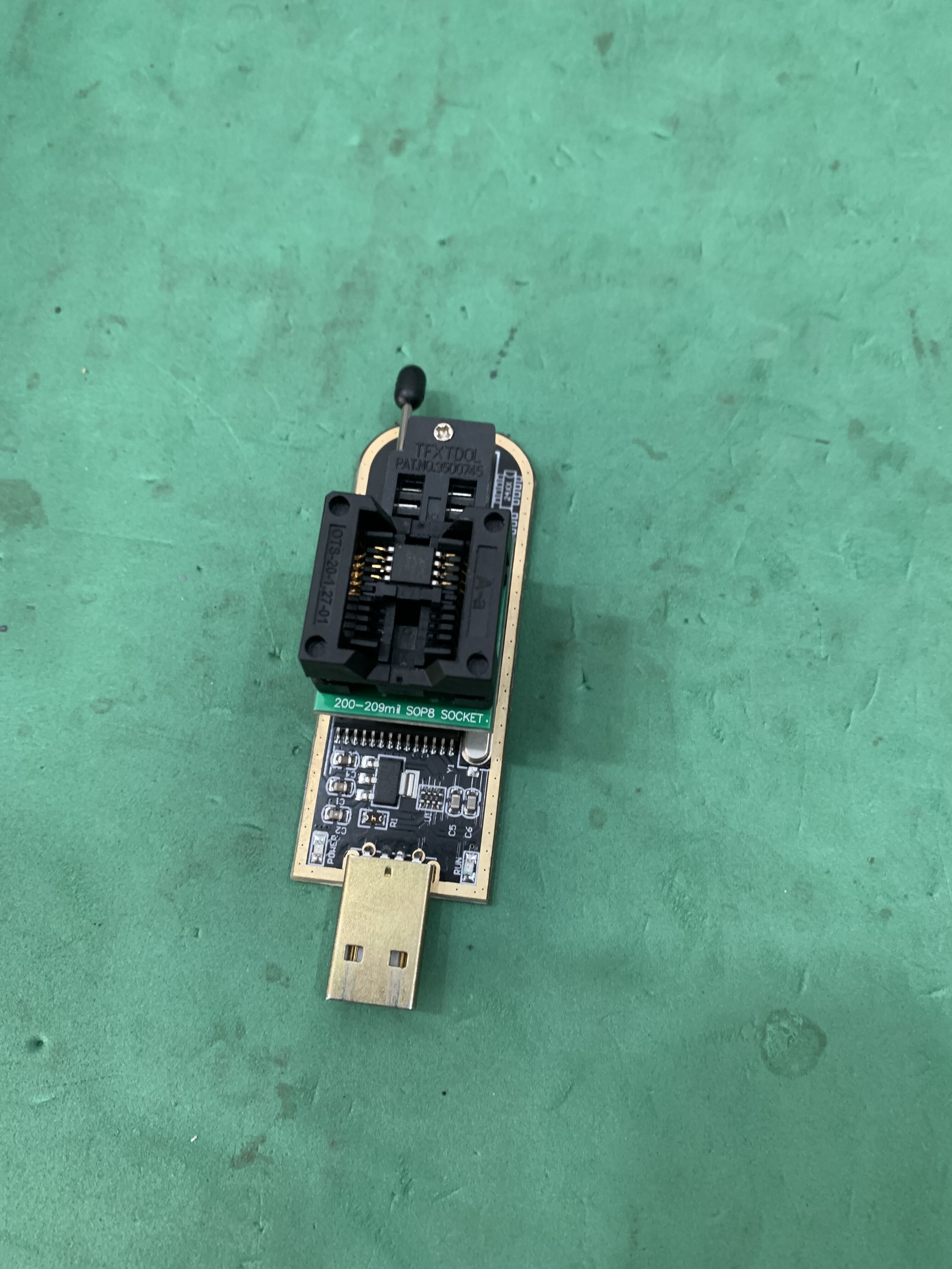

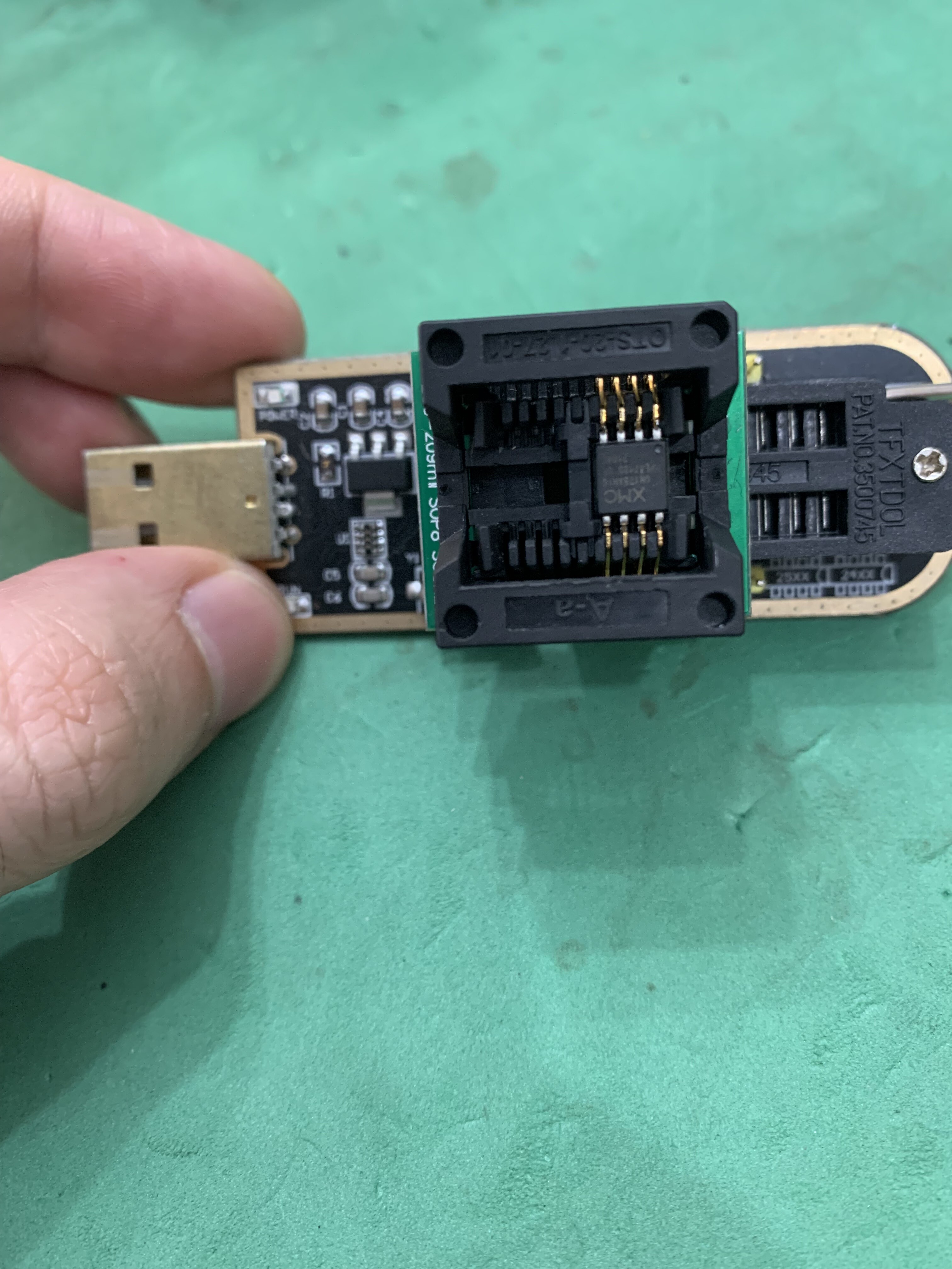

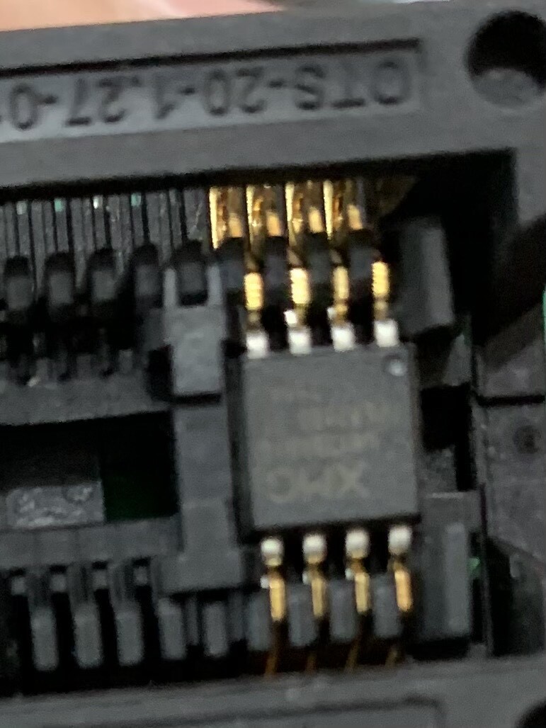

                I removed the chip from the motherboard and used a CH341A eprom burner and NeoProgrammer V2.2.0.7
                What do you recommend me to do?
                I'm doing this process because out of nowhere this notebook stopped turning on... I suspect the bios has been corrupted
                  #49
                  Try to read the chip again. Also send an image for your chip number and the adapter that you are using to connect it to the programmer.

                    #50
                    follow the photos friend
