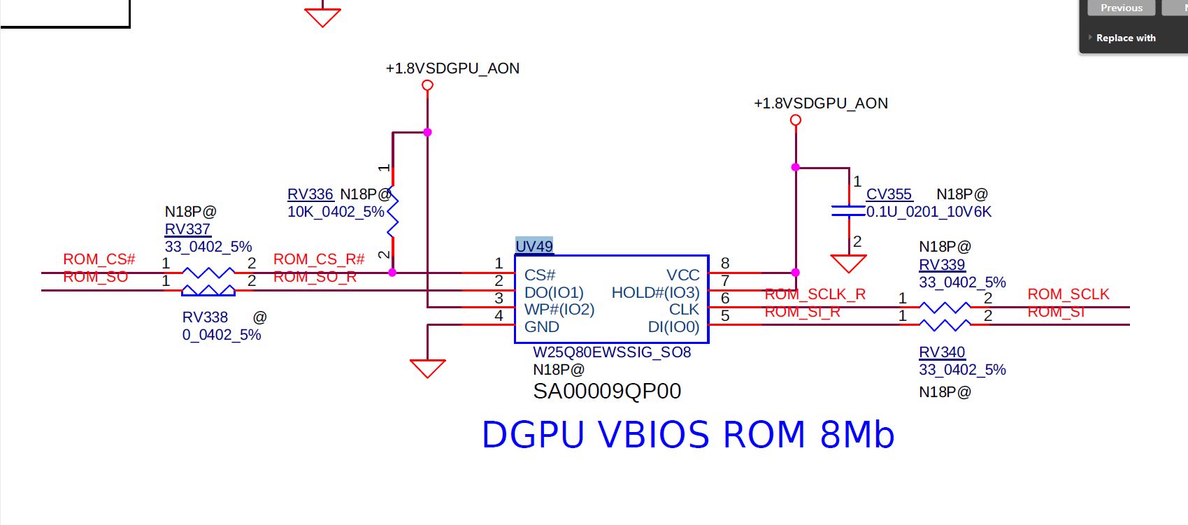

                                  Re: need bios ACER NITRO AN515-54
                                  i need vbios for this laptop....anyone have?...this laptop has no display...my customer said he already went to 2 computer shop but cant resolve the issue...im curious about this vbios, it should be 8mb isn't it?...i try to make backup only read 1mb
                                  board number - EH5VF LA-H501P REV 1.0
                                  • peste
                                    • Dec 2016
                                    • 13768
                                    • ROMANIA
                                    post the S/N....
