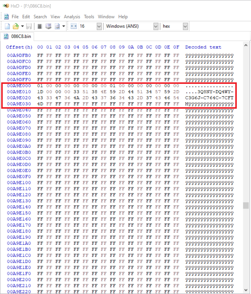

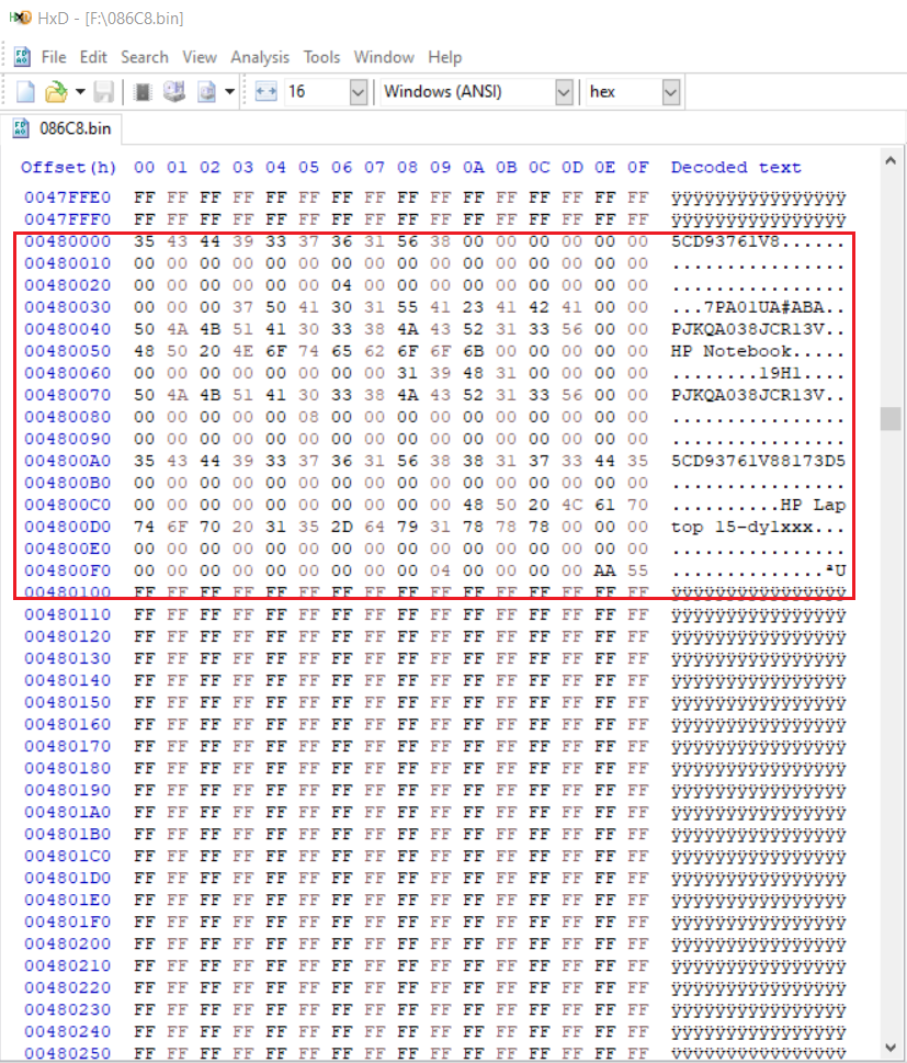

Hp 15-dy1731ms MB DAG71MB16D0 Rev C No Power
  • mferna14
    • Jun 2018
    • 1018
    Hp 15-dy1731ms MB DAG71MB16D0 Rev C No Power
    I am working on this Hp 15-dy1731ms MB DAG71MB16D0 Rev C, not Powering on. I get 3.3V on the ON/OFF assuming that the IO chip is good. Attaching the Original BIOS. If someone can rectify this, I would really appreciate. BIOS is programmed to Winbond 25Q128JVSQ. Thanks in advance. NB S.No: 5CD93761V8 Model 15-dy1731ms
  • mferna14
    • Jun 2018
    • 1018
    Re: Hp 15-dy1731ms MB DAG71MB16D0 Rev C No Power
    I found the BIOS from the Hp site. Got the BID info from Original BIOS "086C8" which is for my model, Can anyone inform me the end offset length that has to be copied to the new BIOS... Thanks in advance.
    • hoaca388
      Badcaps
      • Jan 2022
      • 11691
      Re: Hp 15-dy1731ms MB DAG71MB16D0 Rev C No Power
      Originally posted by mferna14
      I found the BIOS from the Hp site. Got the BID info from Original BIOS "086C8" which is for my model, Can anyone inform me the end offset length that has to be copied to the new BIOS... Thanks in advance.
      Dmi : 480000 -> 4810ff
      Win key : A9E000 -> A9E03F
      • mferna14
        • Jun 2018
        • 1018
        Re: Hp 15-dy1731ms MB DAG71MB16D0 Rev C No Power
        Thanks "hoaca388" , did not understand at all!! Can you explain a bit clear.. Or kindly do it for me if possible, I would be grateful to you. Thanks anyways
        • hoaca388
          Badcaps
          • Jan 2022
          • 11691
          Re: Hp 15-dy1731ms MB DAG71MB16D0 Rev C No Power
          Originally posted by mferna14
          Thanks "hoaca388" , did not understand at all!! Can you explain a bit clear.. Or kindly do it for me if possible, I would be grateful to you. Thanks anyways
          Hp 15-dy1731ms
          • mferna14
            • Jun 2018
            • 1018
            Re: Hp 15-dy1731ms MB DAG71MB16D0 Rev C No Power
            Sir, "hoaca388" thanks, I have got this same BIOS 086C8 from Hp site & you even send me thes same as an attachment but I think no Dmi : 480000 -> 4810ff & Win key : A9E000 -> A9E03F information are updated. Kindly inform me how to do it or pls. do it for me. I programmed the chip & now I see life in the board, the White LED on the DC-in jack blinks for 3 sec & then turns off. Thanks
            Last edited by mferna14; 04-10-2022, 11:15 AM.
            • hoaca388
              Badcaps
              • Jan 2022
              • 11691
              Re: Hp 15-dy1731ms MB DAG71MB16D0 Rev C No Power
              Originally posted by mferna14
              Sir, "hoaca388" thanks, I have got this same BIOS 086C8 from Hp site & you even send me thes same as an attachment but I think no Dmi : 480000 -> 4810ff & Win key : A9E000 -> A9E03F information are updated. Kindly inform me how to do it or pls. do it for me. I programmed the chip & now I see life in the board, the White LED on the DC-in jack blinks for 3 sec & then turns off. Thanks
              here
              Last edited by hoaca388; 04-10-2022, 04:10 PM.
              • mferna14
                • Jun 2018
                • 1018
                Re: Hp 15-dy1731ms MB DAG71MB16D0 Rev C No Power
                "Hoaca388" thank you very much... I will try & let you know.
                • mferna14
                  • Jun 2018
                  • 1018
                  Re: Hp 15-dy1731ms MB DAG71MB16D0 Rev C No Power
                  Hi "hoaca388" I re-programmed but still the same, I press the ON/OFF switch & the white LED on the DC-in jack blinks 3 times & then shuts down. This happen when again the switch is pressed. I think problem is in the motherboard. Anyway I have opened a new thread "https://www.badcaps.net/forum/showthread.php?t=105397" , kindly if you can share some tips & experience of yours in there. Thank you very much.
                  • iulik17d
                    Intel Arc A380 videocard power limit remove - BIOS needed
                    by iulik17d
                    Hello everyone!
                    The Asrock A380 low profile card (ID 8086 56A5 - 1849 6006) have an power limit of 45W. Intel removed the possibility to increase power using the software utility, anyway the card is in an proxmox machine that doesn't run windows.
                    The same hardware is in another form by the name Asrock A380 Challenger that have the same VRMs and the power limit is at 60W. I searched online and found on another website an .bin bios file from the Challenger variant, that I flashed using an CH341a. Flashng worked well, I put the card in PC and booted. GPUz shows that new device ID is 8086...
                    01-10-2025, 02:33 PM
                  • PantherDave
                    by PantherDave
                    Hi all!
                    05-29-2024, 02:01 PM
                  • Vesko356
                    by Vesko356
                    08-11-2023, 03:27 AM
                  • Nopslide
                    HP Omen 15-dh0052nf power-on & bios password
                    by Nopslide
                    Hello everyone, I come here to tell you my problem regarding the power-on password. It is not a bios reset demand, and i can't have any access to windows. This is the bios and power-on password that is blocking all other things.
                    My Omen 15-dh0052nf purchased second-hand was configured with the bios password upon purchase (very simple password :P ).
                    Having decided to sell it in order to get something more powerful, I reset all BIOS settings and set a blank administrator password. But the power-on password cannot be changed to a blank one so I let the actual password set....
                    04-01-2024, 04:27 PM
