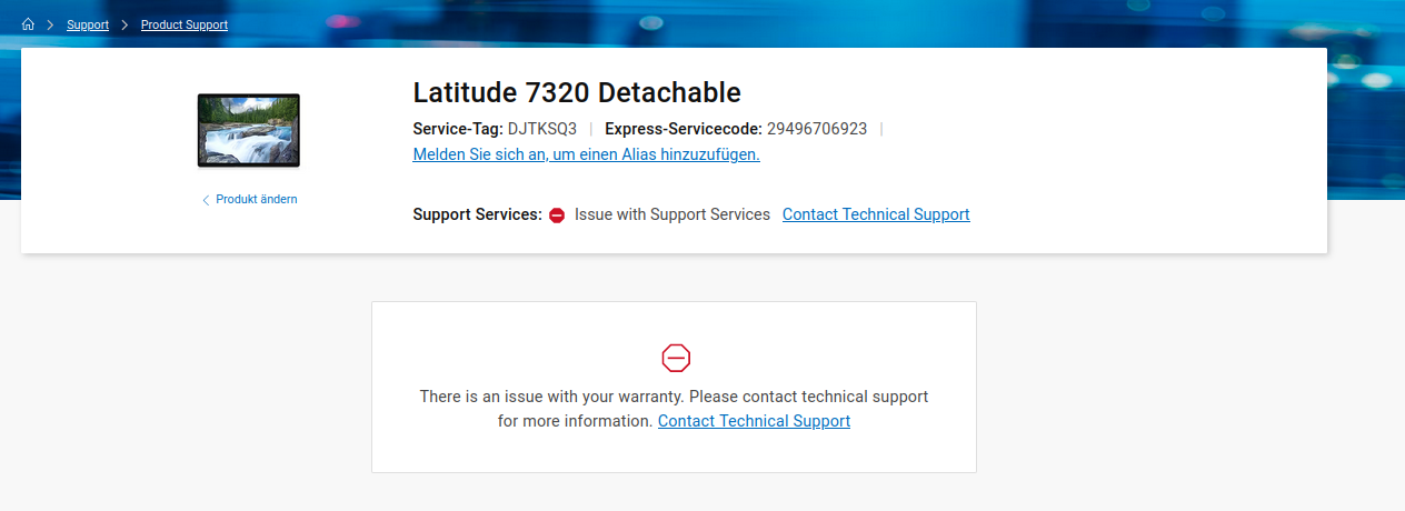

                              Hello friends, this bios file has a bios password someone can unlock
                                • 22424
                                You must post the service tag. And members who are trying to help should ask for the service tag to be posted also before giving help

                                  Can somebody clear this file for me?
                                  computer dell 7320 detachable
                                  servictag :- DRMLZHR
                                  THANKS !
