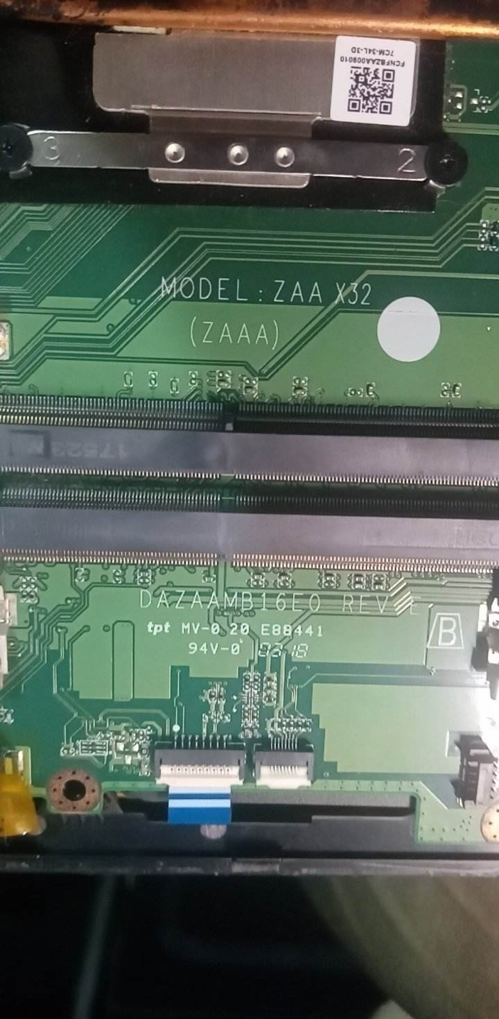

    tmp259-mg-70ra bios
    motherboard
    DAZAAMB16E0 REV E
    ZAA X32
    (ZAAA)
    SNID: 72803533876
    NO DISPLAY

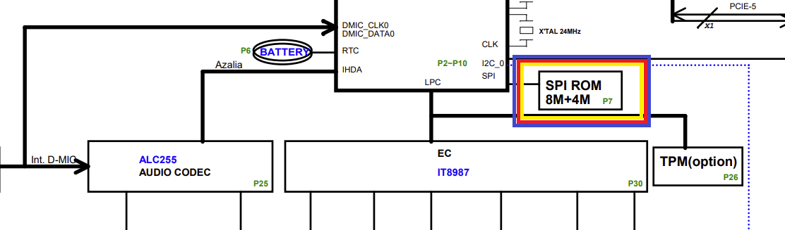

    Your system uses dual-chip storage, please upload files on both chips.

      do you mean the ec bin ? from teh ITE CHIP?

        It's a SPI chip 4MB. Find it.

          Re: tmp259-mg-70ra bios
          [ATTACH]258416[/ATTACH]
          in page 7 it says U41 CHIP only sir no other chip I can found on actual also in the scehmatic

            • hoaca388
              Originally posted by kalilinux25
              hope you can guide me
              I was wrong, maybe Your bios has been badly damaged.
