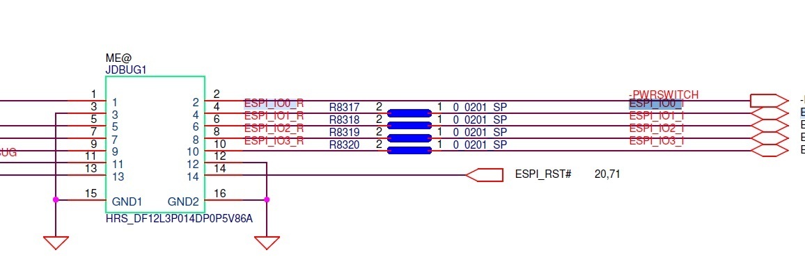

              I already have a CH341A programmer with an SOIC8/SOP8 clip. This means I want to read the BIOS and remove the supervisor password.
              It would be even easier if this could be done via these jumpers (J9301). Please provide a photo and indicate which pin needs to be connected to ground.
              Thanks for your support.​

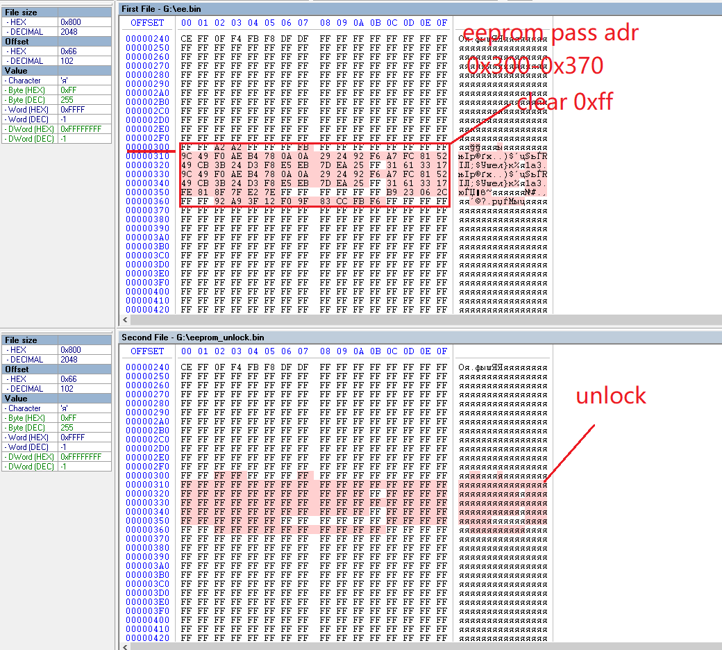

                                I am posting the mec1663 EC Lenovo T14 nm-c931 1st gen intel 10th that I read, the eeprom address where the password is located is at offset 0x300.
                                  I answered you here
                                  https://www.badcaps.net/forum/troubl...39#post3690539
                                  part is wrong. if you remove the lines, you will probably get an error
                                  0188: Invalid RFID Serialization Information Area
                                  0189: Invalid RFID configuration information area
                                    I had no errors, I'll check again tomorrow.
                                    • djacksod
                                      • Jan 2017
                                      • 4
                                      • UKRAINE
                                      #58
                                      I had standard RTC battery reset errors. After installing them, there were no more errors.
