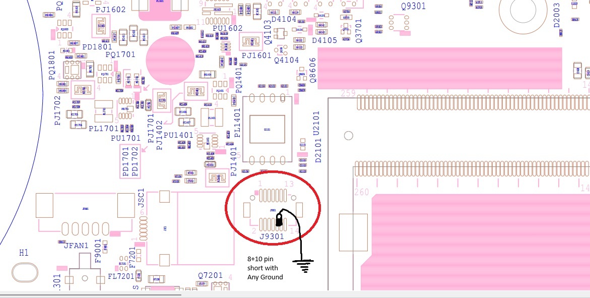

                                Lenovo ThnkPAD T14 i5-10th gen Bios password remove by shorting Jumper (J9301)
                                -NEED a USB Keyboard
                                -A Short wair
                                power on laptop
                                Short 8 and 10 pin with any groung connection
                                F1 to go Bios
                                Changewith new password
                                save with F10
                                Done
                                See the attachtment

                                  Good job !
