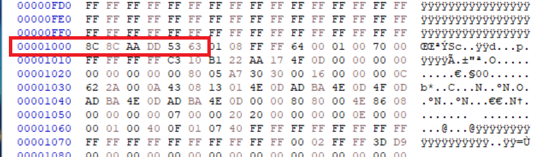

    hello,
    I have
    Lenovo T14 nm-c931 1th gen intel 10th with a difficult problem.
    everything like normal when installing a new fresh windows.
    but the problem is in the first step of configuration.
    when I skip the network connection there is no problem.
    bu when connect to a network, laptop is automatic connecting to a compay.
    laptop has no bios password.
    i have change the serial number
    i have program another bios with original ME.
    i cant find the correct ME for this model
    bu no luck.
    i share the the backup.
    can someone clear and rebuild the original bios?

    There is no computrace

      • osman68i
        • May 2015
        • 340
        • The Netherlands
        Re: Lenovo T14 nm-c931 1th gen intel 10th
        Originally posted by hoaca388
        Your serial number ? Your marchine type ?
        Hi Hoaca,
        I have tested this bios with same result.
        I install new os.
        when connect to a network, laptop is automatic connecting to a company.

          • imranromi

            • osman68i
              • May 2015
              • 340
              • The Netherlands
              Originally posted by imranromi
              Its Mdm.
              i have changed serial number.
              abosulute software (antitheft) is permanently disabled.
              imranromi how can i change the mac adres?

                    • osman68i
                      • May 2015
                      • 340
                      • The Netherlands
                      same result,

                      • msnessay
                        • Apr 2015
                        • 121
                        • GRANDY
                        Originally posted by osman68i
                        same result,
                        i think there is a part in the mec.
                        can you disable the wireless card in the bios setup and try usb stick wifi if you have
                        or doing JTAG and reprogram the MEC with Vertyanov
                        • ibo
                          • Oct 2019
                          • 94
                          • Turkiye
                          You can try to put another wireless card if thats not help than rewrite Super IO chip.
