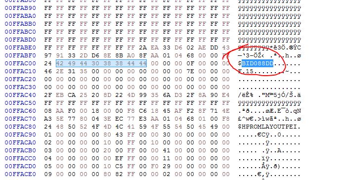

          The serial number is in plain text in the bios,you just havn`t found it yet, or the key

              bid088dd + dmi .

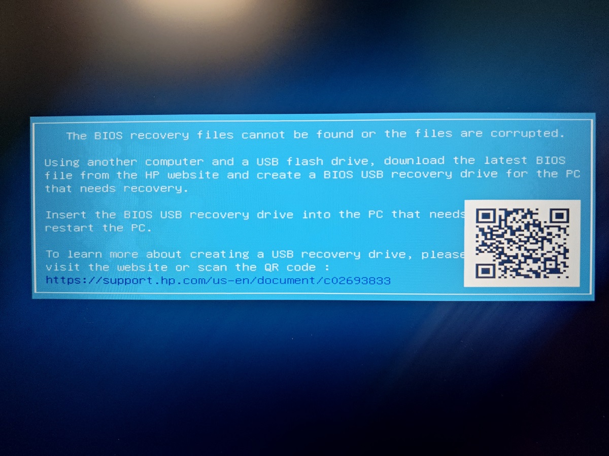

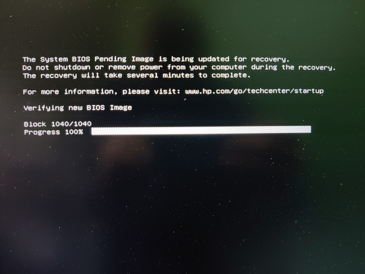

                Bin works. It starts procec recovery and stops as in the photo, after restarting it is the same.

                  Download this https://ftp.ext.hp.com/pub/softpaq/s...0/sp113731.exe run the exe and make a USB recovery drive,boot from it .
                  • siwykk
                    • May 2020
                    • 55
                    • N/A
                    Re: I need bios HP 15-ec2049nw DAG3HJMBAF0
                    Does not boot from USB. The same window all the time. I checked the pendrive on another HP and try recovery, works. What else can we do to bring it to life?

                        I have a similar problem. I got a BIN from a working laptop and the problem persists. Check if it works for you.
                        In BIN you need to enter your s/n: 5CD1234567 and win key: XXXXX-XXXXX-XXXXX-XXXXX-XXXXX
                        In my case, after uploading the BIN, in order for the computer to give the image, you need to restore it in USB recovery (the link above gave SMDFlea to make a pendrive), after this operation the laptop does not turn on properly. It gives a message that the bios is damaged.
                        Let me know how it works for you

                          bios extracted from the HP site update
                          DMI 414000 - 4140FF
                          KEYWIN 436000 - 43603F

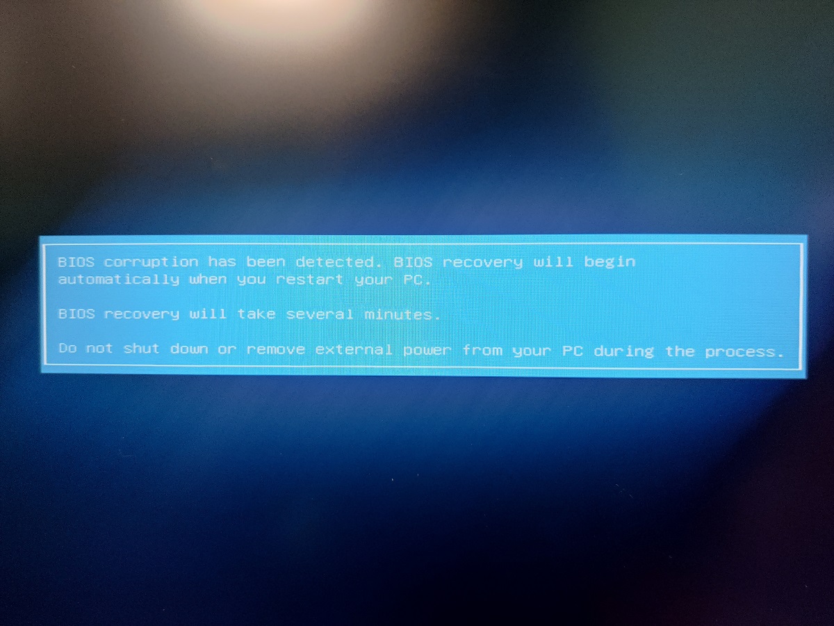

                            Now, after uploading the BIN from the working one, I have a message like in the first photo, after recovery from USB, the message in the second photo and the laptop falls into bootloop recovery.
                            Any ideas?
