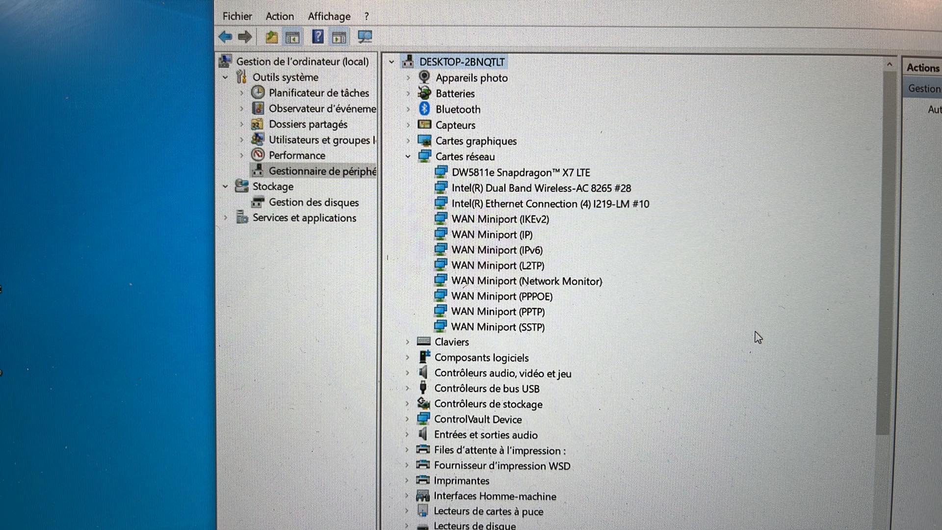

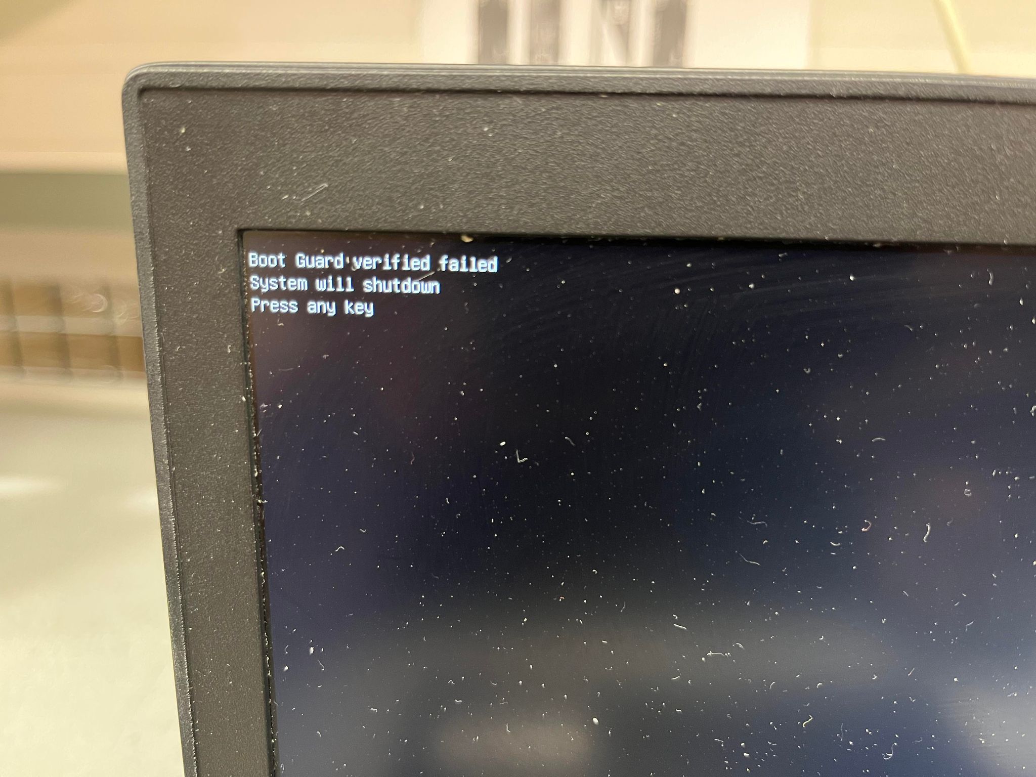

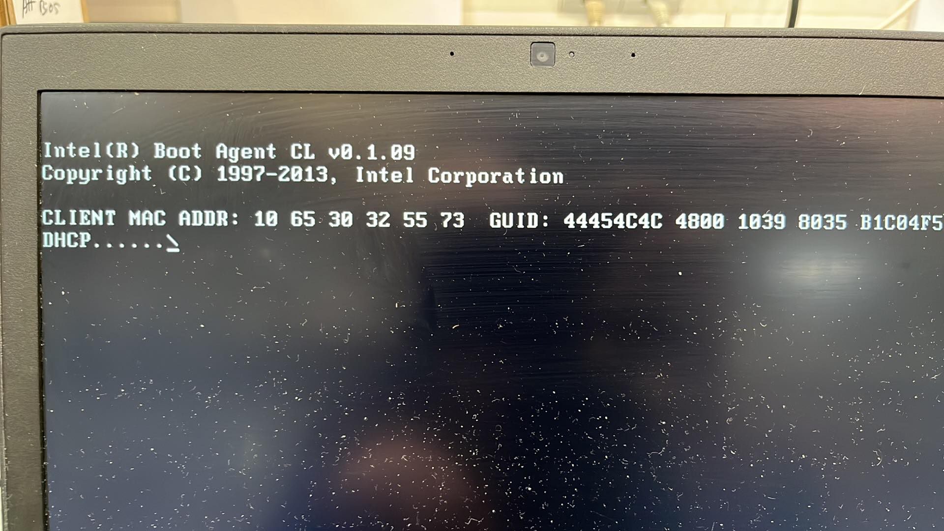

dell latitude 7280 need bios clean me region
  • nabilgo
    • May 2016
    • 300
    • L.A
    dell latitude 7280 need bios clean me region
    dell latitude 7280
    borad numb la-e122p
    any one can deo clean me region
  • hoaca388
    Badcaps
    • Jan 2022
    • 11662
    Re: dell latitude 7280 need bios clean me region
    Originally posted by nabilgo
    dell latitude 7280
    borad numb la-e122p
    any one can deo clean me region
    • mayss
      • Nov 2016
      • 30
      • Polska
      Re: dell latitude 7280 need bios clean me region
      This is your clean bios file. Try and report.
      • warsztat
        • Feb 2017
        • 189
        • Polska
        Dell Latitude 7280 need clear ME
        Hi.
        Dell Latitude 7280, very slow start, need bios with clear ME, i can't find clear ME for my bios (with ME 11.8.79.3722 Corporate LP included).
        I attach the bios ripped from the laptop.
        Regards for all.
        https://www.badcaps.net/forum/attach...1&d=1689179975
        STAG = 6VWJ9H2
        Last edited by warsztat; 07-12-2023, 10:42 AM.
        • piszpunta
          • Jan 2019
          • 249
          • poland
          Re: Dell Latitude 7280 need clear ME
          try this buddy
          Last edited by SMDFlea; 07-12-2023, 12:44 PM. Reason: english translation
          • qayyum786
            • Aug 2018
            • 1933
            • INDIA
            Re: Dell Latitude 7280 need clear ME
            Originally posted by warsztat
            hi.
            Dell latitude 7280, very slow start, need bios with clear me, i can't find clear me for my bios (with me 11.8.79.3722 corporate lp included).
            I attach the bios ripped from the laptop.
            Regards for all.
            https://www.badcaps.net/forum/attach...1&d=1689179975
            stag = 6vwj9h2
            clear
            • warsztat
              • Feb 2017
              • 189
              • Polska
              Re: Dell Latitude 7280 need clear ME
              Originally posted by qayyum786
              clear
              no changes, boot still very slow, I change the memory chip (winbond) but also no changes
              Last edited by warsztat; 07-13-2023, 07:23 AM.
              • Maxpower3
                Bad Veteran
                • Feb 2018
                • 1224
                • France
                Re: dell latitude 7280 need bios clean me region
                Hello everyone
                a 7280 has a corrupt bios, Boot Guard checked the DXE which failed
                Works with other bios but GBE network not working (error code 10)
                https://www.badcaps.net/forum/showpo...69&postcount=2
                ORI BIOS SERIAL 76C3SN2
                • Markus1741
                  • Sep 2020
                  • 843
                  • N/A
                  Re: dell latitude 7280 need bios clean me region
                  Hello everyone
                  a 7280 has a corrupt bios, Boot Guard checked the DXE which failed
                  Works with other bios but GBE network not working (error code 10)
                  https://www.badcaps.net/forum/showpo...69&postcount=2
                  ORI BIOS SERIAL 76C3SN2
                  Try ....
                  • Maxpower3
                    Bad Veteran
                    • Feb 2018
                    • 1224
                    • France
                    Re: dell latitude 7280 need bios clean me region
                    Originally posted by Markus1741
                    Try ....
                    Not work
                    • Markus1741
                      • Sep 2020
                      • 843
                      • N/A
                      Re: dell latitude 7280 need bios clean me region
                      Not work
                      OK try this one ...
                      • Maxpower3
                        Bad Veteran
                        • Feb 2018
                        • 1224
                        • France
                        Re: dell latitude 7280 need bios clean me region
                        Originally posted by Markus1741
                        OK try this one ...
                        OK fine, perfect
                        RJ45 works perfectly but just the serial is not good
                        I changed, it's good
                        Very thanks
                        • Tosebeee
                          • Aug 2023
                          • 10
                          • Nigeria
                          Re: dell latitude 7280 need bios clean me region
                          Originally posted by mayss
                          this is your clean bios file. Try and report.
                          100% working
                          • gizaha
                            Dell Latitude 5580 possible bios corruption
                            by gizaha
                            Dell latitude 5580, motherboard cdp 80 la-e151p
                            3 amber 3 white blinks. Dell website sais it's problem "bios recovery" and suggested solution "recovery image not found"
                            (from here https://www.dell.com/support/manuals...e7a&lang=en-us)
                            I try plugging charger while pressing ctrl+esc, machine turns on, nothing and after 20 seconds it gives 3 amber 3 white blinks again.
                            Since ssd is replaced and had clean install windows, i've...
                            02-13-2024, 07:18 AM
                            DELL Latitude 7280 Notebook 7000 Specification for Upgrade or Repair
                            This specification for the DELL Latitude 7280 Notebook can be useful for upgrading or repairing a laptop that is not working. As a community we are working through our specifications to add valuable data like the 7280 boardview and 7280 schematic. Our users have donated over 1 million documents which are being added to the site. This page will be updated soon with additional information. Alternatively you can request additional help from our users directly on the relevant badcaps forum. Please note that we offer no warranties that any specification, datasheet, or download for DELL Latitude 7280...
                            09-06-2024, 10:50 PM
                            DELL Latitude 7280 Notebook 7000 Specification for Upgrade or Repair
                            This specification for the DELL Latitude 7280 Notebook can be useful for upgrading or repairing a laptop that is not working. As a community we are working through our specifications to add valuable data like the 7280 boardview and 7280 schematic. Our users have donated over 1 million documents which are being added to the site. This page will be updated soon with additional information. Alternatively you can request additional help from our users directly on the relevant badcaps forum. Please note that we offer no warranties that any specification, datasheet, or download for DELL Latitude 7280...
                            09-06-2024, 10:50 PM
                            DELL Latitude 7280 Notebook 7000 Specification for Upgrade or Repair
                            This specification for the DELL Latitude 7280 Notebook can be useful for upgrading or repairing a laptop that is not working. As a community we are working through our specifications to add valuable data like the 7280 boardview and 7280 schematic. Our users have donated over 1 million documents which are being added to the site. This page will be updated soon with additional information. Alternatively you can request additional help from our users directly on the relevant badcaps forum. Please note that we offer no warranties that any specification, datasheet, or download for DELL Latitude 7280...
                            09-06-2024, 10:20 PM
                            DELL Latitude 7280 Notebook 7000 Specification for Upgrade or Repair
                            This specification for the DELL Latitude 7280 Notebook can be useful for upgrading or repairing a laptop that is not working. As a community we are working through our specifications to add valuable data like the 7280 boardview and 7280 schematic. Our users have donated over 1 million documents which are being added to the site. This page will be updated soon with additional information. Alternatively you can request additional help from our users directly on the relevant badcaps forum. Please note that we offer no warranties that any specification, datasheet, or download for DELL Latitude 7280...
                            09-06-2024, 10:20 PM
