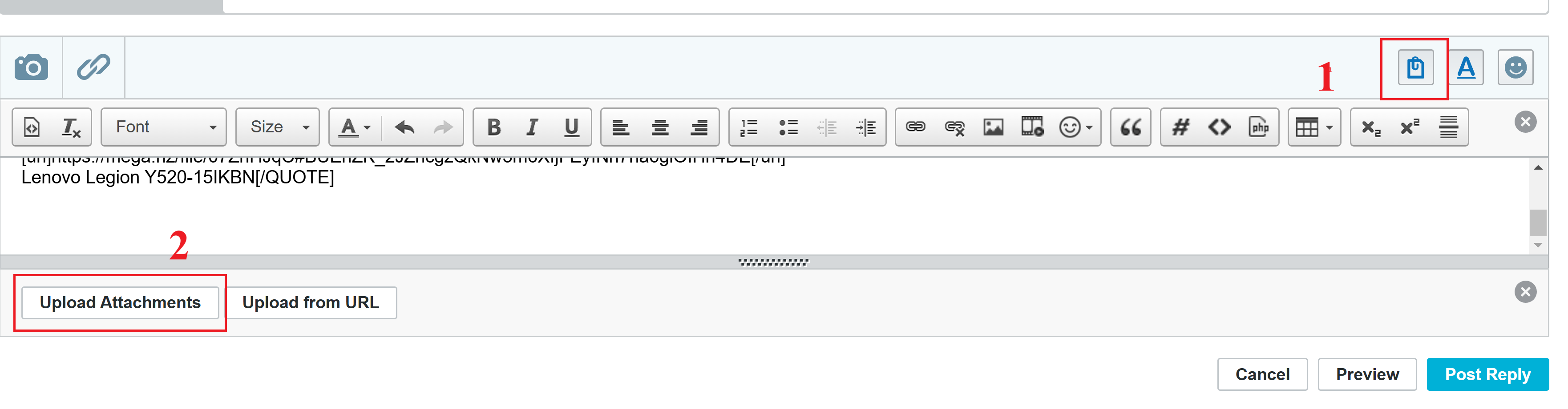

                      Upload the bios file here, do not use external links, use winrar or 7zip to compress it before uploading, remember serial number.
                      Click image for larger version  Name:	2024-11-19 11_20_22-Lenovo Y520 NM-B191 Bios - Badcaps.png Views:	0 Size:	150.8 KB ID:	3510290
