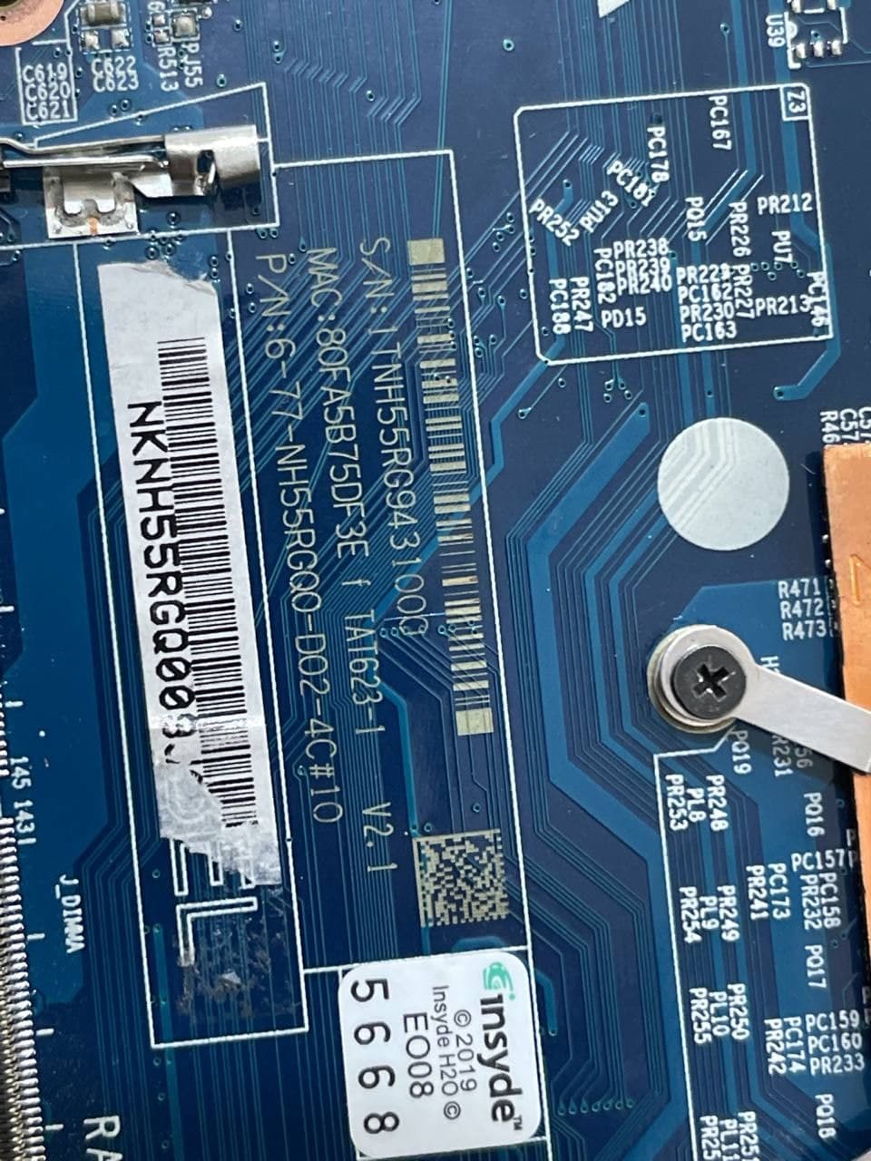

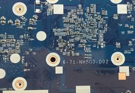

    post the full name and model of the laptop and the original bios.
      • 20781
      Re: 6-71-nh5g0-d02 bios plz
      Probably a Clevo NH55RZQ or NH70RZQ ,or a rebadged clevo

          the bios is not ok ... it is shorter ... and what is written on the case ??? what is the name and model of the laptop ??? what company did it ???

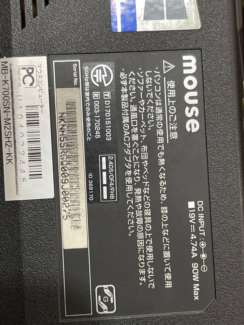

            photo of lable
              • 20781
              Originally posted by ghandisolutionlaptop
              photo of lable
              The bios is available here: http://repo.palkeo.com/clevo-mirror/NHxxRG(Q)/ (The SM service manual/schematic is available as well if you need to troubleshoot further)
              Log in using username: repo password: repo .Download bios version B10708.zip and EC version EC10703.zip .Extract B10708.zip ,the full 16MB bios is NH55RGQ.08 ,rename the .08 to .bin or .rom if you want.
              Your bios backup is only about 10MB so its corrupt or your programmer hasn`t read it properly. Luckily all the DMI info is readable. Copy the DMI info from your backup using the off-sets provided in the attached text file ,and copy it into the NH55RGQ.08 bios.
              If you don`t have a KBC programmer to flash the EC you can flash it from a UEFI shell.
