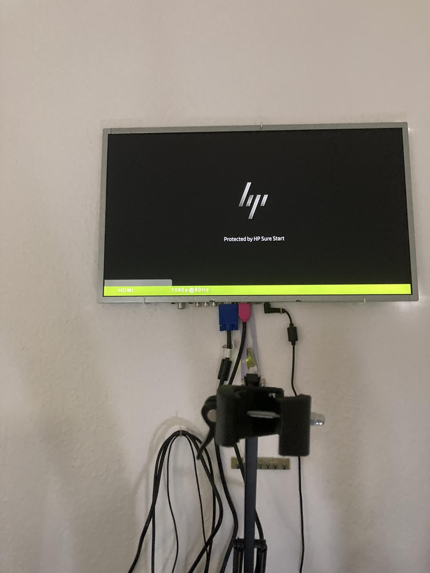

    Re: HP 840 G5 EndPoint Security Controller Problem
    Originally posted by rediii
    well, the error message disappeared!!! i'll lock the mpm and report! wow, very nice so far. what have you done? i tried to unlock the mpm via bcu, but access was denied... thank you for sharing your information :o)
    You used the bios of another machine, so in the 32MB bios file, there is MPM information of that device and it has enabled the "security endpoint". I rebuilt the new 32MB bios file, cleaned the ME region.
    With the 16MB file, I deleted the first NvramActiveRegn region.
    But now you may have trouble with MPM again.
      very interesting, nice. have all the information i need (saved them). i try to lock the mpm via the "new" powershell service from hp, that they released back in june this year. if everything is working fine, i'll report again. thank you very much sir. time to dig deeper. you deleted and overwrite the values with uefi tool, didn't you? i'm happy and good to know. have a nice weekend!
        HxD editor. A free tool.
