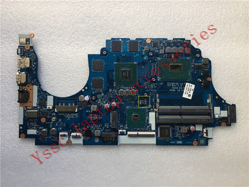

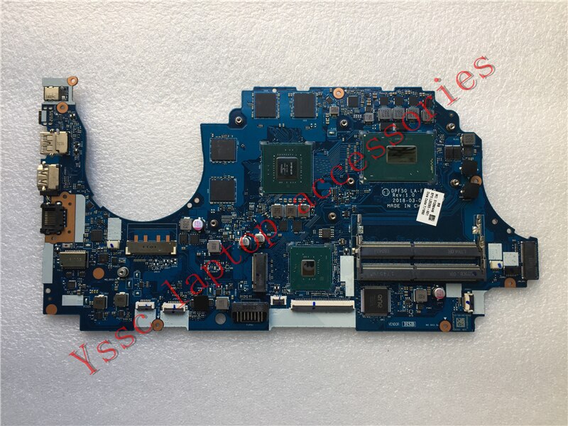

    I nee your help guys i need to locate the Bios IC for my laptop
    Brand: HP Pavilion Gaming Laptop
    Model: 15-cx0139tx
    Board: DPF50 LA-F841P REV:1.0
    and also if you have a working Bin Files for this..
    Note: Those Picture attach are not mine but they are semilar.. thank you in advance..

    read name of chip

      thank you for a quick reply its
      Part Number QH128AHIG
      Manufacturer XMC
      i already remove the chip and i download bios bin on support site...
      but there's error on Verification
      004: The currently selected:XM25QH128A@SOIC8-200, capacity: 128Mbits,
      16Mbytes.
      010: C:\USERS\A-I\DESKTOP\NEW FOLDER\08477.BIN
      011: File has been loaded, checksum: 16bits_0xCEFE £¬32bits_0xCB5DCEFE :
      012: Chip pins contact is detected OK.
      013: Chip ID verification OK.
      014: Start writing chip......
      015: Auto erasing...
      016: Erase successful£¬Elapsed time£º38.29 seconds¡£
      017: Start writing...
      018: Write successful£¬Elapsed time£º57.43 seconds¡£
      019: Auto verifying...
      020: Chip verification error, start position: 0x210000.
      021: Verification failure£¬Elapsed time£º2.764 seconds¡£
      022: Status register1 values: 0x0 ¡£
      023: Write error, operation terminated.
      here some bin from support i have no idea which is bin
