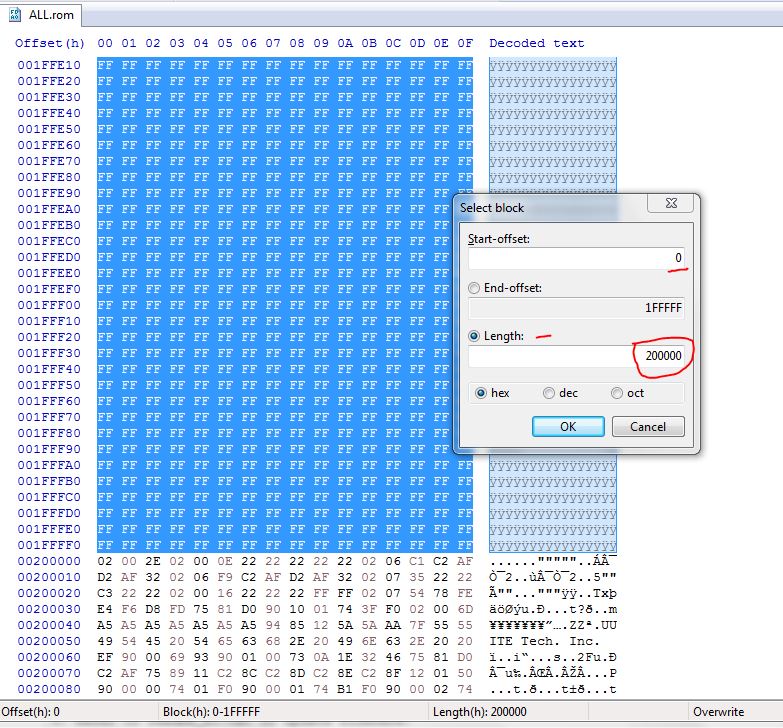

    Hello Together,
    Has anyone a bios dump for Clevo W370SS?
    Board is 6-71-W3S50-D02A.
    Thanks in advance.

      Re: W370SS Clevo EC + Bios DUMP
      Thanks for the reply, but I do need a 2 MB EC dump and a 4 MB Bios dump.
      I cannot extract this from the files at this site.

        Open the ALL.rom with a hex editor,click on "Edit" then "Select Block" enter the start offset as 0 and the length as 200000 (200000 in hex is2MB) ,select "Edit" then "Cut" ,make a new file by clicking on "File" then "New" ,right click inside the new file and select "paste-insert" ,or select "Edit" then "Paste insert".Now the 2MB and 4MB are split,just save them both.
        HxD ,there`s a german version https://mh-nexus.de/en/downloads.php?product=HxD20
          Thanks, done, but no change.
          Guess it is unfixable (
