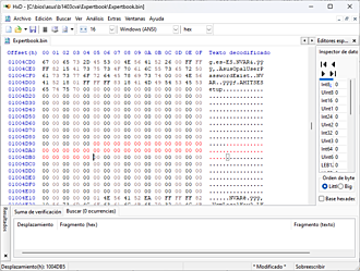

                            HI, I Have an Asus Expertbook with password
                            Model: B1403CVA-S61430
                            S/N T4NXCV13U439178
                            I have tried to unlock the BIOS with this method without results, can someone help me?
                            It has 2 bios chips, I have taken the main one
                            • m1ch43lzm
                              • Mar 2019
                              • 1183
                              • Peru

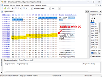

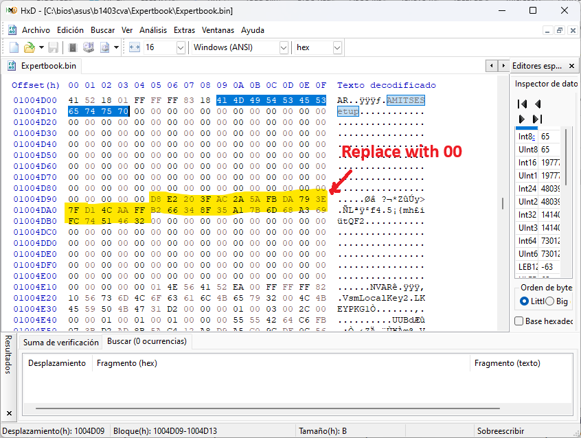

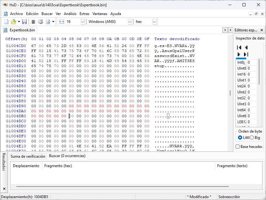

                              #234
                              It's a different type of encryption, search for AMITSESetup with hex editor and just replace the contents with 00 00 ... (hex), that will clear the password
                              Example: From your BIOS, search for AMITSESetup, you may find an entry which only has zeros, search for the next one which has some data
                              Click image for larger version  Name:	amitsesetup replace.png Views:	0 Size:	80.4 KB ID:	3721220
                              Replace with zeros (hex 00), should look like this:
                              Click image for larger version  Name:	amitsesetup clear.png Views:	0 Size:	68.8 KB ID:	3721219
                              Search again for AMITSESetup and repeat the same process until all entries have zeros, there may be a 01 at the end before the next "NVAR" (4E 56 41 52), don't change it
                              Attached your unlocked BIOS
