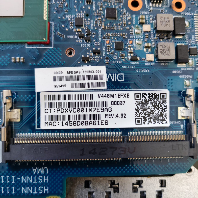

                Here is a photo of the motherboard with all details.
                Sorry for my delay , i've been sick.

                  • 22283
                  Re: HP 850 G1 - Information on 2 chips ?
                  The motherboard will be silkscreened with a long part number like
                  6050A2560201-MB-A03
                    • 22283
                    Try these.These are know good,100% working,if it doesn`t boot the problem is somewhere else
