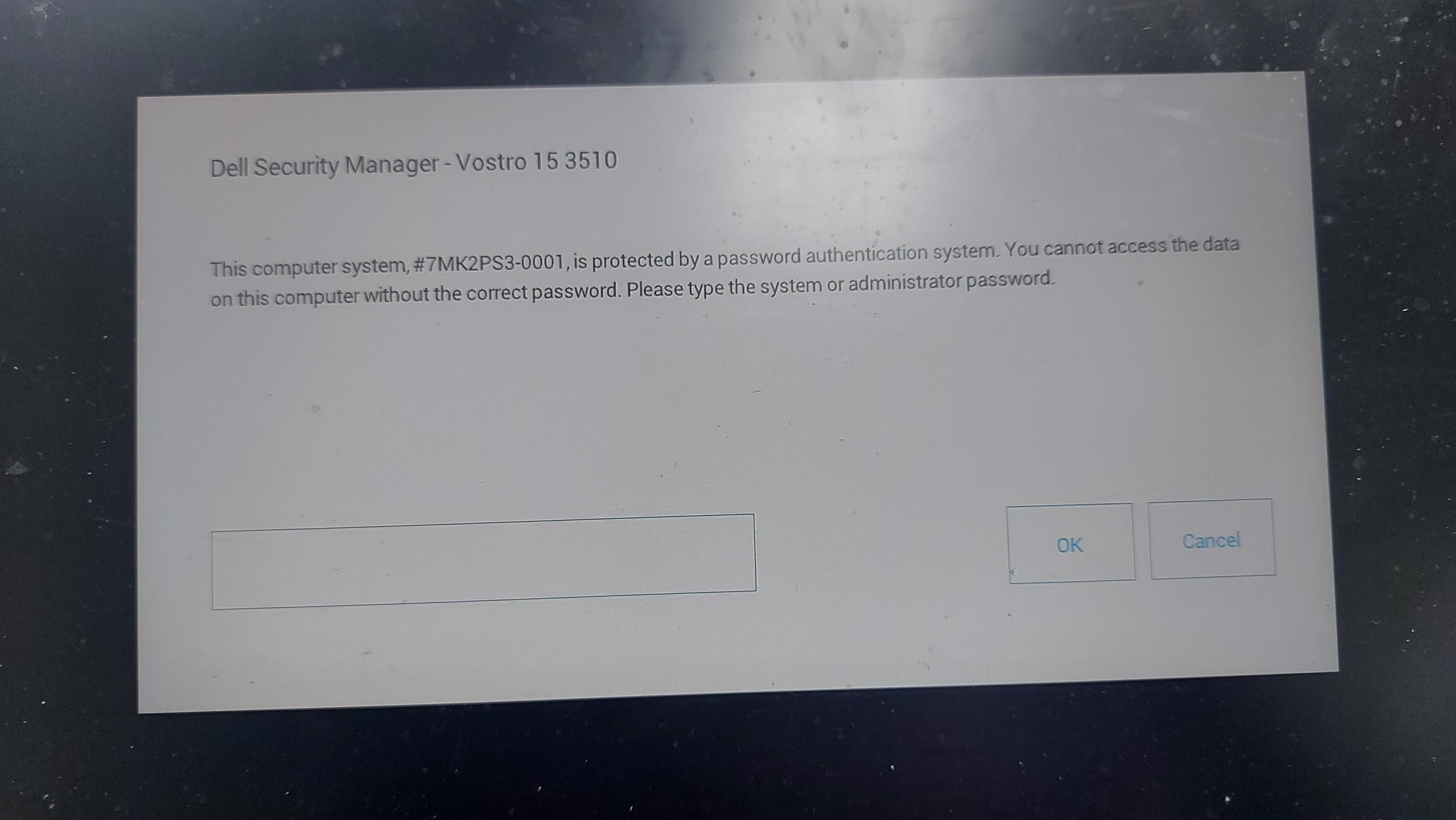

Dell Latitude 3510 with a admin password

    No, post your locked bios file here.

      Re: Dell Latitude 3510 with a admin password
      ok, how do i do that ?
      • hoaca388
        Badcaps
        • Jan 2022
        • 11668
        You need a programmer , the cheapest one is CH341A. Learn to use it carefully.

            Re: Dell latitude 3510 (Mockingbird-L 19746-1) bios needed
            Greetings.
            Can somebody help with unlocking BIOS for Latitude 3510 W/Admin password?
            Attached 8MB and 16MB files
            Thanks.
            • hardware1
              • Sep 2021
              • 2930
              • N/A
              Originally posted by dxCLZ
              Greetings.
              Thanks.
              Here's your Unlocked file. Program this file to your 8MB chip and put your 16MB chip back.
                  Sorry I just got back to you. Unfortunately the file did not work, no video and fan spun up as if it was corrupted
                  • hardware1
                    • Sep 2021
                    • 2930
                    • N/A
                    #29
                    Program back your original file and see if the device is working or not.

                        #31
                        Originally posted by charlie0816
                        Dell Latitude 3510 admin password
                        need sone help remove password TIA.
                        8FC8
                        i attached 2 bios backup
                        Try only lower .
                        1st boot press F2 and write service tag, disable Absolute, save, restart, 2nd boot press alt+L to exit manufacturing mode.
                            Hi guys I have Dell vostro 3510 LA-L246P with bios password I have attached both bios files
                            • hardware1
                              • Sep 2021
                              • 2930
                              • N/A
                              #34
                              Here's your Unlocked Bios, program that file to your 8MB chip and put your 16MB chip back.
