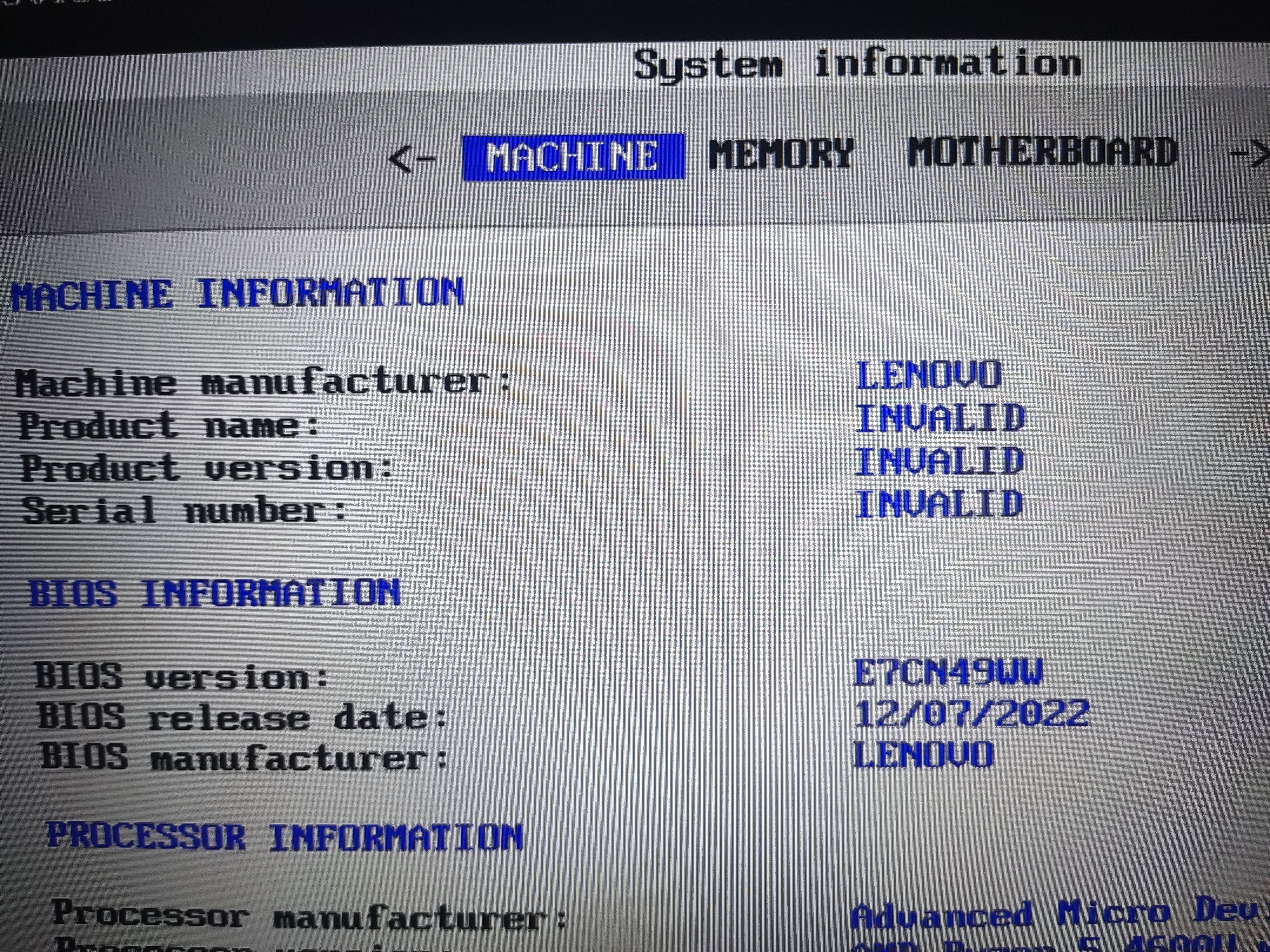

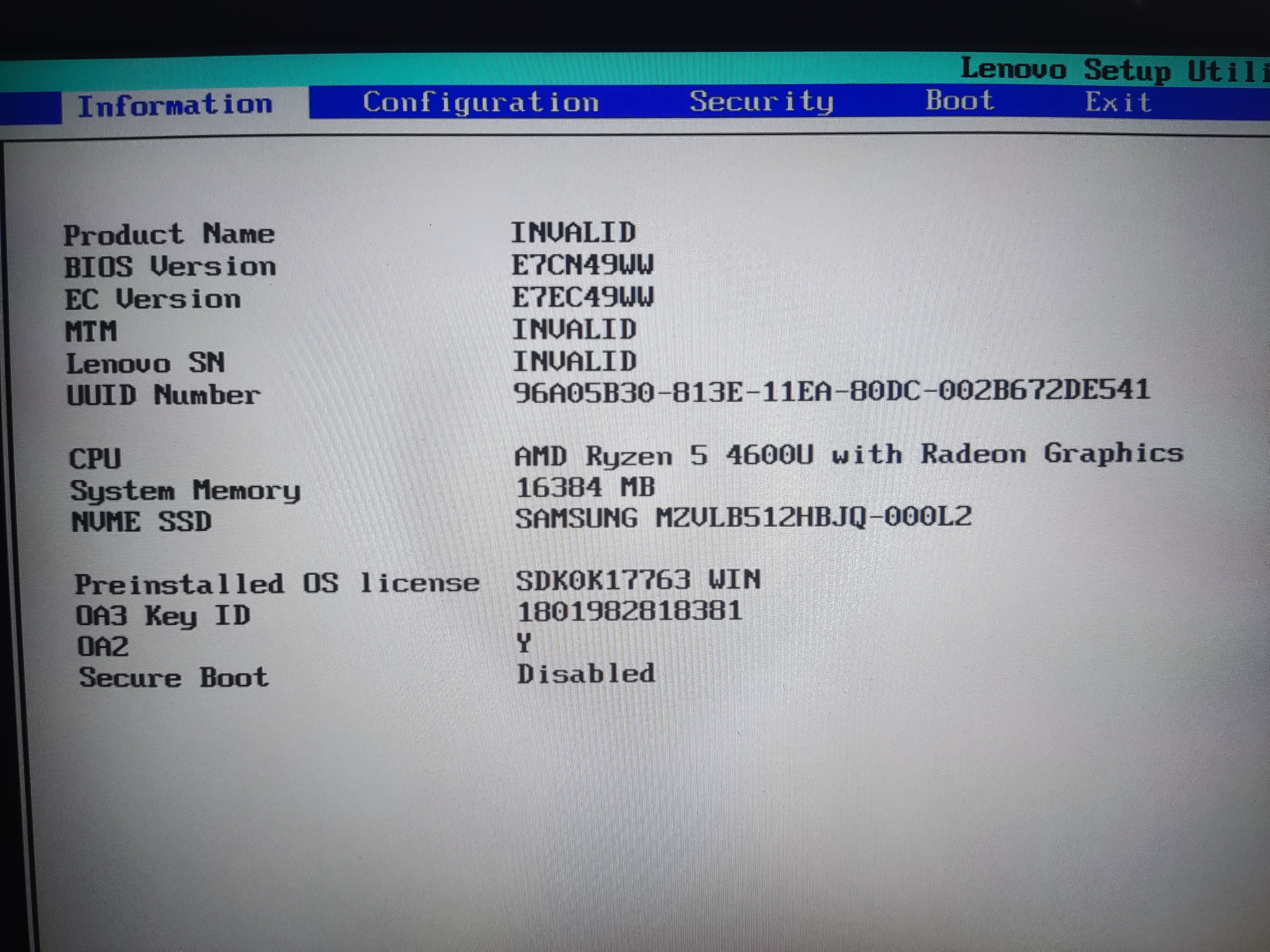

            #66
            I have had to buy a new motherboard.
            SN, MTM etc. is now Invalid.
            Can you please write SN etc. on the new firmware?
            Attached is the backup from the old MB and from the new one.
            Thank you
            SN: PF2A5B49 (old MB) From the new one is unknown
            IdeaPad 5 - 15ARE05​

              #67
              Thank you
              IdeaPad 5 - 15ARE05
              at post #6 you have the DMI range that you need to transfer from one bios to another...do it yourself...
              the bios from post # 6 is virgin, use the HxD program (it's free on the internet), enter both bios into the program (your laptop and the virgin one),
              select that interval mentioned in both bios, copy the interval in your bios and pass it to the virgin bios (copy - paste)....and that's it...​
