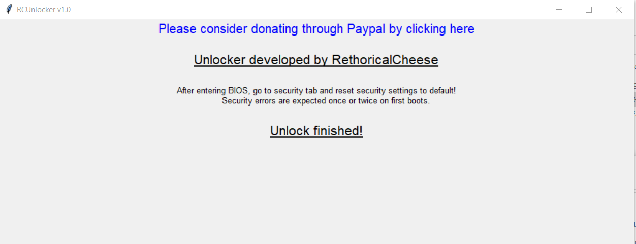

    Hello all,
    I've now got a HP 850 G6 that has a bios password.
    I've flashed the 256 chip, boots up "Bios update in progress" then password remains
    Removed and flashed the 128 Chip, says AMT disabling and reboots and password remains.
    I'm using the HPUnlocker tool.. ( I know it says unsupported, but Gave it a go as cannot get RC to work. )
    Do I need to flash them both at the same time and then boot? or am i using the wrong tool.
    Attached dumps.

      Thanks Lap,
      I've been reading from Peste & Rehtorical that you need to program both the 16 and 32mb
      • BishopCaps
        • Jun 2021
        • 23
        • United Kingdom
        Re: HP Elitebook 850 G6 BIOS UNLOCK
        Sorted - Programmed 16MB with RCUnlocker.

                  Originally posted by skazide
                  plz need to unlock this bios
                  There must be the second bios chip, find it and upload the dump from it here.
                      thanks for reply , this is it
                      Flash 16MB chip only, leave the 32MB chip as is.
                                Originally posted by hoaca388
                                thanks work fine

                                  I type RCUnlocker.exe original.bin and it says "Wrong Chip! Try reading and unlocking 16MB Chip."
                                    • 20299
                                    Re: RCUnlocker
                                    Originally posted by szuts
                                    I must be doing something wrong:
                                    Read your private messages,i moved your previous posts to another thread. There is another 16MB chip on the motherboard,thats the one that needs unlocking,hence the error message from RCUnlocker
