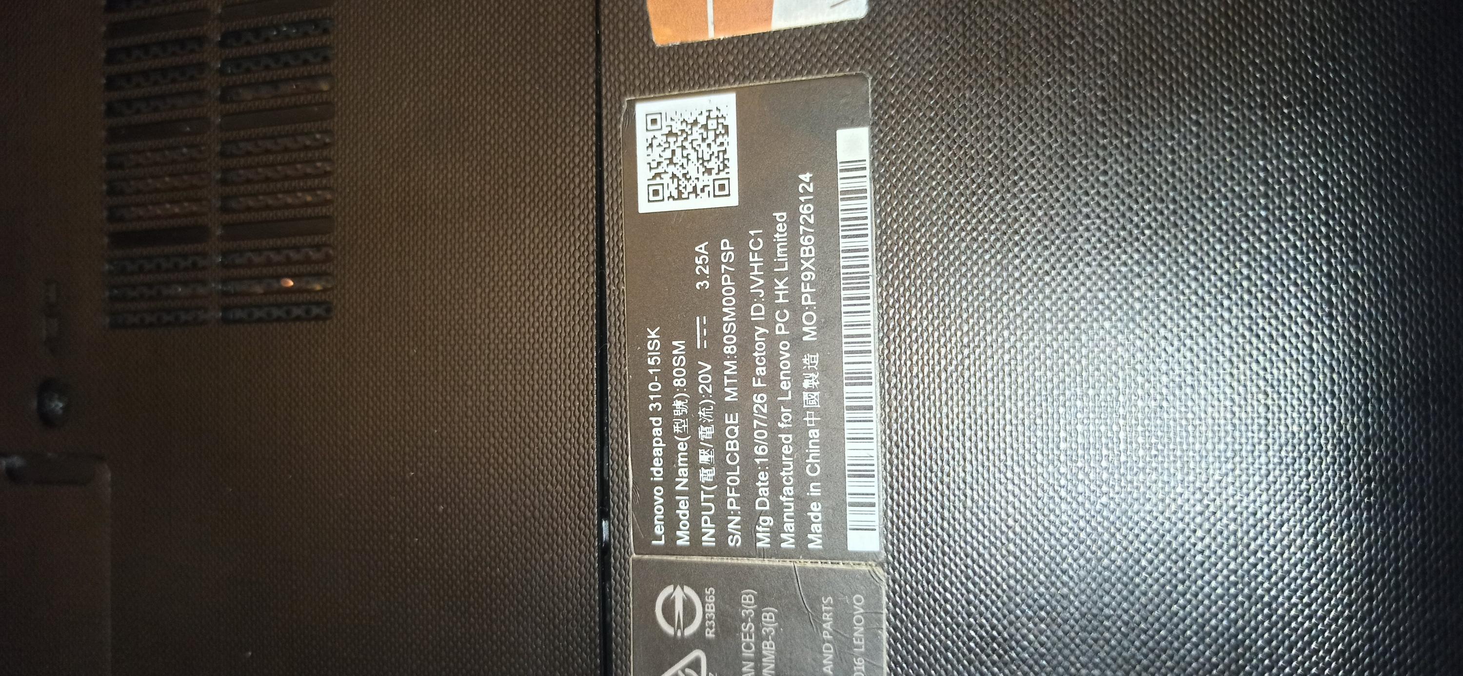

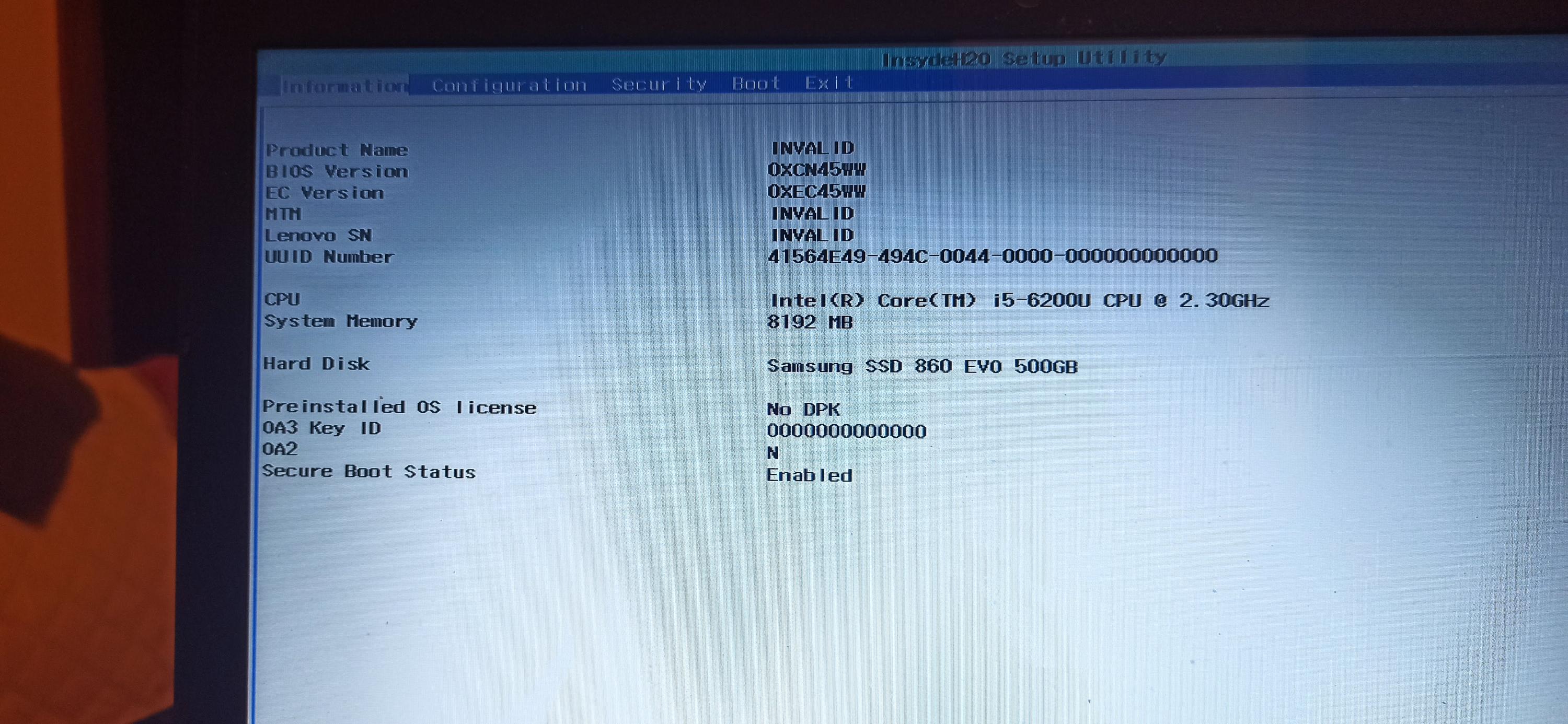

    Hello.
    I have a Lenovo Ideapad 310-15isk, with corrupted BIOS.
    I have used CH341a programmer to make a backup.
    I have installed from this forum a BIOS dump, but now I don't have the product, s/n...
    I am not able to extract that data from my backup with the HxD program nor with UEFITOOLS.
    How can I recover it?, I need help

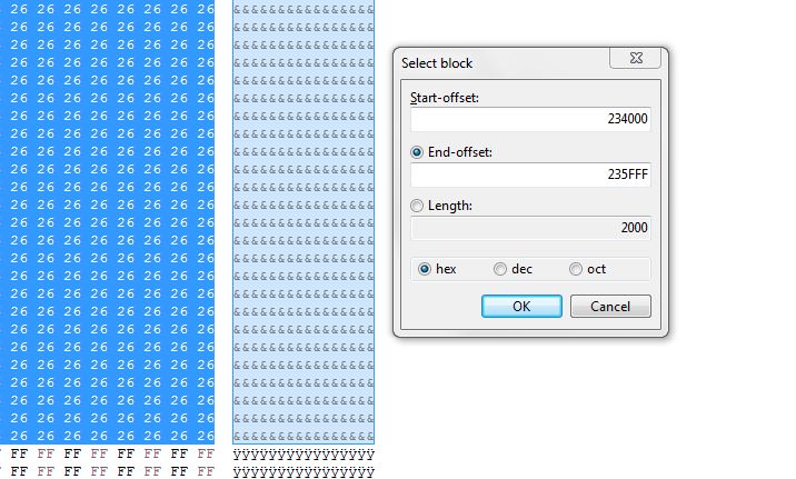

    Using HxD search for the text: LENV .The DMI is crypted,there`s 2 LENV areas to copy,use the offsets in the picture, copy from your backup and paste-insert into the same offsets in the new bios.

      It took me several attempts, but in the end by copying offset 234000 to 235FFF, I did it!
      Thanks a lot SMDFlea
