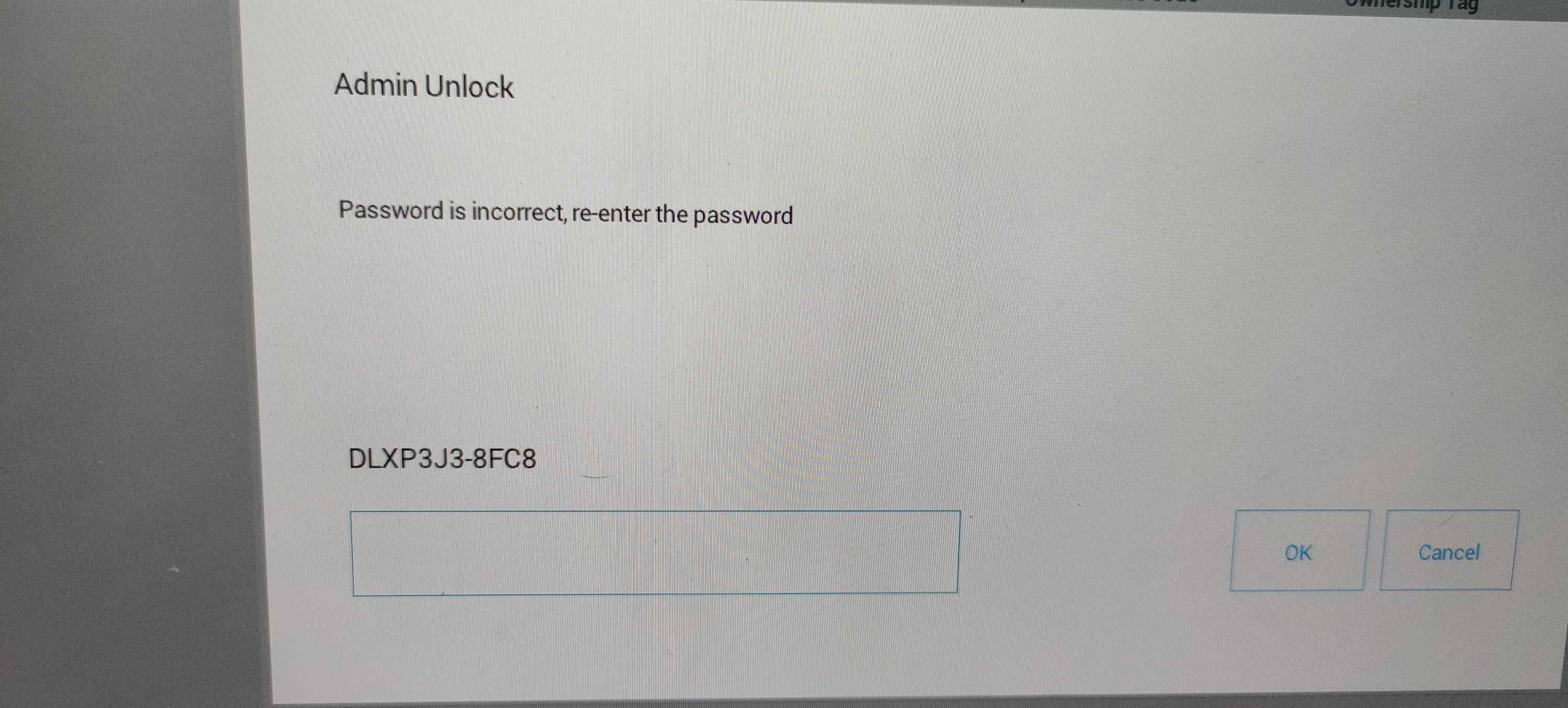

            #125
            Re: help me dell 7320-7420 PASS
            Hi guys
            I got a Latitude 7320 from a friend who works for a recycling company. Some broken edges but electronics seem intact. I would like to bring this laptop to life, but there is a bios password so i need your help.
            Anyone can help? I am posting the dump i read with CH341A NeoProgrammer V2.2.0.10
            Thank you
            Service Tag ending 8FC8
            • hardware1
              • Sep 2021
              • 2894
              • N/A
              #126
              Originally posted by trimi
              Hi guys
              Thank you
              Here's your Unlocked file, hope it works fine.
              all donations are welcome,

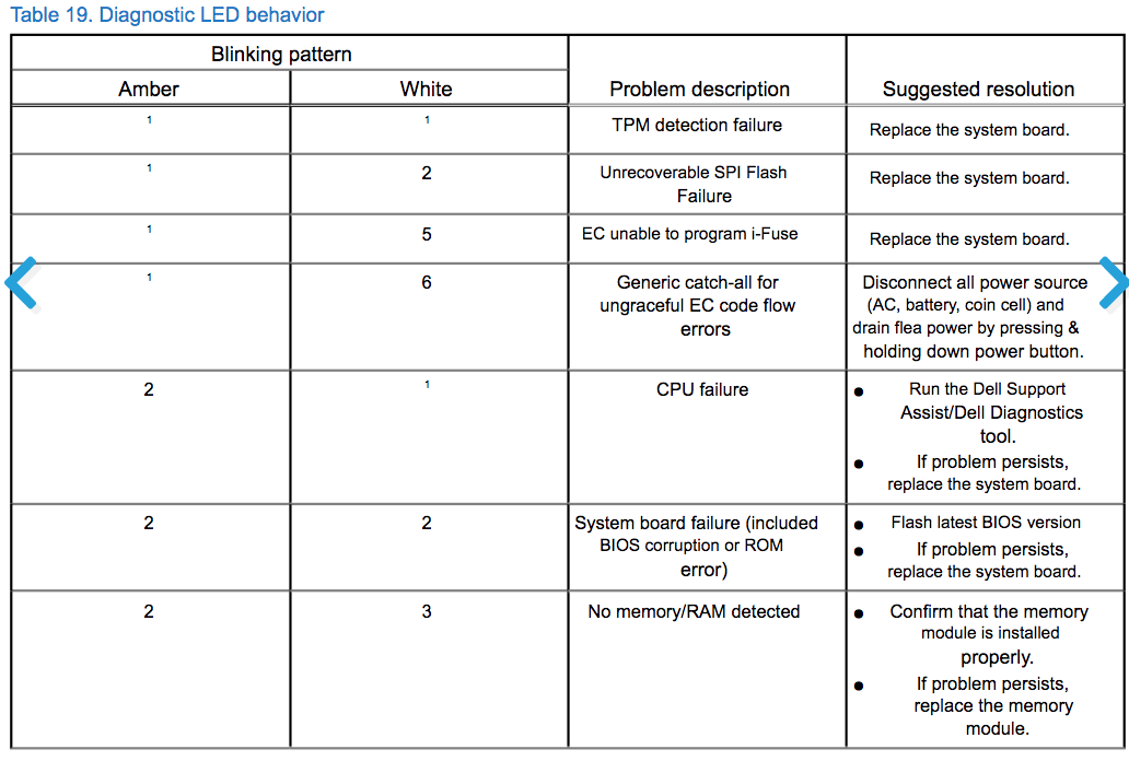

                            • Seb4sch4n
                              • Feb 2022
                              • 3
                              • Argentina
                              #134
                              Originally posted by hoaca388
                              Here
                              Hi. I have a big problem. I recently took this laptop to a friend to try to remove the code. However, today he returned it to me like this (see photo)
                              Does anyone know what the problem is and where should I start?
                              • Seb4sch4n
                                • Feb 2022
                                • 3
                                • Argentina
                                #135
                                Dell latitude 7420
                                • volinakis
                                  • Jan 2021
                                  • 2621
                                  • N/A
                                  #136
                                  Dell latitude 7420
                                  is led blinking? how many times?
                                  • marc_ytos
                                    • Apr 2020
                                    • 140
                                    • cdmx
                                    #137
                                    excuse me now it only turns on and off if you give video can you please help me
                                    • volinakis
                                      • Jan 2021
                                      • 2621
                                      • N/A
                                      #138
                                      here you have blinking pattern. I don't understand from your message, you did the unlocking or your friend? If you did it, post the dump of your bios, or ask your friend to give the dump if he did it. Also post a picture of the bios, it seems that bios wasn't solder properly.
