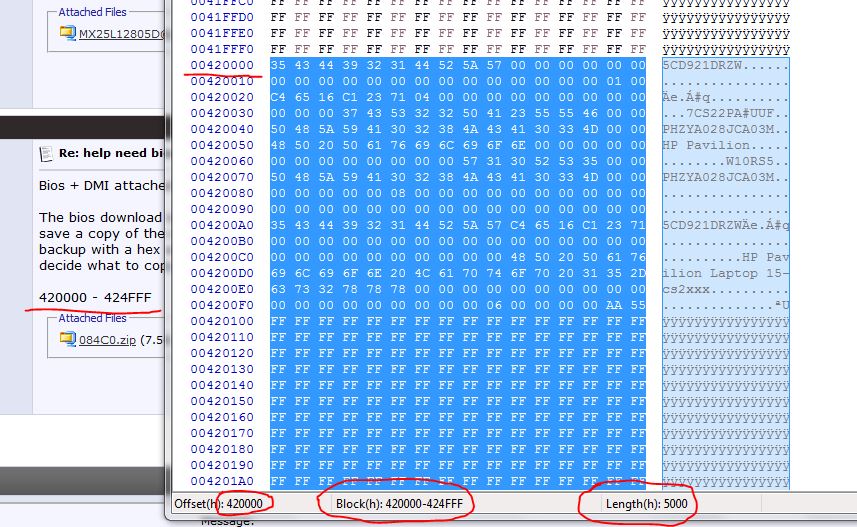

    DAG7BMB48C0 REV:C
    problem no power
    note: l'm the second tech to repair this laptop I don't know if the bios backup is the original
    bios backup file
    • 22284
    Re: help need bios file hp pavilion 15-cs2081TX
    Bios + DMI attached.
    The bios download is here from the 15-cs2081TX support page: https://ftp.hp.com/pub/softpaq/sp135...0/sp135625.exe .When you run the exe it gives you the option to save a copy of the new bios.In this exe there are 2 bios for different models, 1 is only 8MB the other is 16MB. The 16MB one is naned 084C0.bin .If you search through your backup with a hex editor using the text search for 084C0 youll see its the same bios . Do a text search again for the serial number,you`ll see the start of the DMI block and then you can decide what offsets to use and copy the DMI from your backup to the virgin bios. The DMI block offset to copy is
    420000 - 424FFF
      420000 - 424FFF
      Thank you
